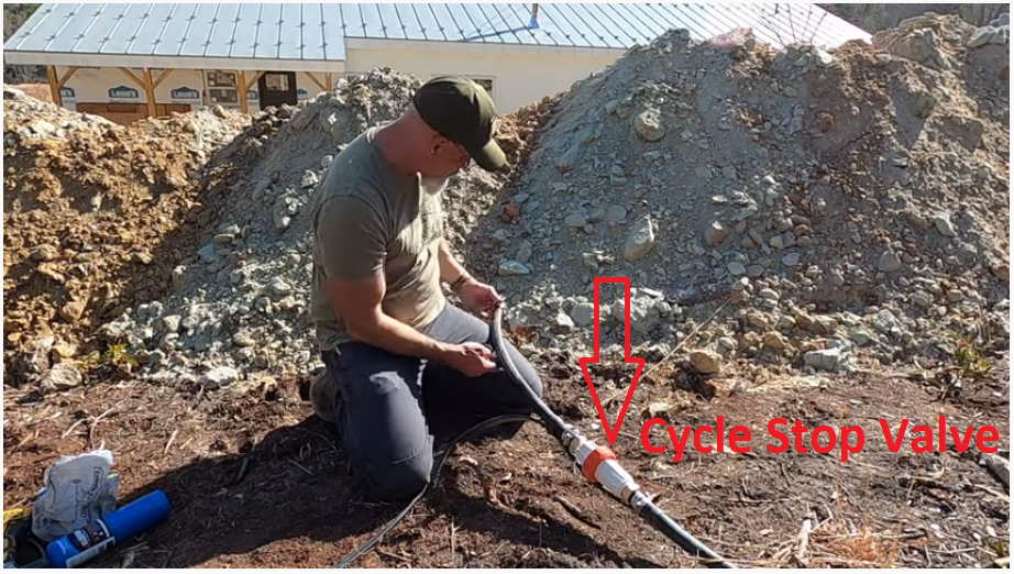

New video this morning. Installing the submersible pump.
Gonna be shocking the well today after I chase down the leaks.
   / My Industrial Cabin Build #3,214
Is there a reason you don't use a cordless impact driver to really tighten down the stainless clamps on the water connections? It is more torque, easier than a screwdriver.
   / My Industrial Cabin Build #3,215
Can't feel the tightness. Very easy to strip them with a cordless driver unless you have a really powerless driver. :)

Nice job, did you use 2 or three torque arrestors? I see you have one just below the cycle stop is there another in the middle at 100'? Usually you don't need one close to the top with casing there is not much torque or movement at the top and no issue with rubbing against stone/well walls.
On the clamps, the Ideal brand SST HD clamps are what I use on the pump/pipe and heating the pipe molds it around the fitting grooves are what mostly hold the pipe, the clamp just needs to be tight but not over torqued.
   / My Industrial Cabin Build #3,219
Glad to see the in well Cycle Stop Valve:
   / My Industrial Cabin Build #3,220
What;s the benefit of the in well Cycle Stop Valve as opposed to being installed at the tank?
