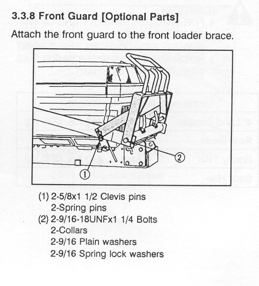

After looking at different LA350 grill guards, I will now say that I don't know if there is a "standard" grill guard; at least I have never seen two alike yet.
Attached is a picture from the LA350 manual of how to install the optional grill guard.
Notice that, in addition to protecting the front grill, it is designed to protect the front corner of the hood. The grill guard is designed to fold forward allowing the hood to be raised. Even though this grill guard doesn't look the same as mine, it is a similiar design. I will post my pictures next.
Kelvin

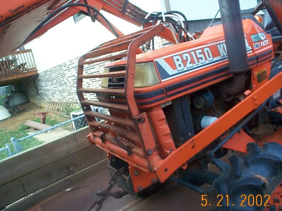

Attached is a photo of one corner of the B2150's LA350 FEL grill guard.
Kelvin

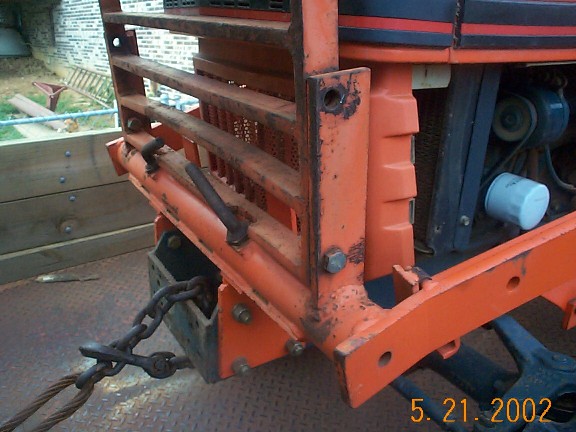

   / My Kubota B2150 #47
Attached is a "close up" photo of one corner of the B2150's LA350 FEL grill guard.
Kelvin

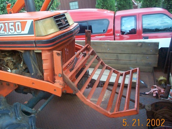

   / My Kubota B2150 #48
And here is a picture of my B2150's LA350 grill guard in the folded down position.
Kelvin

   / My Kubota B2150 #49
Kelvin,
I think your grill guard is not a factory piece. I did notice on my LA350 frame that there are tapped holes near the front and a regular hole about 6"-8" back. I figured this was for the grill guard. Looking at your scan of the manual, I confirmed this. This all will help a lot!!
John
   / My Kubota B2150 #50
John,
I'll agree with you that my grill guard is probably not a Kubota original, unless Kubota made more than one kind of grill guard (which I doubt, but who knows?).
Kelvin
