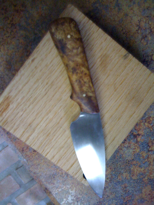

Nice knife! Here's a Damascus blade that I made for a friend. The handle is not carved it just looks that way. Spalted Big Leaf Oregon Maple.
LOL, your photo is so sharp that I could 'lift' your fingerprints.

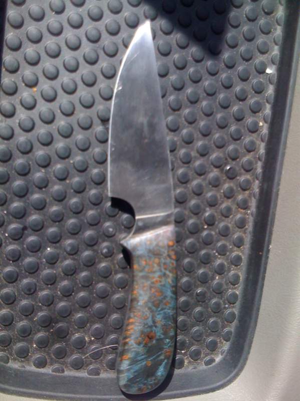

No, I cheated and bought some Damascus steel. There are tractors to play with after all, and you have to have priorities!
   / My Latest Knife #24
It's still beautiful, and alot of craftsmanship there! I'm not sure I'm ready to attempt forge welding my own yet either! I may cheat too, and start with an easier cable welded blade. It's bad enough when you put hrs into a regular blade only to mess something up on it, I can't imagine the new words I'd make up if I screwed up a nice Damascus one! Lol
