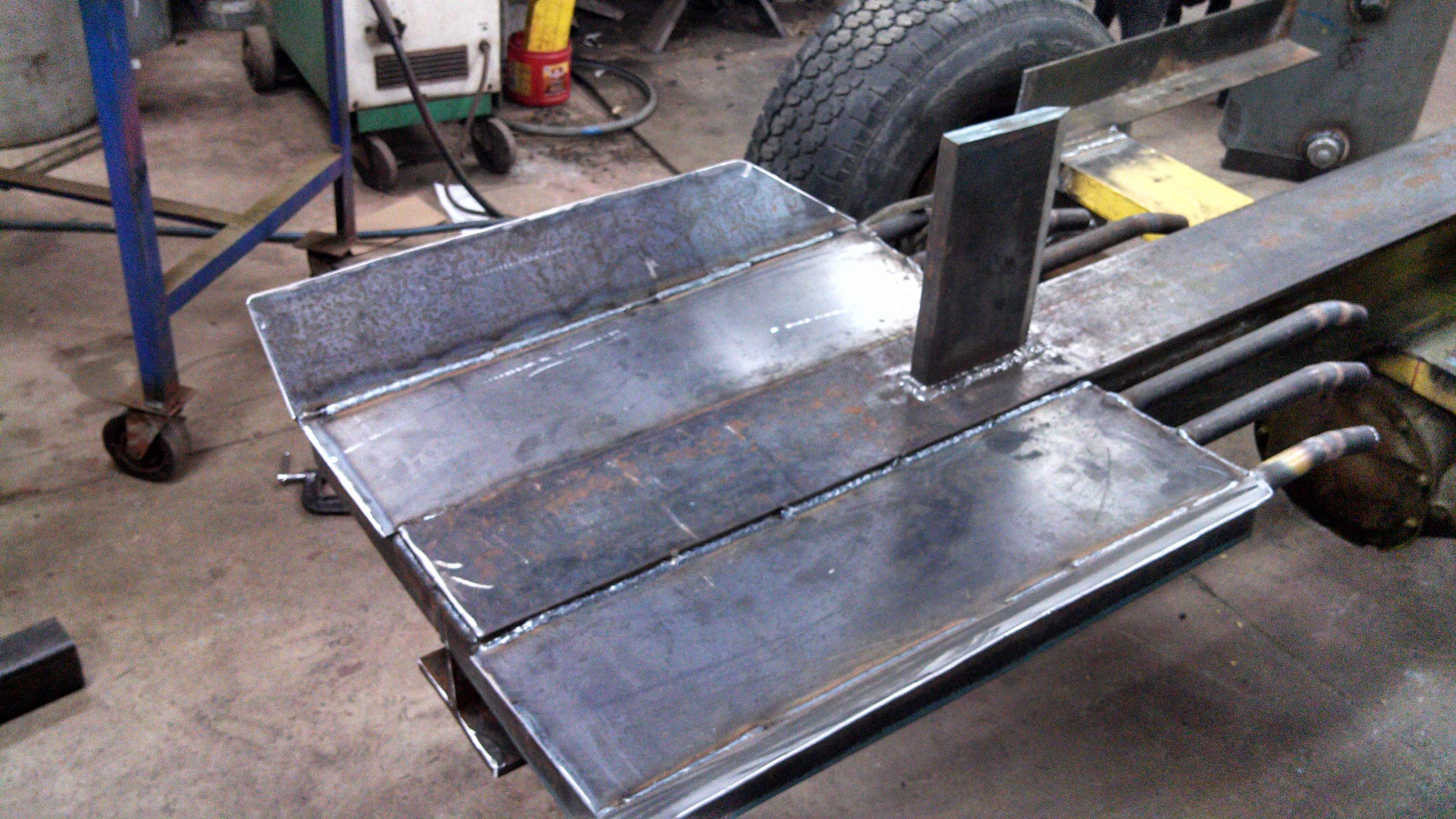

Well, I got to actually test it out on some wood that actually needed split.
I had a pine top to cut up that was about 18" diameter at the big end. And a ~12" willow top.
Not really a test of strength for the splitter, but a good speed and functionality test. And I couldnt be happier with how things turned out. I really can say that there is anything I wished I did different.
I do like the thin wedge as is without adding angle iron or anything. Because alot of what I do split is pine and willow. And with the soft and sometimes half rotten wood, if you try to spread it too soon, it ends up not splitting all the way through and just busting a chunk out of the side. Especially on the pine where the piece had a small limb or two coming off of it in the middle. With the thin wedge, I didnt have any issues with that like I sometimes do with the other splitter.
Now I cant wait to cut some real wood and give it a workout.:thumbsup:

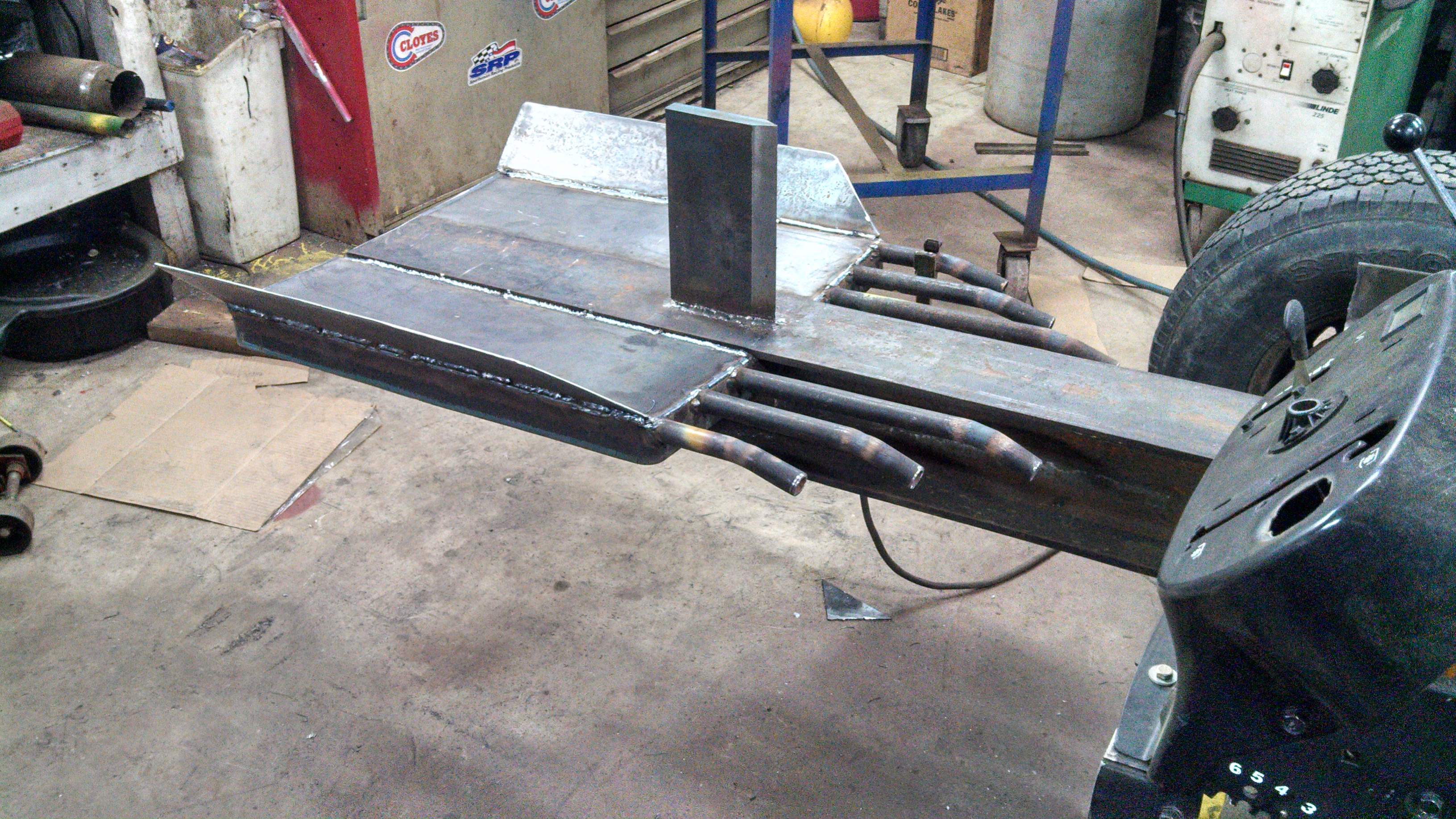

I stood on a chair so I could get an overhead shot to better show the room to work. The pipes and framework for the "table" only stand out from the beam 8". So plenty of room. I stood there and "pretended" to be splitting wood before I located the valve and the table. The locations of them now were most ergonomic for me.
I don't mean to be too critical here but looks to me like those pieces round stock are just going to be in the way. You need to be able to reach the beam from either side and still reach the control lever. Just my opinion.
/ My LOGSPLITTER Build
#85
I can split from both sides and reach the control lever perfectly. They are not in the way at all. I have split about 4 cord with it now and so far there is nothing that I would change.
