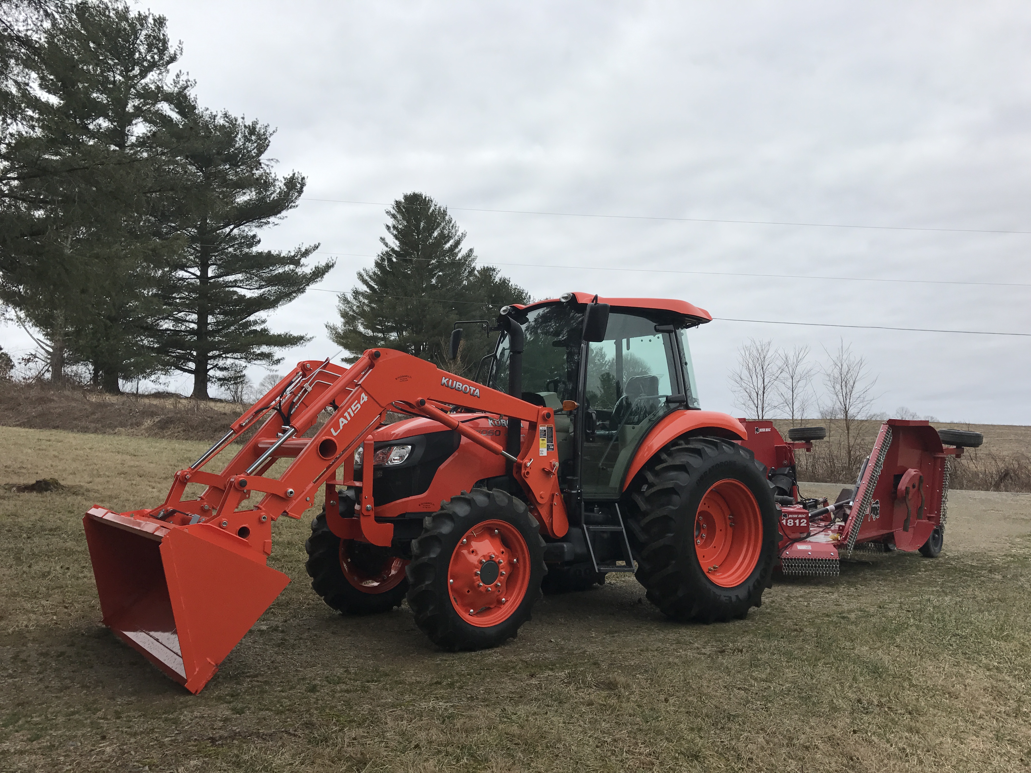

I'm wanting to understand better the difference you have or expect to have between the "3rd function" on the loader and use of your remotes as hydraulic flow source for the front Lane Shark. My MF2660 may not be a good reference but it is what I have. My 4-in-1 bucket pinch function is run from one of my remotes. That same set of lines was used when I had a FEL-mounted very heavy brush cutter. I think I said before that when I moved my loader (curl or loader frame under force, not gravity) that stops the cutter motor very suddenly and then a very sudden hard runup to full speed again after I stopped moving the loader controls. Besides being awkward and uncomfortable I felt it would eventually result in damage. The hydraulic line pair with connectors mounted on my loader near the bucket was always referred to as the 3rd function so far as I know. Is there some other meaning ? Is there some magic by which the flow taken off the loader (rather than off a remote) changes the "one track mind" hydraulics? I don't see how it would unless there is a flow diverter valve built into your 3rd function flow source. I had heard that some larger Kubotas had factory options for complex hydraulic valving (?) By the way, my remotes seem to have a pretty large and direct return line to the sump.

I had the same questions as you when talking to the manufacturer since I was wanting to run the LS with the 3rd function. He explained that while it will work, it is far from ideal and will result in premature motor failure since the 3rd function is basically a full on or full off valve. This is great for driving cylinders but not for driving hyd motors that have mass to drive up to speed. The same mass needs to disapate it's energy by spinning down freely instead of the motor abruptly trying to stop it. By using one line from a rear remote you can "ease into it" to spin the cutter up and then it can freewheel down by the return going directly into the sump. He did a good job of explaining it where I could understand, he says they have spend a lot of time working with the setup and this is the best way to go.

I'm still puzzled. Whatever valve drives the front cutter needs to run continuously or at least allow you to "set it and forget it" so it is running continuously. With an open center system, when you raise the loader frame or curl the bucket mount, that will cut off flow to any other devices such as remotes suddenly. Then when you stop curling or raising the frame (by using the loader valve, not the valve driving the cutter) the flow suddenly returns to the cutter. Your dealer no doubt knows what he is doing but I do not see how you get around that situation.

The only thing that will cut flow off to a "set" remote would be if the pressure dropped enough to divert all the flow away from the open valve. I could see that happening if you were to get crazy with loader movements but you would not in operation of the cutter. normal slow movements won't rob enough flow rate to stop the cutter in normal situations. I don't foresee whipping the loader up and down while the cutter in engaged in heavy cutting. Look at this video of a tractor with a much lower flow rate than mine with the cutter operating while the loader is being operated.Lane Shark USA - YouTube
