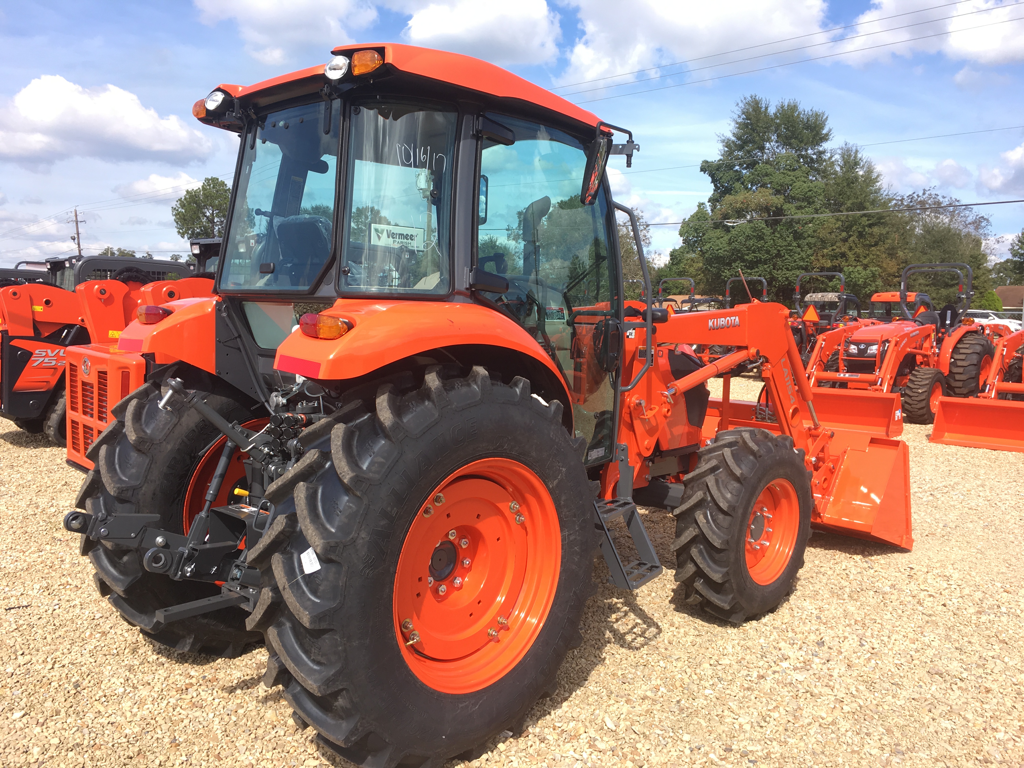

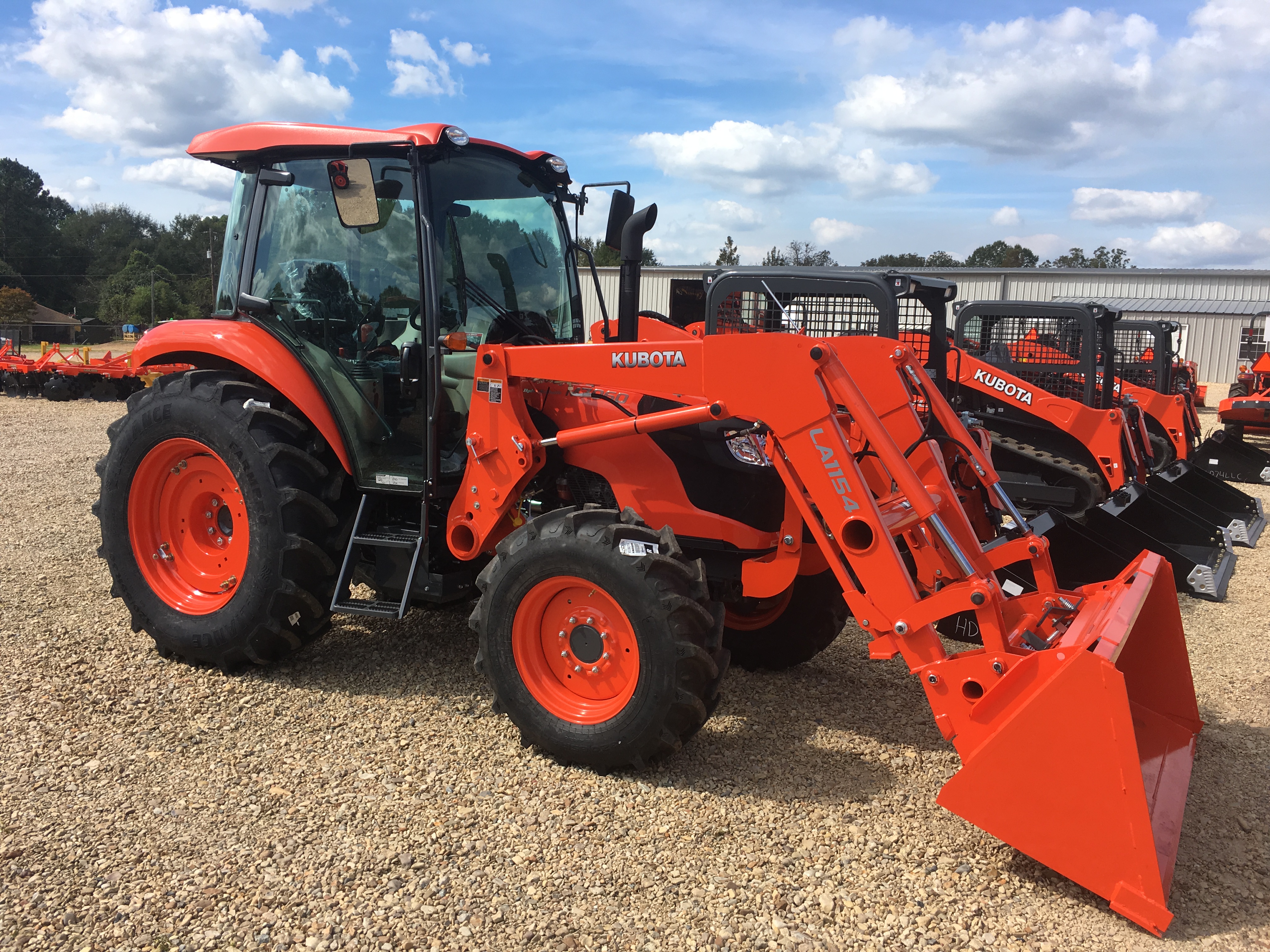

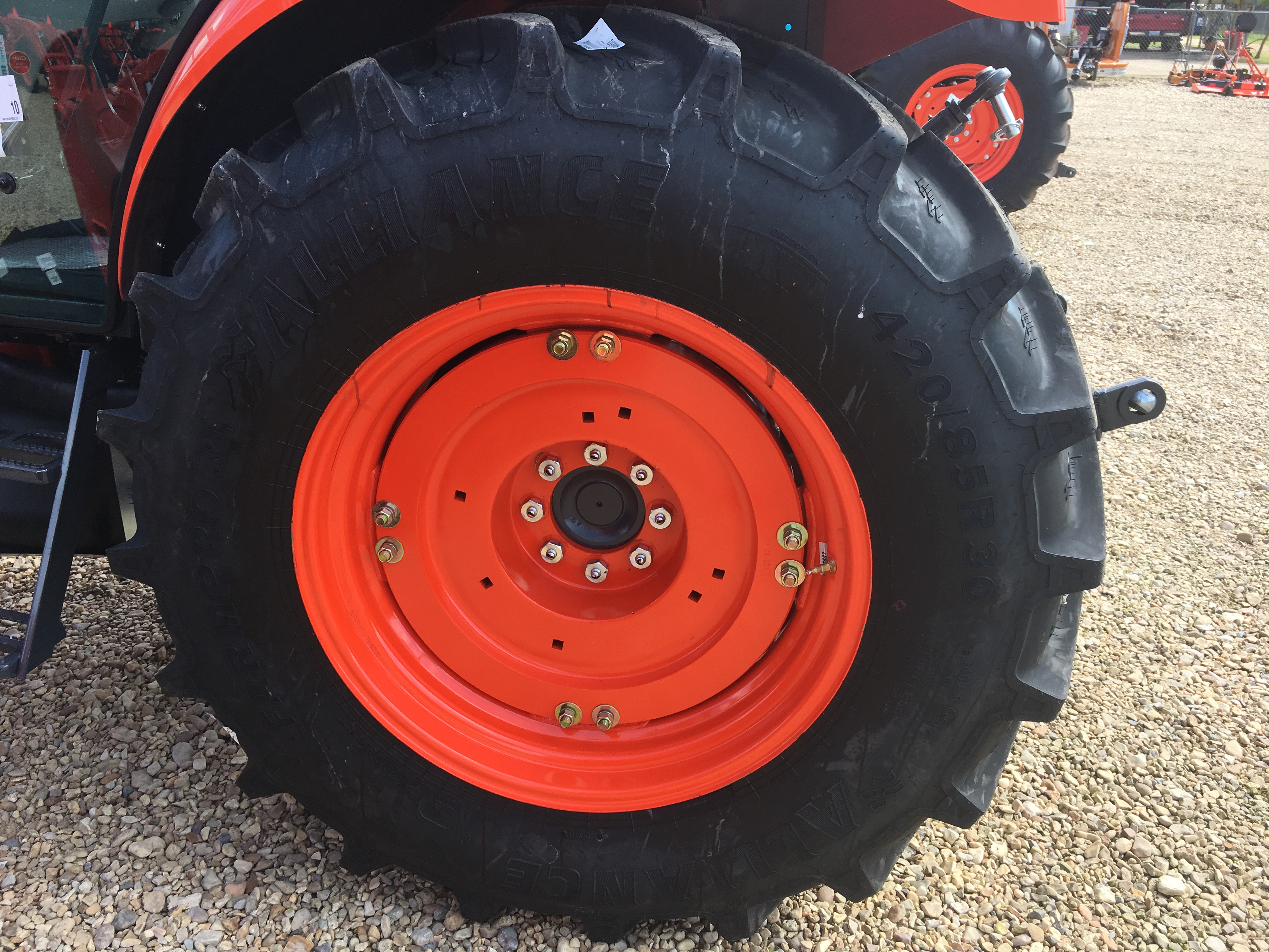

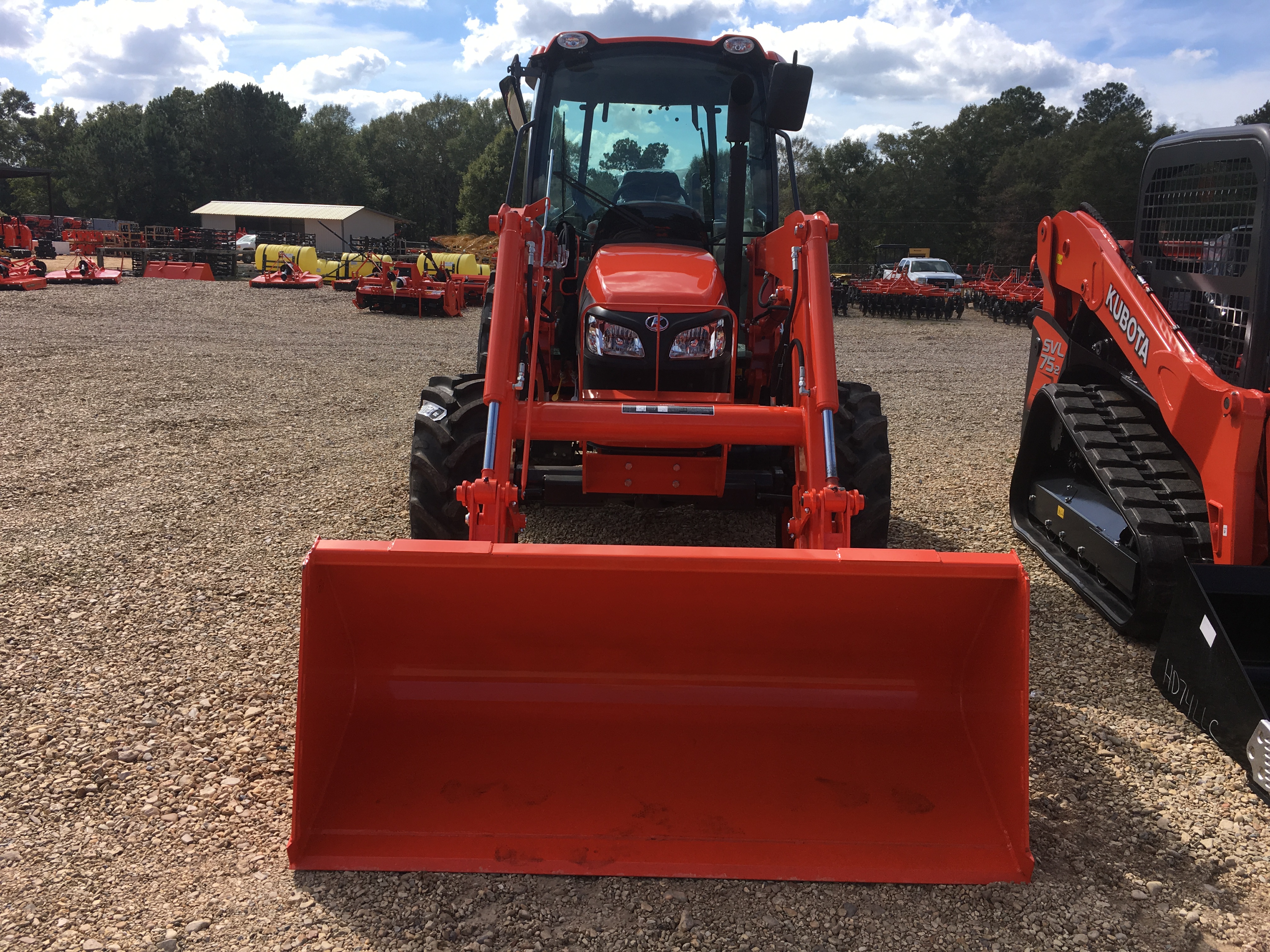

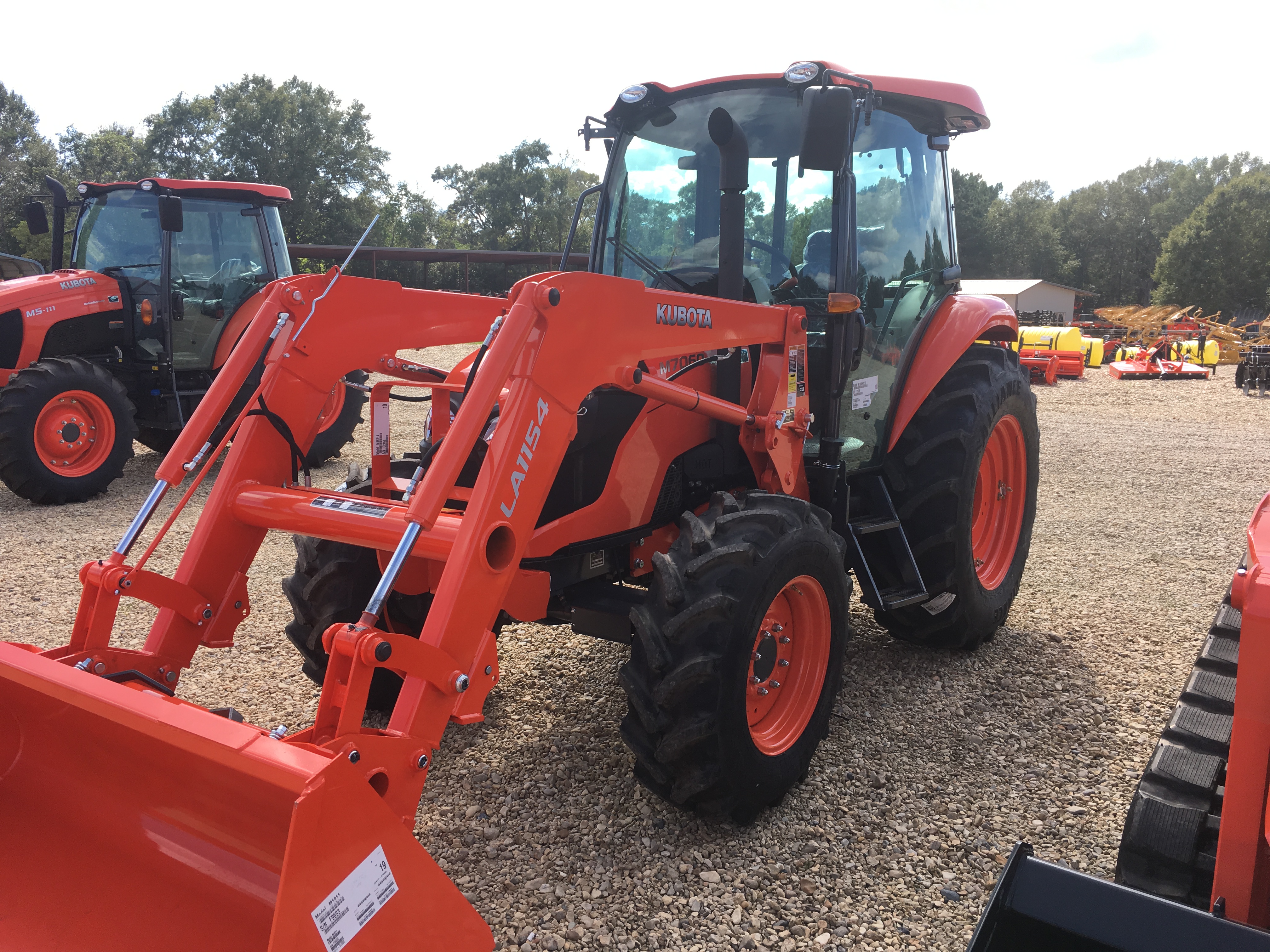

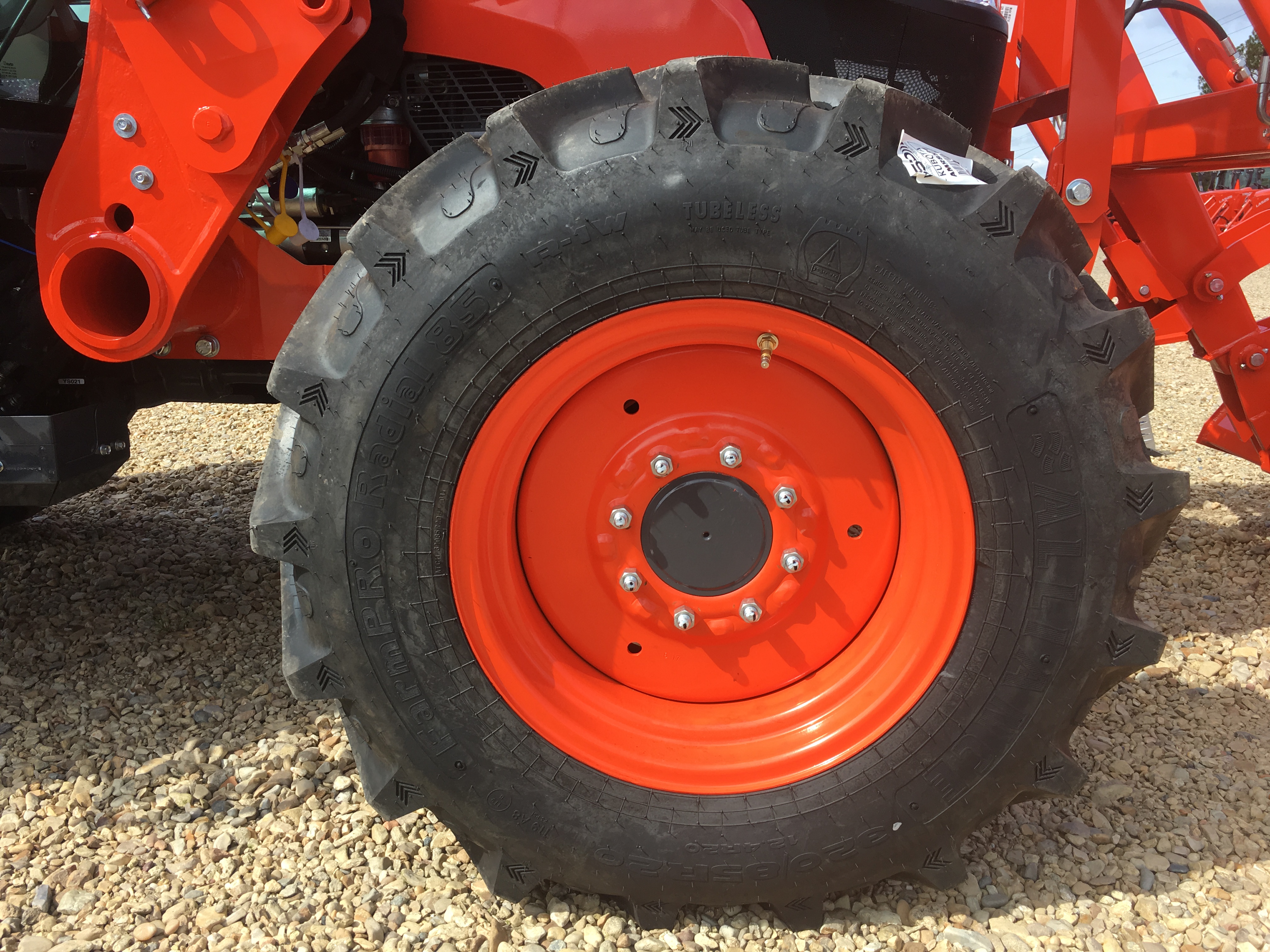

Well my new baby has arrived at the dealer and I got to check it out and take some pictures. Unfortunately a few of the dealer installed options did not ship with the tractor and it will be late next week before I actually get the tractor. Good news is since the delay the dealer will add and plumb up my hoses for my Lane Shark after I pick it up and deliver it to them tomorrow. Tic Tok Tick Tok.... It sure looks good though!

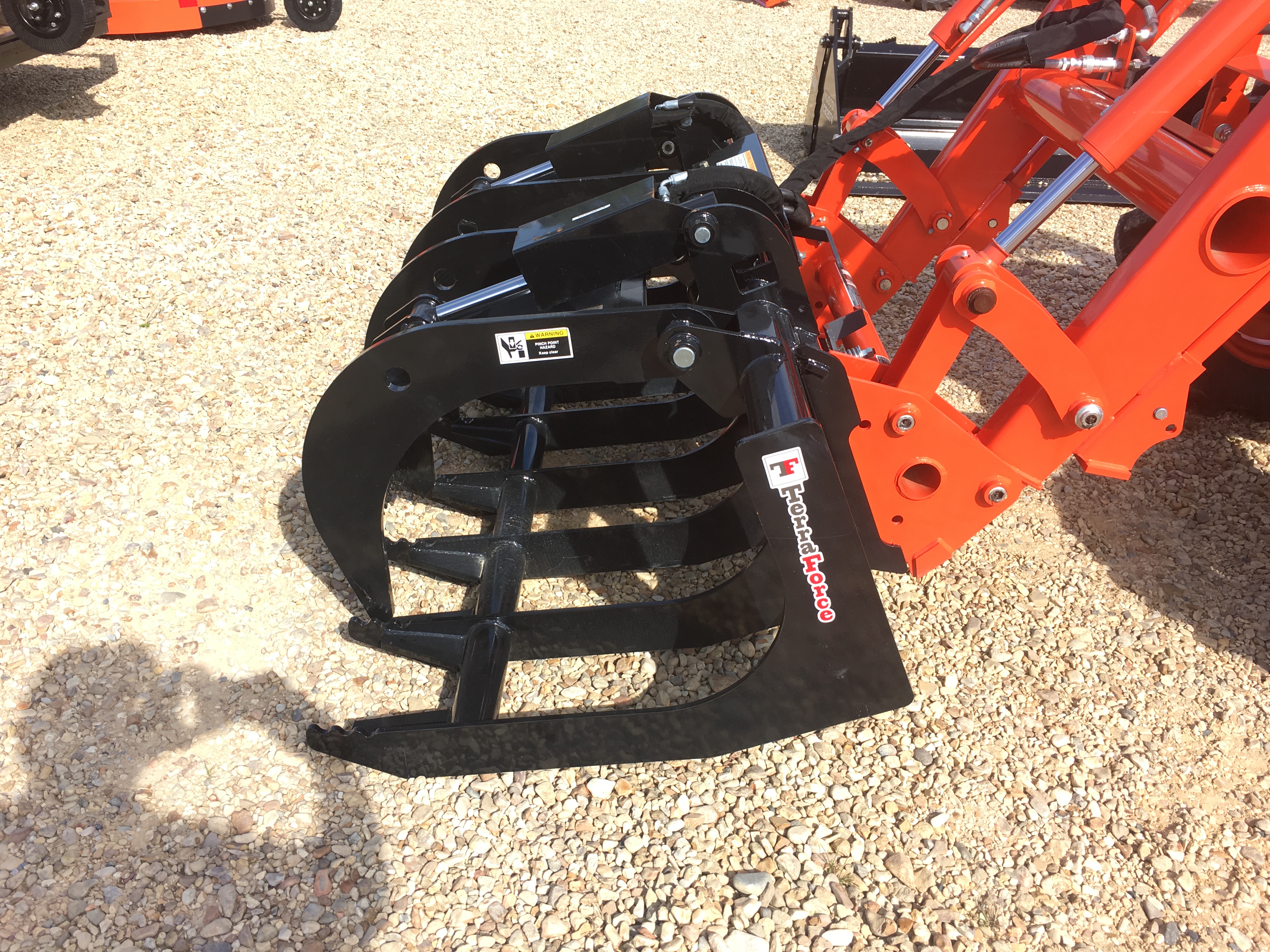

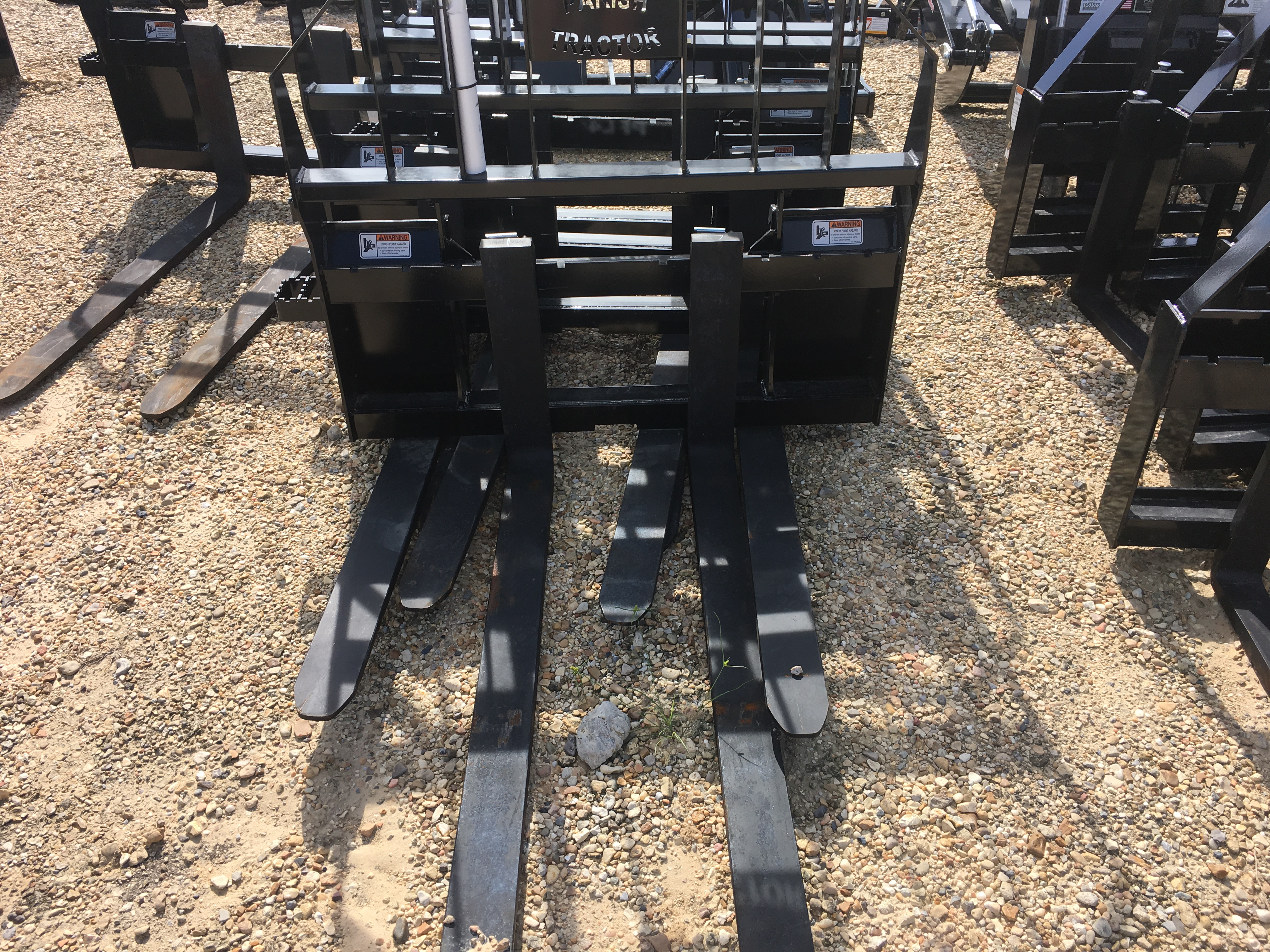

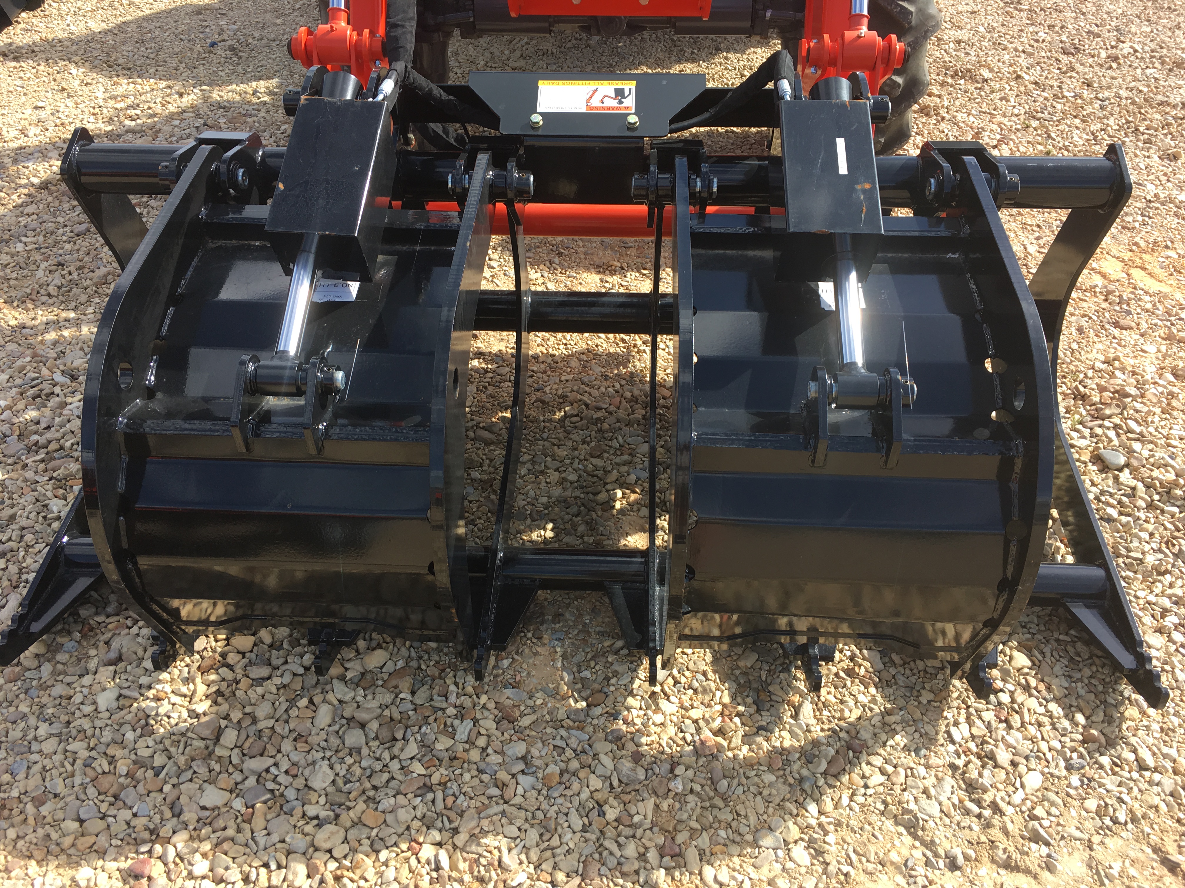

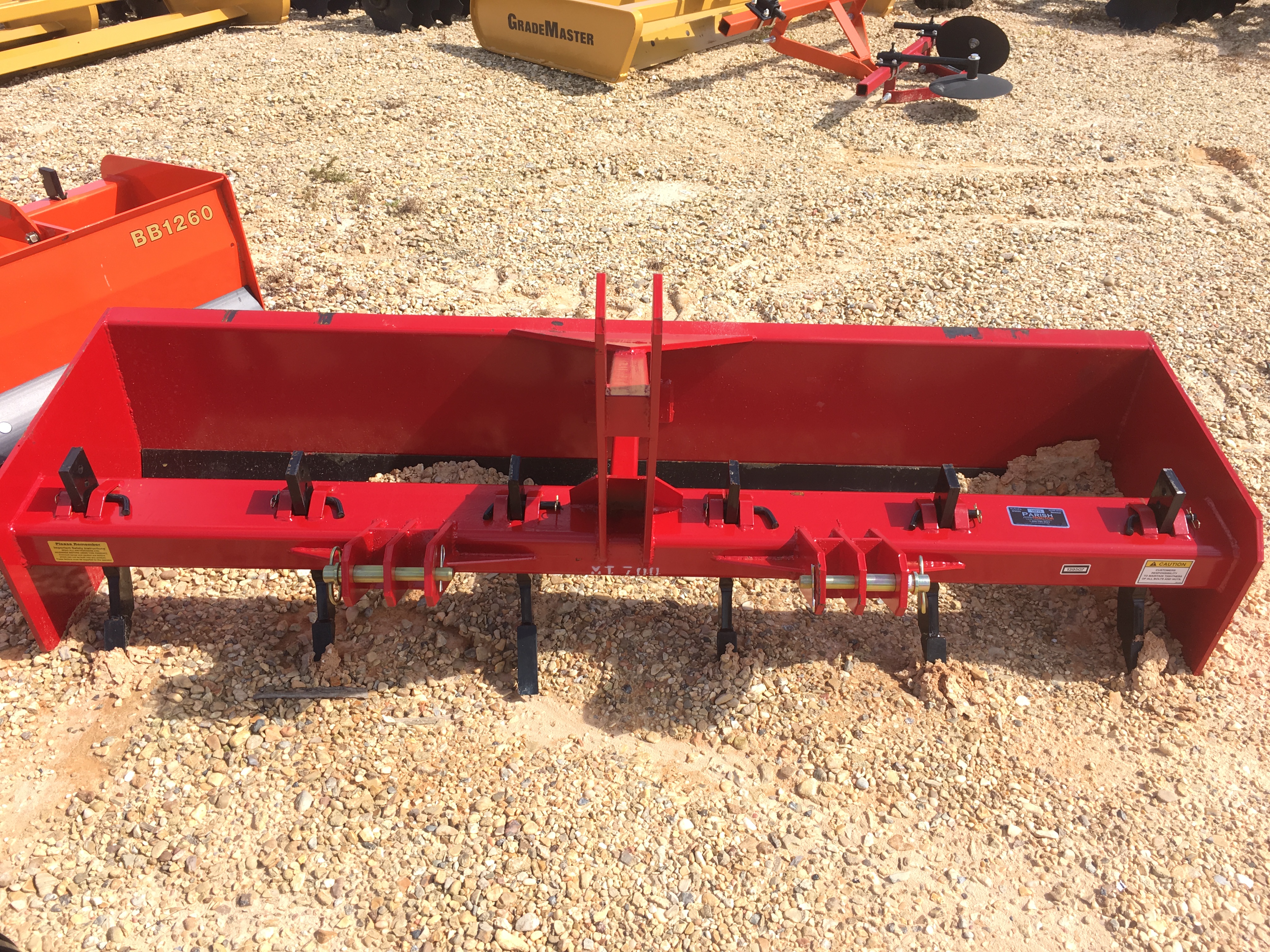

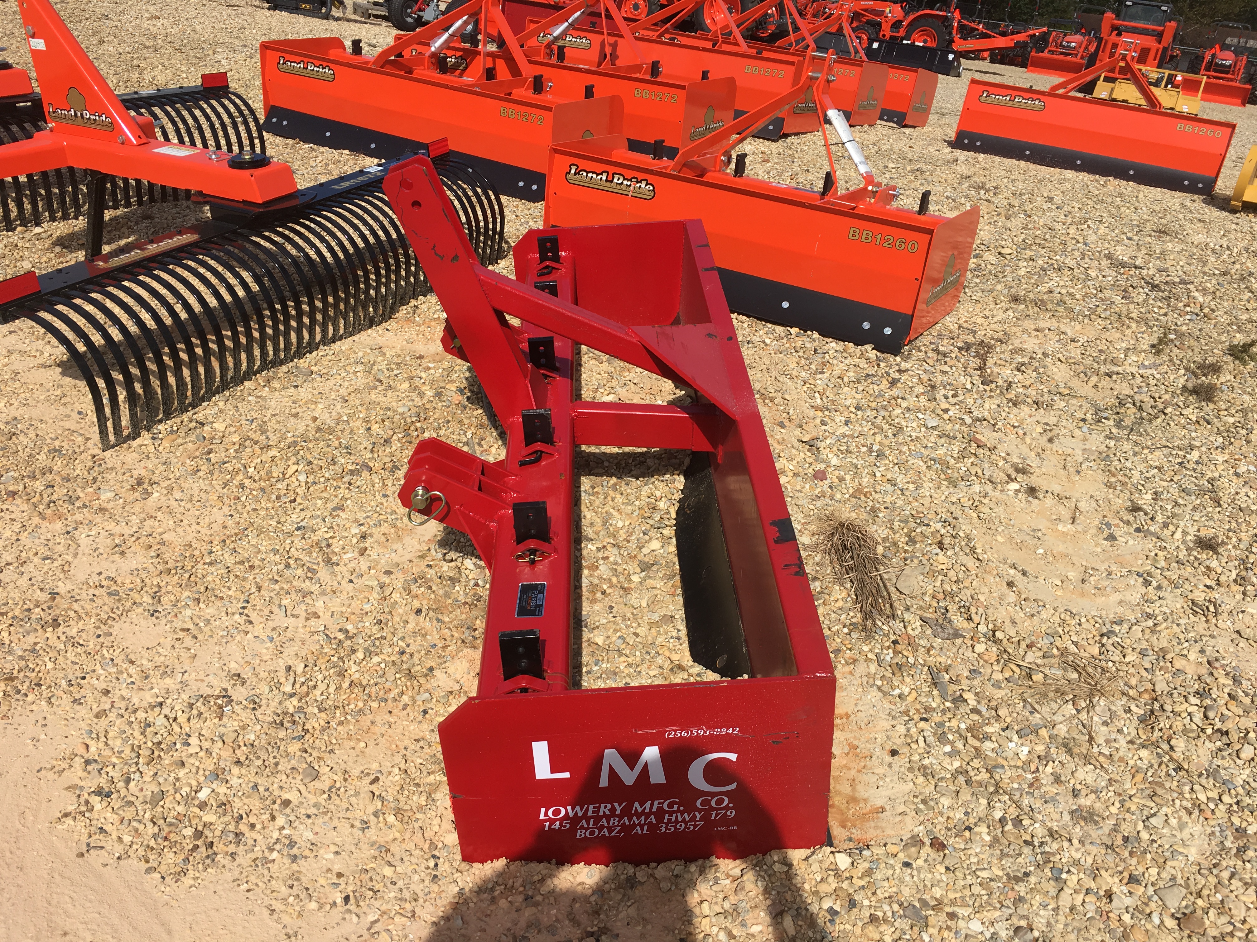

Also got some pictures of my attachments. They said the tiller was there but I couldn't find it, their yard is BIG.
