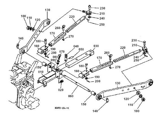

As Milkman said, and they are not welded I broke the turnbuckles first time I tried the back blade.
ron
   / MY Mods to a BX TPH #19
Milkman and 638, thanks for the info. Well, I guess its time to find some part numbers and order those telescoping stabilizers.
   / MY Mods to a BX TPH #20
I'm at my other computer now and here is a picture of the parts, maybe you can print it out and show it to the partsman and you'll need 2 of item #170 and two of the #220, mount the #220 to the triangular shape plate between the lower TPH arms and cut a slot in the side of #170 to fit over the the tab on the rear end of the lower TPH arm. Just be sure to pay attention to the hole arrangement in the #170 before you make the slot, be sure you slot the correct end. Hope this is a help, I know you'll like the results.
