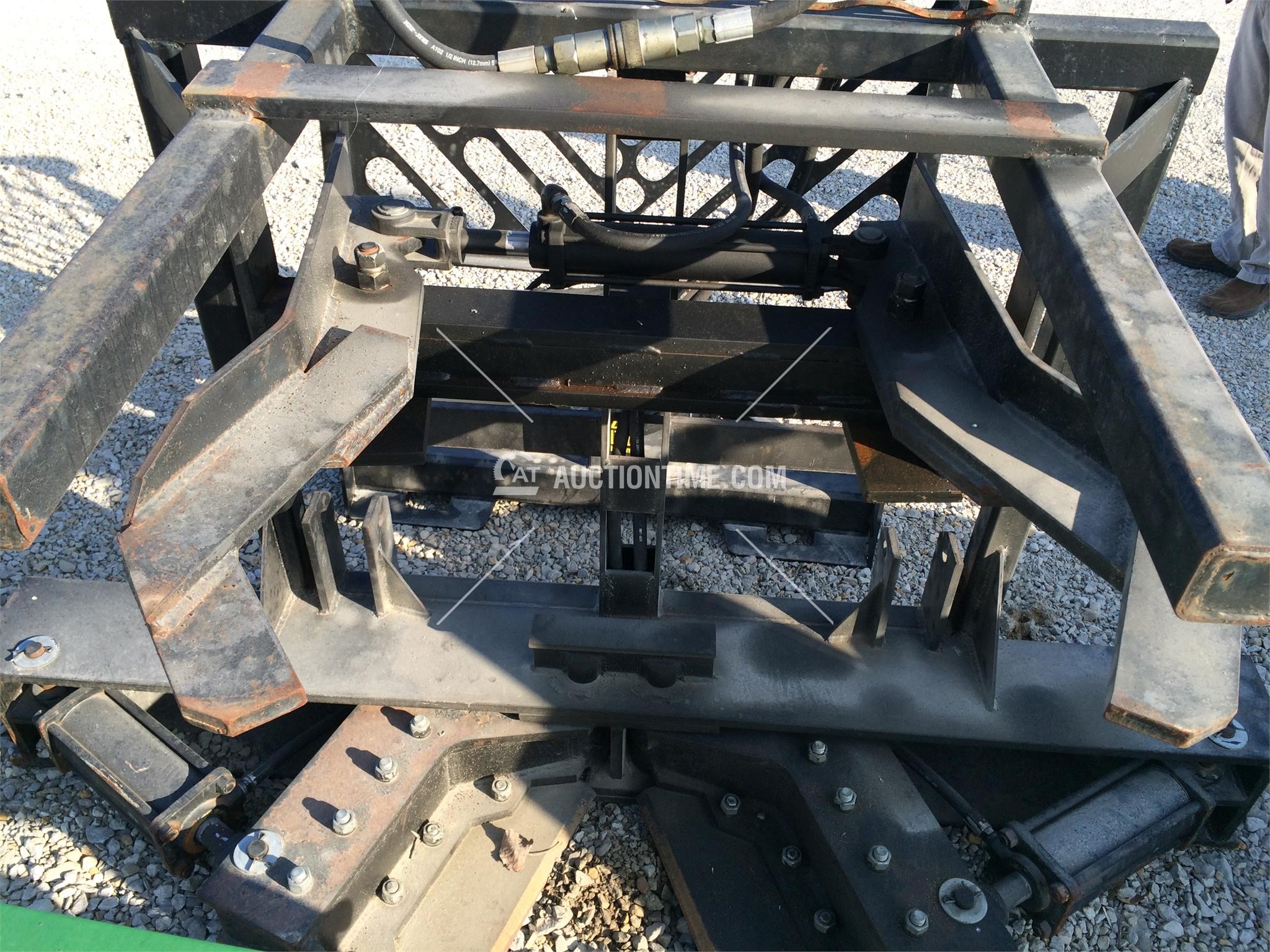

I think you will get a LOT of use out of that tool!!!! Almost as handy as a Grapple. :) I question the framework being strong enough. If used hard I believe the swinging jaw will very soon not align with the stationary jaw. If so, then it will lose the shearing ability. On your tractor it may hold up very well. Sure hope so. In regards to shearing, with small trees you will have to develop a "soft" touch if wanting to pull a tree. Clamp too hard and it is going to shear it. This talent will probably develop with use. Mine doesn't overlap and I still sometimes grip a small tree too firmly and crush it to the point it pulls in two before the stump and roots are dislodged from the ground. We expect pics in use of course!!!! :)
Gosh that's the hope. I hope it's a handy asset that gets a lot of use in addition to my grapple and mulcher. I believe it's built pretty stout and over built for my tractor. I still hope you're correct and it doesn't work itself loose.
You are correct as well in regards to getting the feeling to no Crush something. I've since grown to become pretty sensitive with my grapple and hope this happens with this tool.
I'm pretty much on clay but plan to use the tool all over so only time will tell on soil conditions.

I do happen to have a cab (which naturally glass is always something to worry about ). Front axle is definitely something to take into consideration. However I don't think I'll be lifting too too much. Just what the tractor can handle until a saw is needed

Based on my experience with a Cedar Tree Cutter and a Long Arm Tree Puller, I will be very surprised if it works well cutting or pulling. :confused:
For cutting, the blades are not sharp and there is no room for the trunk.
For pulling, it doesn't have the contact area to get a grip on the trunk.
