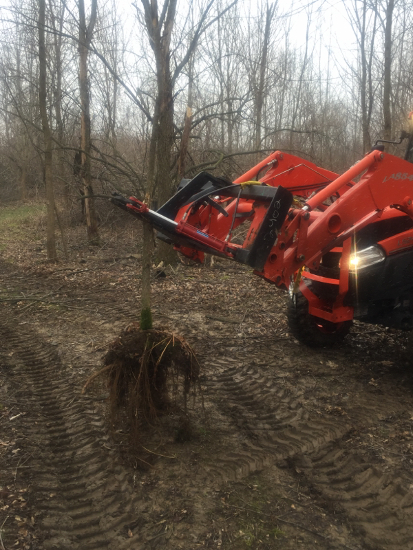

I think you'll find a need for some rear ballast.
I don't see a gripping problem. The way the cylinder is setup it will grip very tightly. Leading to the issue of shearing when you want to pull.
Be aware that you will put stress on your FEL that it isn't designed for. Example being if you clamp onto a tree that you can't simply pull. Then you decide to reverse the tractor and try to lift and backup. Your FEL is being forced to "roll back". It's possible to bend the bucket cylinder rams.

I have done a ton of pushing and lifting with the bucket 1-4ft off the ground while using my tree puller. No damage YET to loader or front axle. I've found it quite surprising what I can pull!
   / My new additions (tree shear / puller) #33
Yep, me too. Over the past 5 years I've pulled at least 1,000 trees. Bent the rams on my bucket cylinders on my previous Kubota L4400 doing exactly what I described. Your results may vary. Can also be duplicated using a Grapple, but less likely because you are normally Grappling loose material and not trying to pull something. Just understand that the puller can put stresses on your FEL that can't be duplicated with a bucket.
Edit: Let me clarify, cause my explanation might not have been worded quite right. I'm not talking about "lifting and pushing". That puts "pull" stress on your bucket cylinders, which they are designed for. I'm talking about lifting and pulling backwards with the tractor. That puts "push" stress on your bucket cylinders and their ability to stand that is limited by the amount of pressure required to bend them thru compression. Totally different scenario and load.

Lifting and retreating backwards is when you'll bend your bucket cylinders. The "stuck" tree will cause your puller to curl upward, putting push pressure on the cylinders, which they do not like. The down pressure will give your tractor exceptional traction. Then things can possibly go bad. :)
