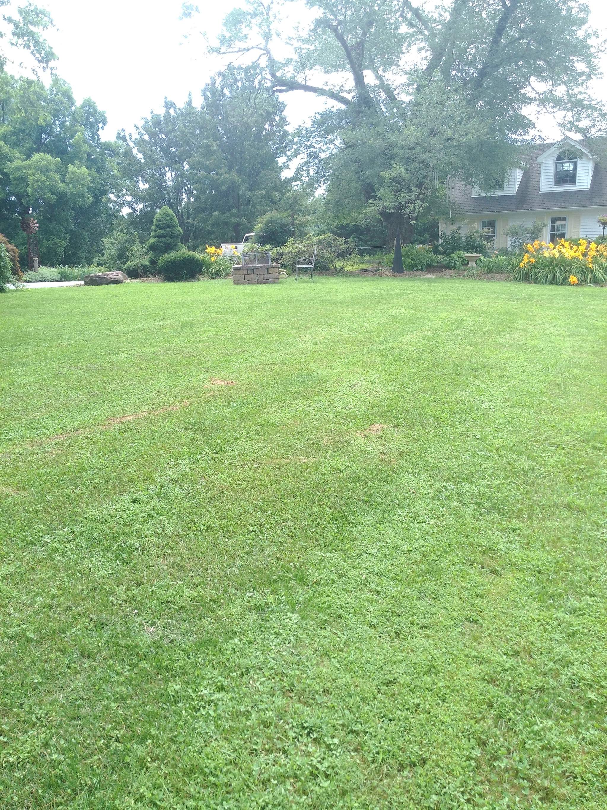

Hopefully this will give those considering the B2601 an idea of the quality of the cut. It is longer than my old BX thus less nimble around obstructions but on the straight paths it is a dream. I obsessed about R4s vs Turf and am really happy I went with the Turf tires. This year has been ridiculously wet and the R4's would have torn up the yard and fields. I've been mowing every 5-6 days to keep up with the growth. There is definitely a clench factor on steep slopes even in 4WD. I'm considering wheel spacers.

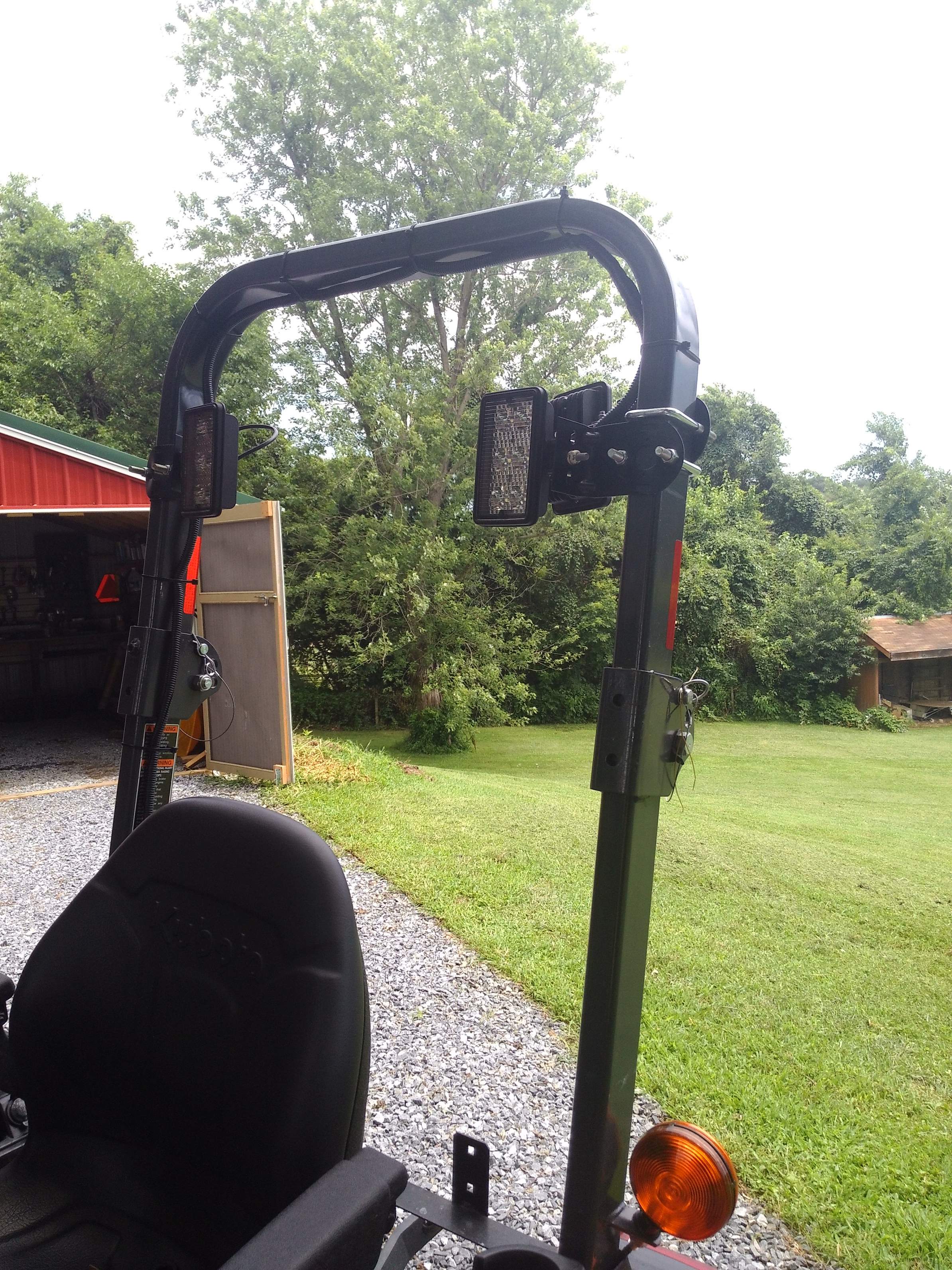

I installed LED lights and a waterproof switch. You will find a pair of connectors under the right rear fender. Can't miss them.

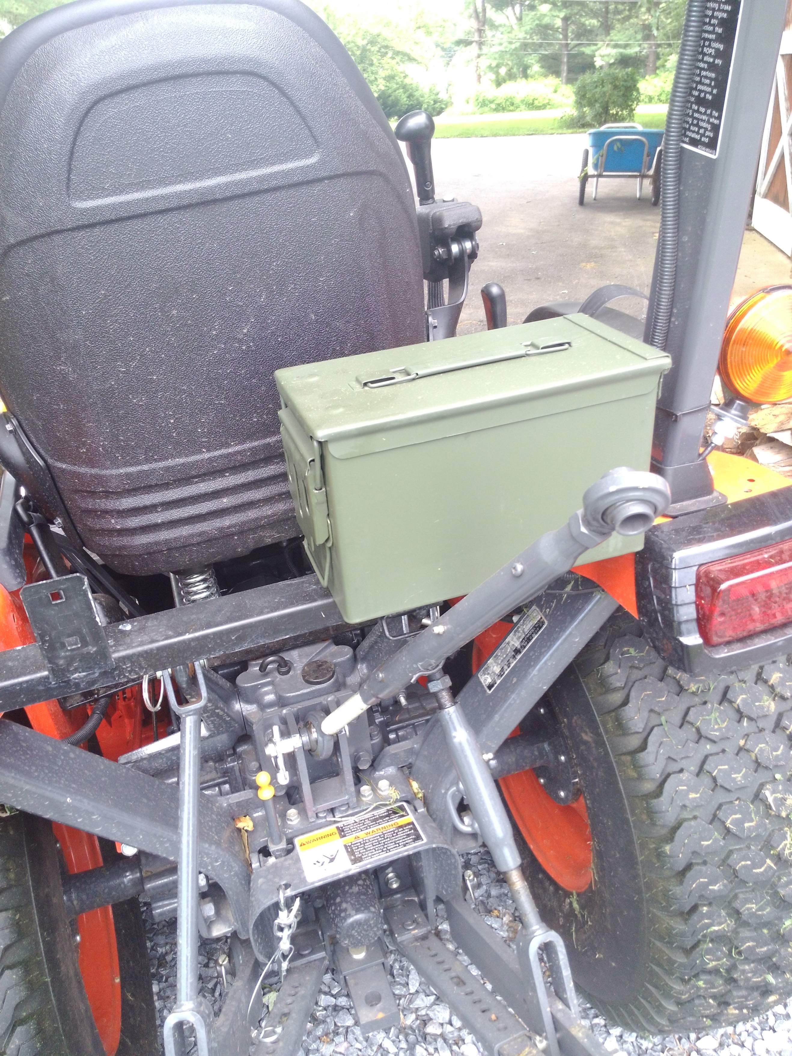

The Tool Box that came with the tractor was too small for my need so I bought this waterproof 50 Cal ammo box off Amazon for about $30. I drilled holes in the bottom and used the mounting system Kubota provided.

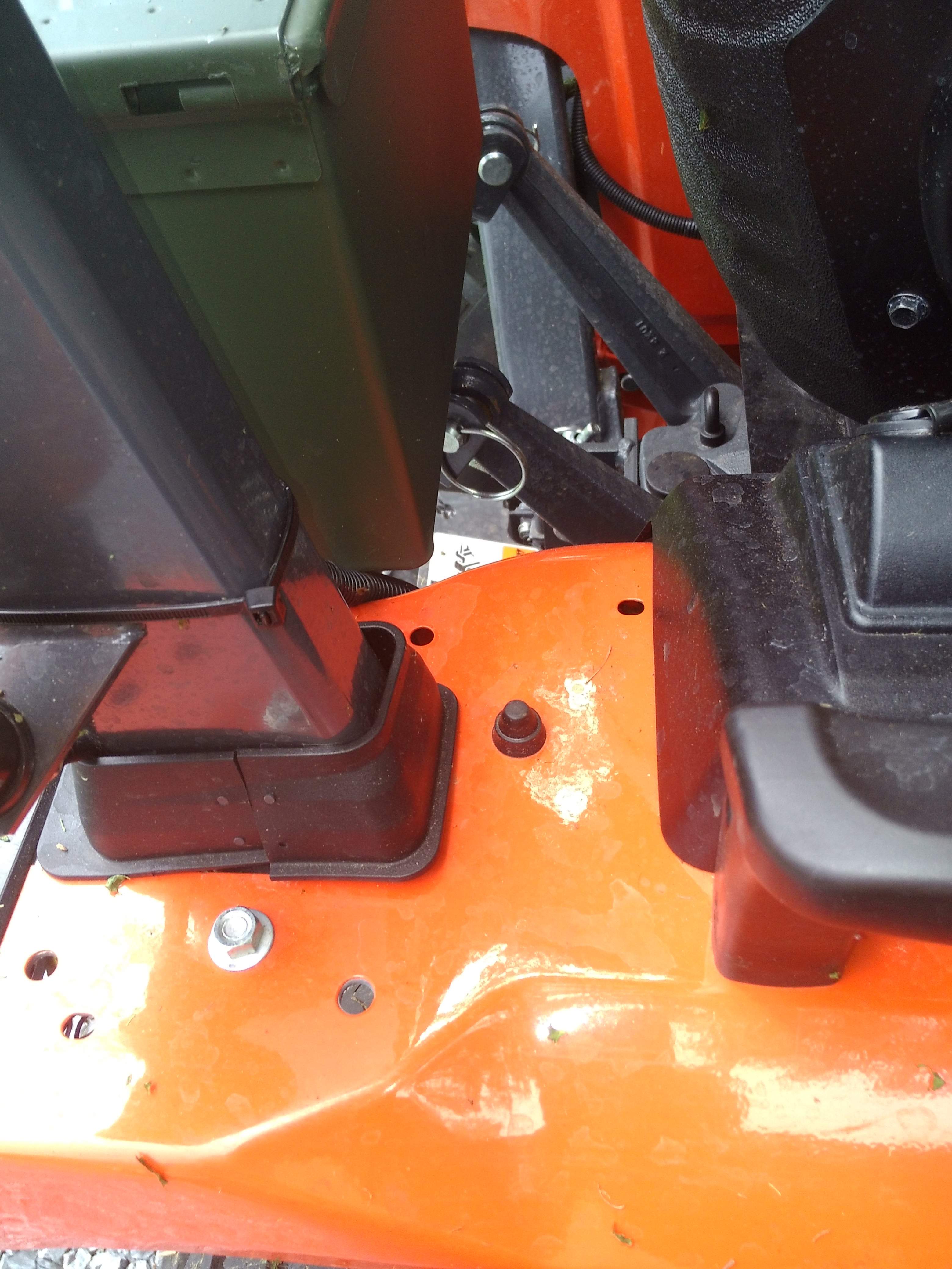

I found this arrangement for the stabilizers more convenient and way faster, simple 5 minute job once I got the parts at my local Ace hardware.

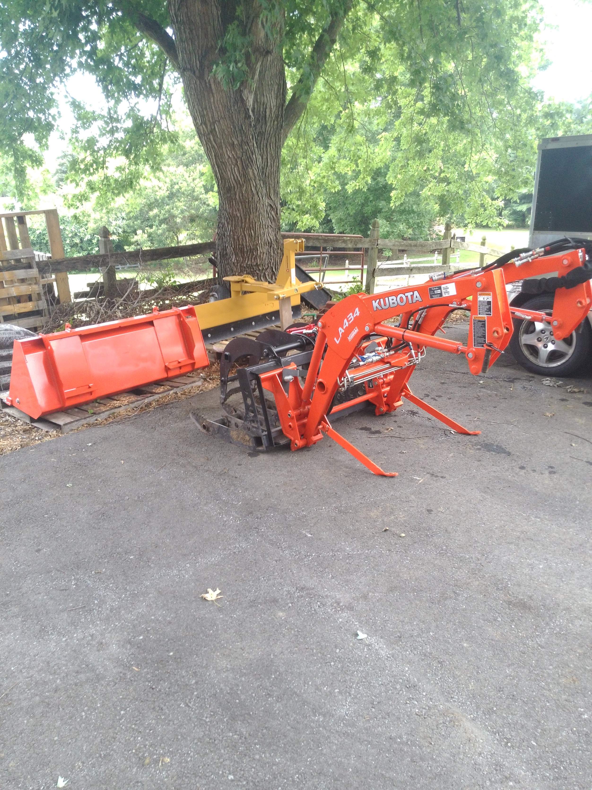

I really love the machine but have one serious gripe with Kubota re: the on and off of the FEL arms. It seems to me that the tractor has to be PERFECTLY level to have a chance of a good marriage of parts and even then good luck. I hate the design of the FEL stand. You'd think they could add more surface area to the legs so you could remove the FEL on grass or dirt. It is a friggin tractor. I really liked the Deere set up much better but in spite of this issue preferred the Kubota. I do remove the FEL regularly, maybe I'm doing something wrong and one of you pros can help me out here.

We have two BXs, a GL and M, all the loaders are easy on/off after the first time or two as there may be some paint interference. I've taken mine off on concrete, rock and dirt. If the dirt is soft, I put a board under the feet. No doubt concrete is preferable, but it's not always available.

I just got off the phone with Neil Messick about my next parts purchase and I mentioned to him the issue and he made the same comment about the paint but I think it's unfortunate that such a first class product like Kubota can't get it right. This should be a seamless, bulletproof process and it's just not. I have lot's of friends that just say "I never remove the FEL" . That's not an option for me.
