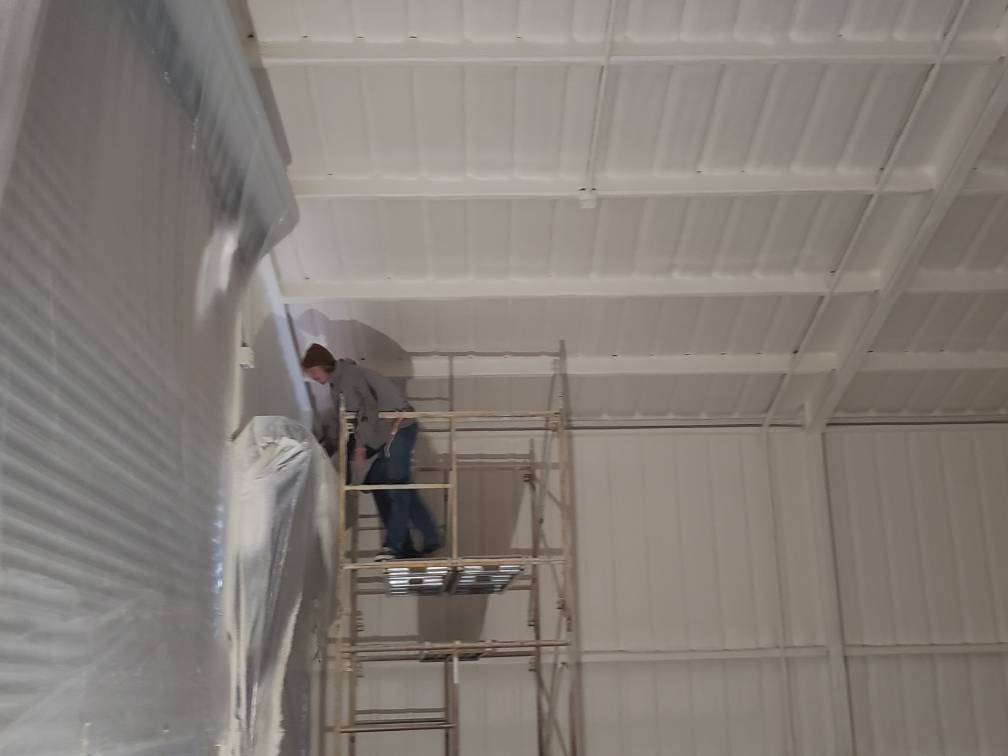

Spray foam went in today. Closed cell. 20191220_151355.jpeg20191220_151400.jpeg
   / My new barn / shop build #103
How thick did you go? I can see gaps between the beams and the ridges of the roof panel, which makes me think it's just one inch thick, if that.

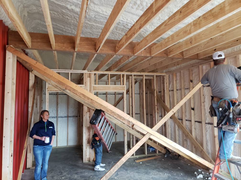

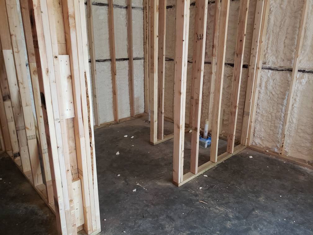

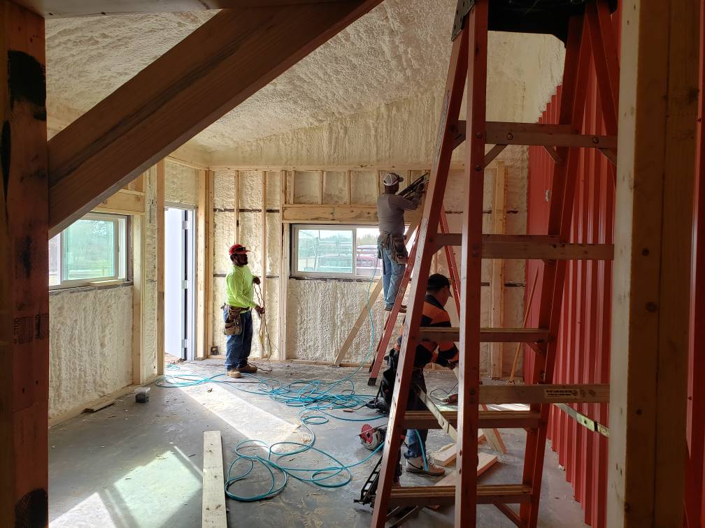

Framing going in on mother in law unit. 20191227_113842.jpeg20191227_113858.jpeg20191227_115029.jpeg
