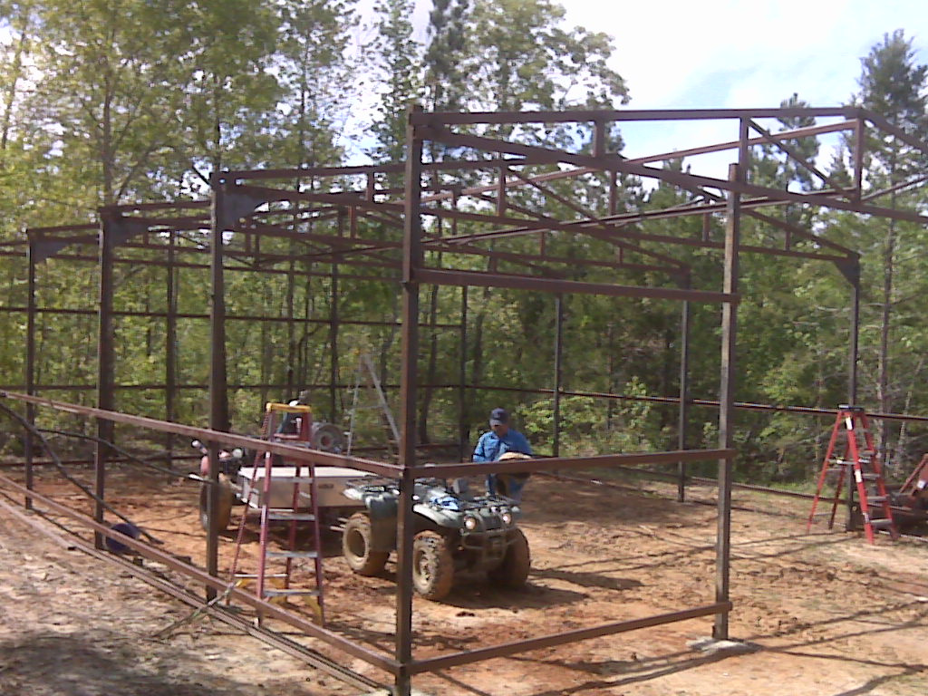

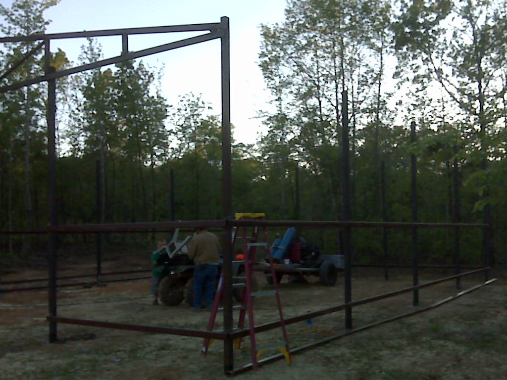

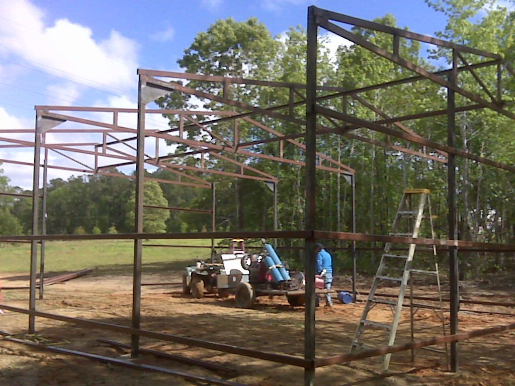

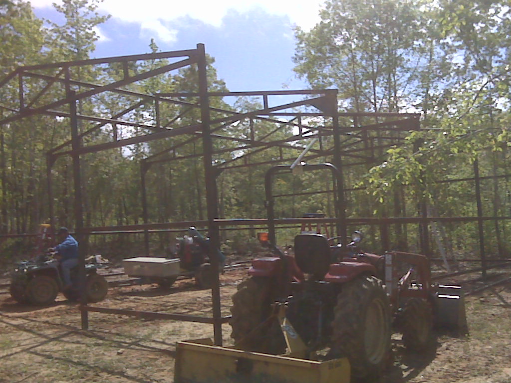

Here are some pics of the progress... Your comments are welcome !!
   / My new Barn/Shop #25
I don't see concrete on the posts? Don't know if you need it.. Seems sheer would be a bigger problem than lift, and I don't see a sheer problem..
Did you "stick build" the trusses in place? Or did you make a boom we need to see? :)
   / My new Barn/Shop
#26
We drilled holes with the auger, 12" diameter, 3' deep.. Tamped about 6" of soil around base of post, then filled with concrete to ground level..
My plan is to still pounr concrente after finalizing the grade, once the building is in place..
As for the trusses: They are pre-built.. INSTALLING THAT FRONT TRUSS WAS A BIT OF A TRICK.. My neighbor down the road has a larger tractor, with a boom pole for his FEL. Well, he was not available right then, and since I am a proponent of instant gratification, I had to devise a way to install them without his assistance..
I sat in the bucket of my FEL, and "held" a truss on the bucket in my lap.. My father in law picked me up to the top of the posts, and I hefted the truss up and sat it on the angle brackets we had already welded to the outer end posts... It was quote a pucker moment for me..
I'll be receiving help from the neighbor for the remainder of them... :)

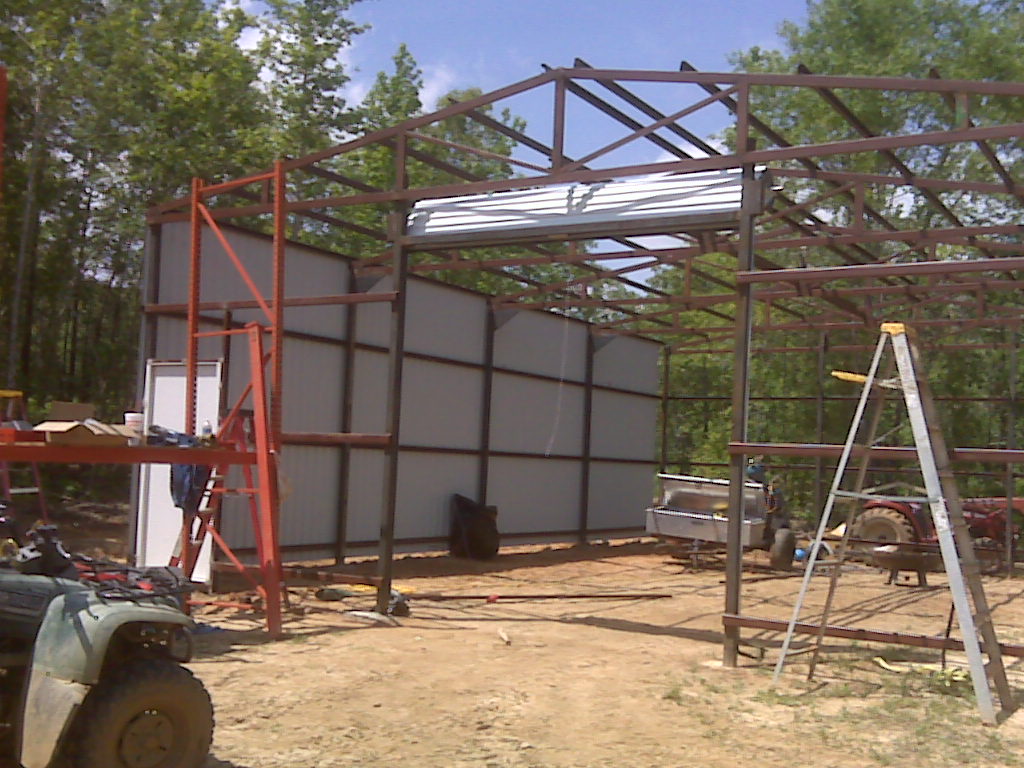

well hopefully by the endo f the weekend, we'll have the rest of the trusses in place, and have purlins on the roof...
As you can see out to the side, the cleared spot between building and the trees, I am going to continue cutting it down quite a bit, to park the 5th wheel camper in there. I will end up putting a lean to style roof off of both sides. Camper on side 1, and other side for dog run, tractor parking, etc..

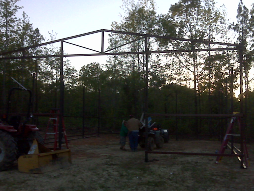

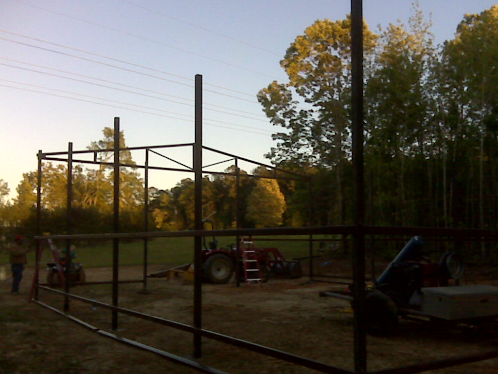

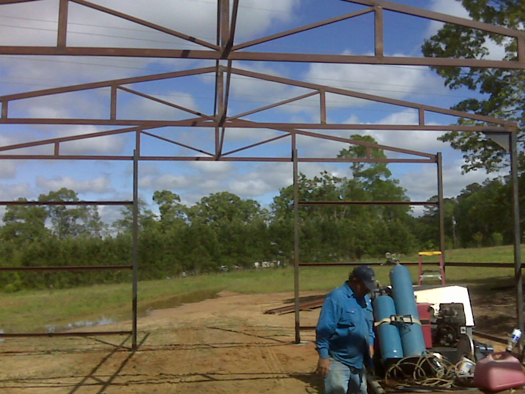

Here are a few more pics of progress made this weekend.. Sunday was rain filled from sun up until about 2:00. That's when we finally got a chance to hang the rest of the trusses, and get the gussets welded up..
Enjoy the pics:
