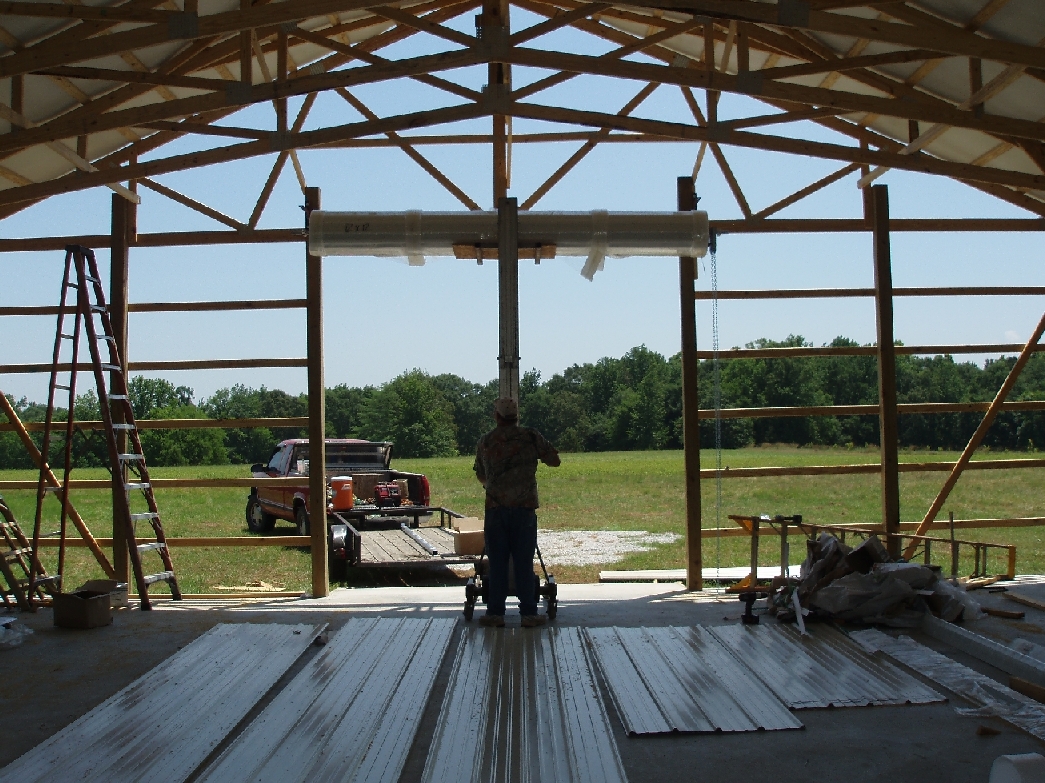

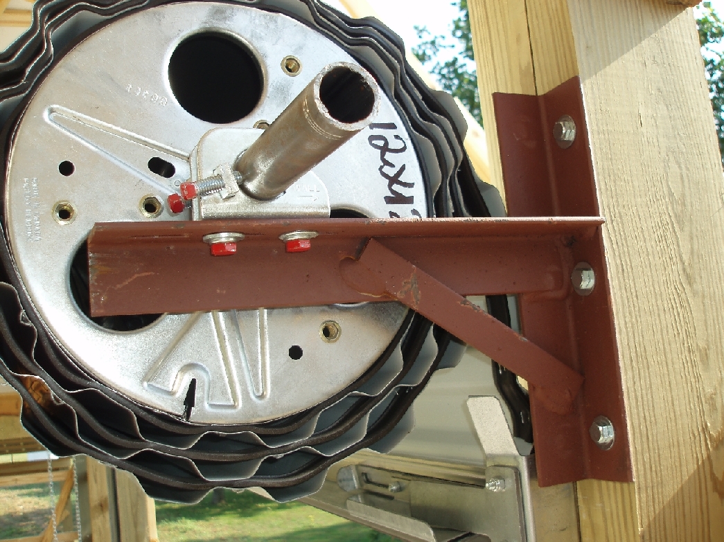

#33

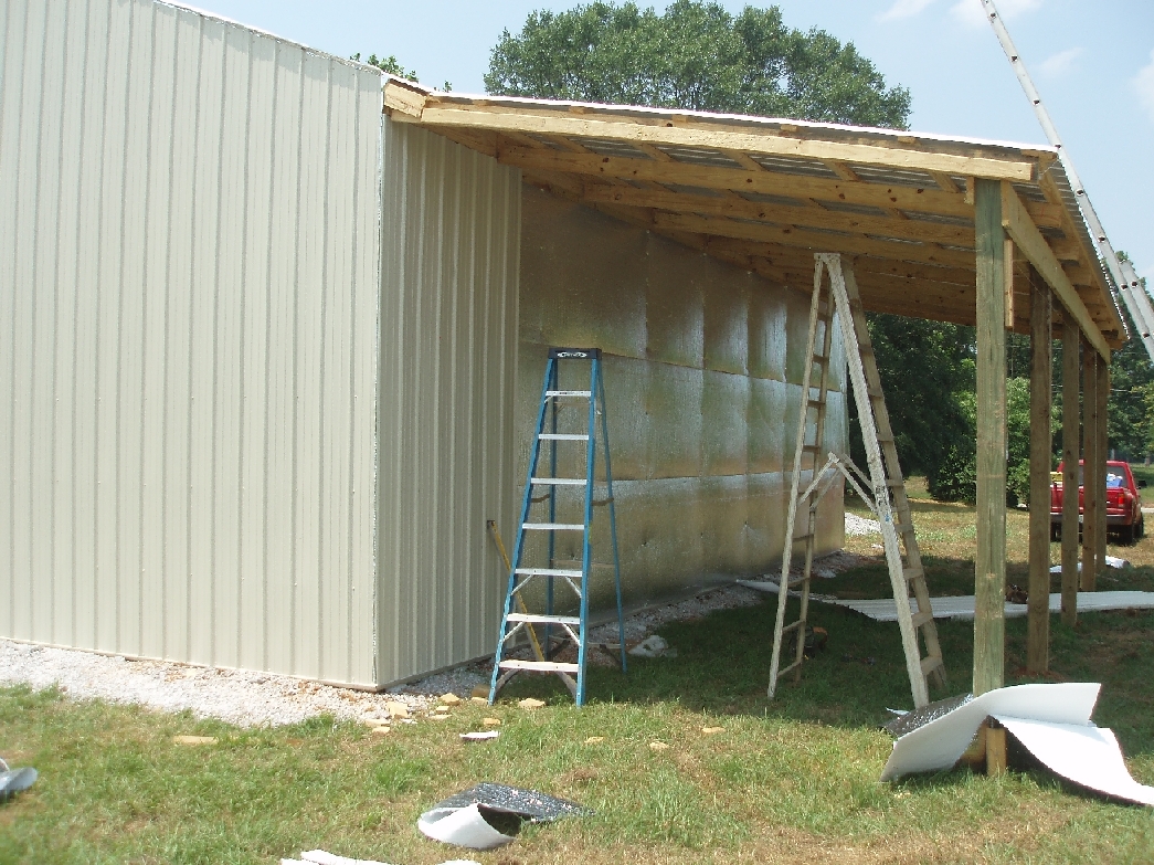

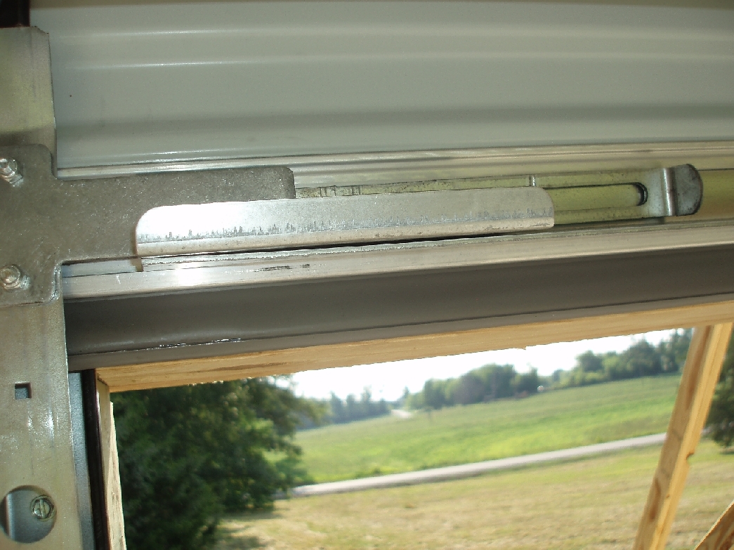

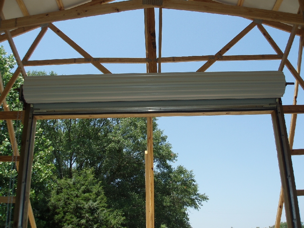

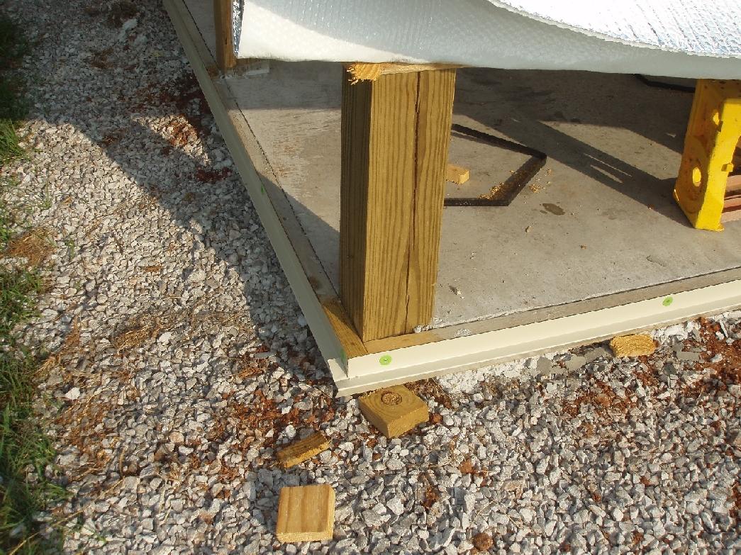

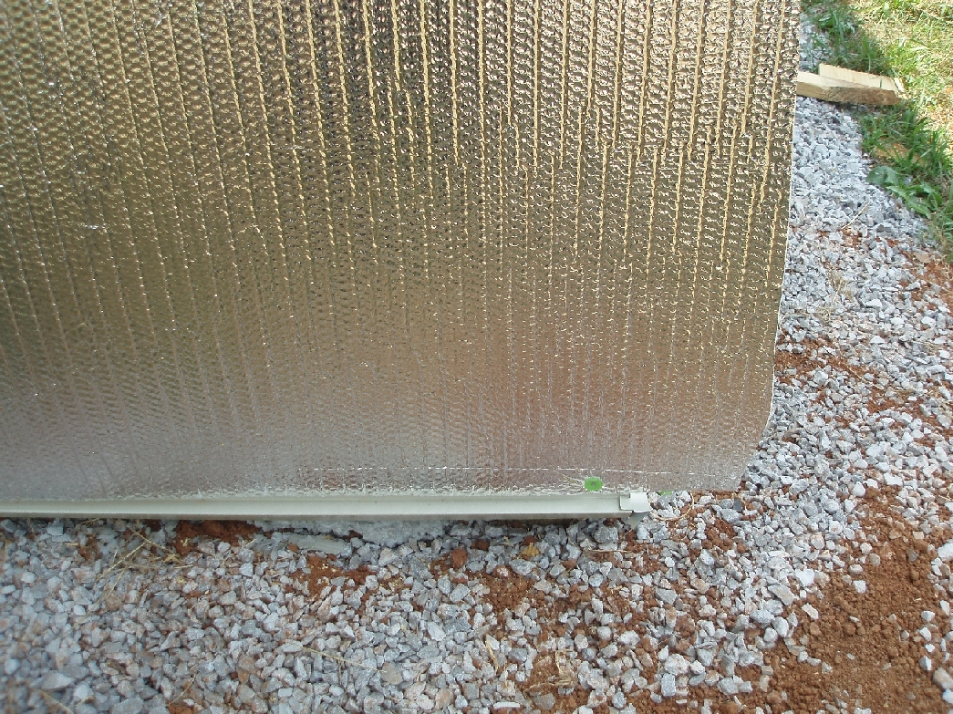

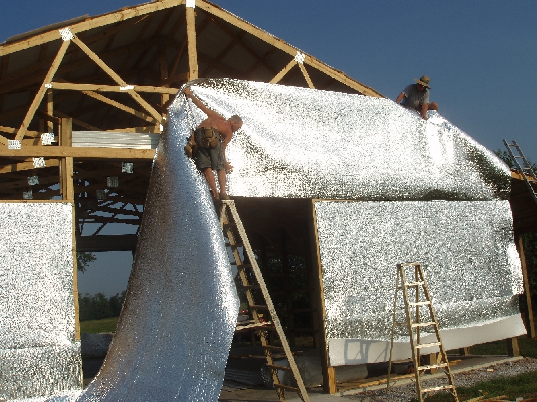

Doors, insulation and siding going on.
Photos 1 & 2 - roll up doors being installed.
Photo 3 - End view of door and mounting.
Photo 4 - Latch on bottom of door, one on each side, to allow locking the door down.
Photo 5 - Double bubble insulation being installed. It made a big difference on the inside temperature.
Photo 6 - Rat seal, held the job up two days waiting on delivery.
Photo 6 - $400 more and I was able to match the color of the siding with the color of my house.
Photo 7 - Insulation against rat seal.

Sweet building. That double bubble looks a whole lot nicer to work with than the 3" fiberglass I used.
   / My new barn / tractor shed #35
Look awesome.. I should be building a barn in the next 90 days.
   / My new barn / tractor shed #36
Your building looks great! A question on the insulation ... did you use a firing strip between the insulation and metal siding? I was looking at one of the insulation supplier web sites and they recommend the firing strip to create an airspace between the insulation and the metal siding.

May I ask what brand of roll-up door you chose? They may not be as aesthetically pleasing as conventional sectional doors; but if you choose to work at night with the door open, the roll-up won't block any of your lighting fixtures.
