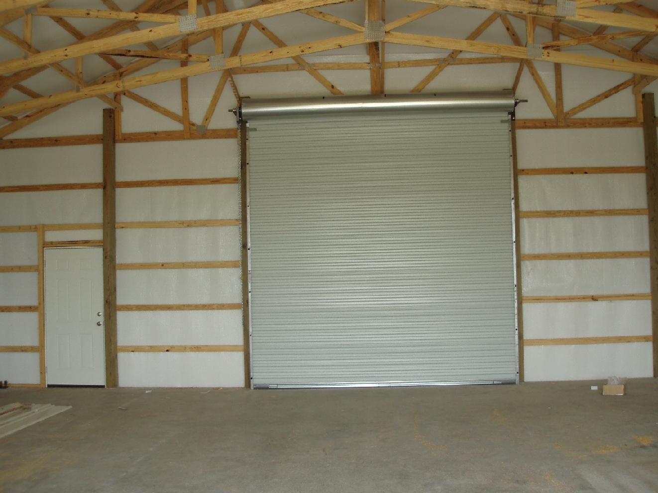

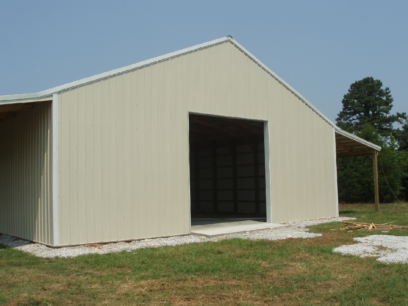

My shed is all finished now except for some cleanup and moving in. Looks much better trimmed out.

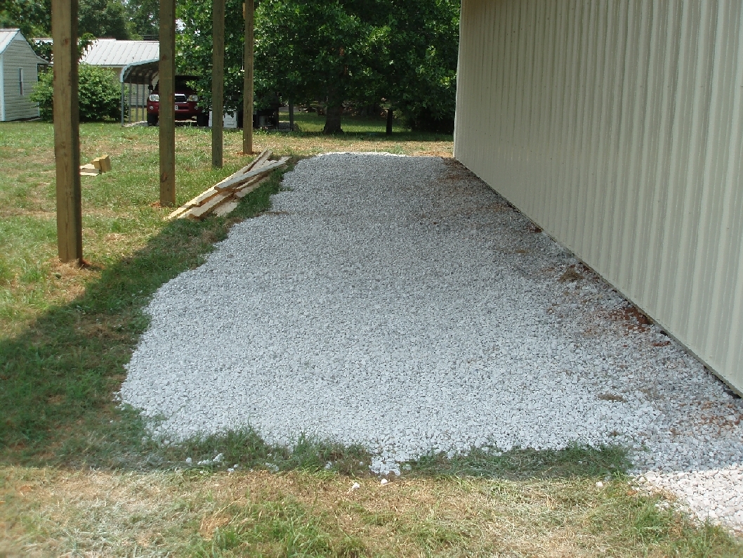

Now to sort all this out for your information.
Material = $9100
Concrete = $1989
Finishing = $ 440
Gravel = $ 650
Slab prep = $ 300
Labor = $3800
Total $16,279

   / My new barn / tractor shed #45
Nice :thumbsup:
I really like those sheds on the sides, gives you so much extra covered area. Leaves more free space inside. Price seems very reasonable too.

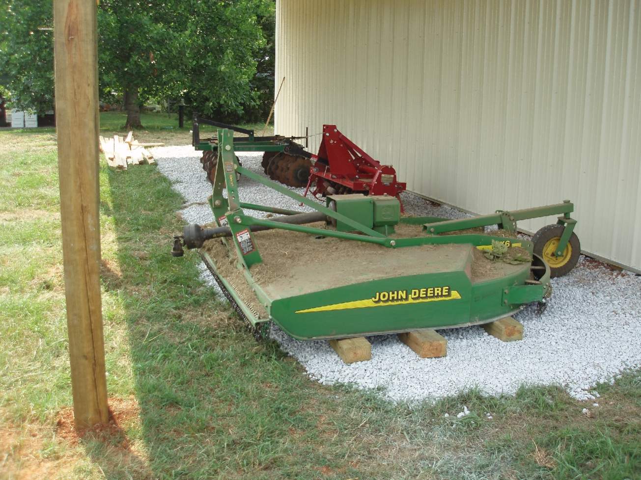

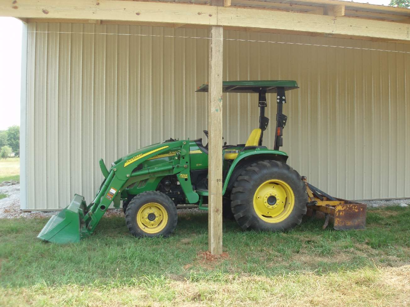

   / My new barn / tractor shed #46
I ain't gonna tell you what to do but if you blow the debris off the top of that MX6 before storing it it'll last a lot longer.
Awesome building by the way. Congrats!
#47
No problem besides I need someone to tell me what to do usually anyway! I always clean it off before storing but for the photo session I didn't. It's already back at work and needing cleaning again.
   / My new barn / tractor shed #49
I am not a builder, but have never seen concrete poured on top of grass. Was always told to remover the grass/top soil first.
I was wondering the same thing looking at the picture of the dump spreading the stone. We've always removed all organic material down to bare dirt.
