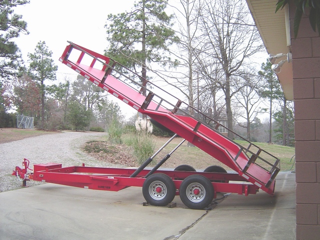

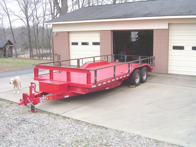

Well, I've been mainly a lurker for the past couple years, hardly posting but learning a ton from all you folks. I have a 7000 lb 16' dovetail trailer which will be too small for the tractor I plan to buy, (another post, later). So after much searching, I had my ultimate trailer made...and for a good price! I just got back from picking her up in Indiana to home in SC. So...a few pics...
And a few details...14K GVW. I figure the trailer weighs around 4500 lbs or so. It has 6 D-Rings welded on top, 6 Ft Ramps With Stabilizers, Adjustable 2 5/16 Hitch, Stake Pockets & Rub Rails, All Sealed Beam Lighting With One Piece Wiring Harness, 12K Drop Leg Jack, 14 Ply Tires & Sliver Modular 8 on 6.5 Bolt Pattern, Self Contained Electric Over Hydraulic Power Unit With 20Ft Control Cord Powered By A Group 27 Interstate Deep Cycle Battery, Two 31/2 X 36" Stroke With 3/4 Rod Direct Push Hydraulic Cylinders, All Required DOT Lighting, Safety Tape & Break Away Kit, 7 Way RV Type Elec. I plan on welding up some 18" sides and tailgate, and also chain tray to keep stuff in, (like my 7000lb trailer).
After having one type of trailer that is limited, you learn what you need for the next trailer. What do you think? A dumper and hauler in one, this time...
Looks like a really nice trailer!
I was a little concerned with the first pics, it seemed like an awefully steep tilt-bed to drive a tractor on :D , then I saw the last 2 pics. Great Job!

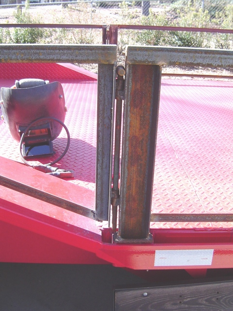

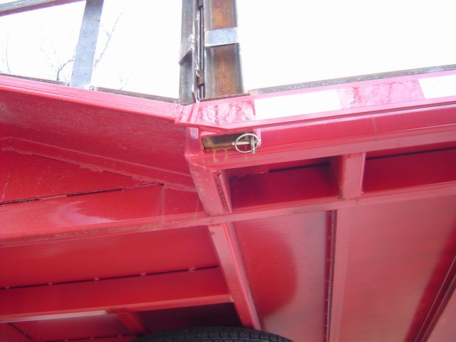

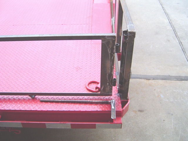

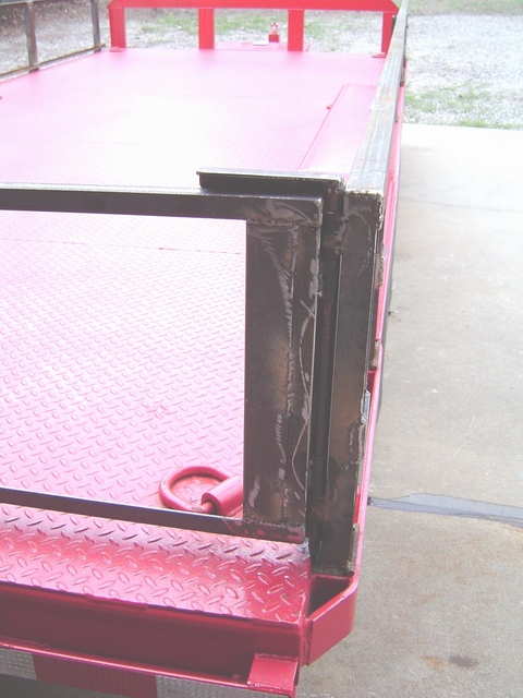

Hi Folks,
I thought I would post a few pics of my equipment trailer removable side project. They may help anyone else wishing to build trailer sides and give a few ideas. My last steps are to paint the metal and then bolt 1"x6" treated deck boards to the framework. I used mostly 3/16" metal stock and made each side of the trailer in two separate sections with removable pins to hold the hinges I made. A 20' side was to unwieldy to take off by myself, so I sectioned them. The tailgate was also done using removable pins to hold the hinges together. The tailgate will have handles bolted thru the wood to make it easier to handle. I used implement pins to hold the metal uprights into stake holders...so they would not pop out on a bumpy road, etc.

Nice job. Nothing like having what you want, the way you want it.

What is the thickness/configuration of your metal stakes on the sideboards and does the tailgate remove and if it does how is it latched for transport?
I'm still thinking of using my HD car hauler with diamond plate deck as a "TRANSFORMER TOY" trailer. I want to build a sturdy modular assy to fit on using the stake pockets to make it a stock hauling trailer. Each piece has to be easy for someone less capable than me (me later!) to fit on. I'll probably pin the stakes into the pockets with the usual HD metal pins and keepers like used on receiver hitches.
