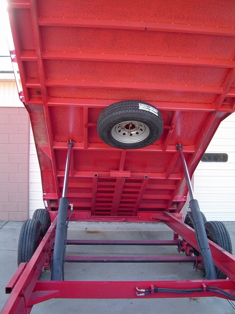

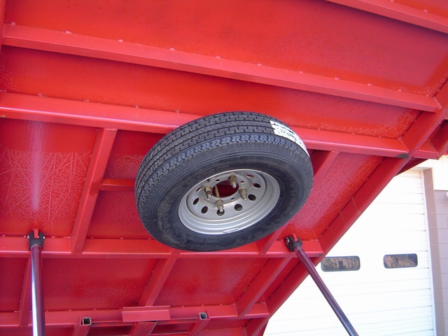

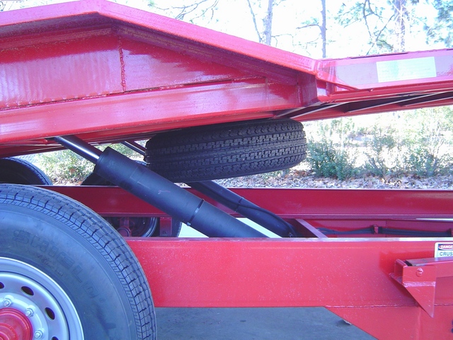

Pics of the spare tire holder/bracket I welded up for the red trailer. It's out of the way...and not on the headache rack where the tire could get messed up. I guess I will start work on the sides, next. By the way, among tools I have one of those Harbor Freight metal chop saws which I use occasionally. I got it on sale for $40 or $50 dollars...you get what you pay for. The hinge has slop in it causing off center cuts. Maybe I could shim it up. But, I think I will spend the money on a good one...Makita, Dewalt. Opinions? What about these? Only limited to a 8" blade, though. Milwaukee Electric Tool - 6370-20, 8 in. Metal Cutting Saw, Circular Saws, Saws/Corded, Tools

Works fine here and opens file and nice spot for spare
