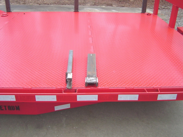

I have attached a pic of the stake holders I welded up to fit the stake pockets. I used 3 inch "C" channel, (like my older trailer). The stake holders, (sides), are 18 inches tall on my trailers. C channel comes in even sizes...3 inch, 4 inch, 5 inches wide, etc. But many stake pockets are odd sized and do not readily fit. Most trucks, many other trailers, including mine, have stake pocket openings of 3 3/4 inches by 1 3/4 inches. The C channel I used was 3 inches, by 1 1/2 inches (wide). I welded flat bar on the edges and one side to make the holders fit into the holes, and ground them for smoothness. On one bottom edge, I made a little longer, drilled a hole and used an implement pin to hold the stake in the pocket...the type of pin with the round part that snaps against the pin body to hold it onto the part it is supposed to hold. See my previous post on page 6...4th image down. The stake holder steel is probably 1/4 inch thick.

Also Pat,
I forgot to answer your other question...the tailgate. Yes it opens and can be taken off. I made hinges that separate by pulling a long pin up and out the top on each side. I used 1/2 inch (inner) diameter heavy pipe for the hinge, and 1/2 inch round bar for the pin. The pin part slides into the pipe pieces to make the hinge. You can cut the pipe (hinge portions), as long as you want for strength.
I welded a piece of angle iron on top of the pins for a handle on each. Pull up on the pin...the hinge separates! See the 5th and 6th pics on page 6, (my post with the pics), which shows the tailgate closed, and one with the hinge separated.
I cut the pipe pieces, then slid them into the 1/2 inch round bar. Then... clamped and welded half of them onto the stake side. I set the tailgate and welded the remaining pipe pieces to the tailgate side making a true hinge, and making sure everything was square and not binding. I did the other side of the tailgate, then. It's a lot simpler just doing it...than describing it...

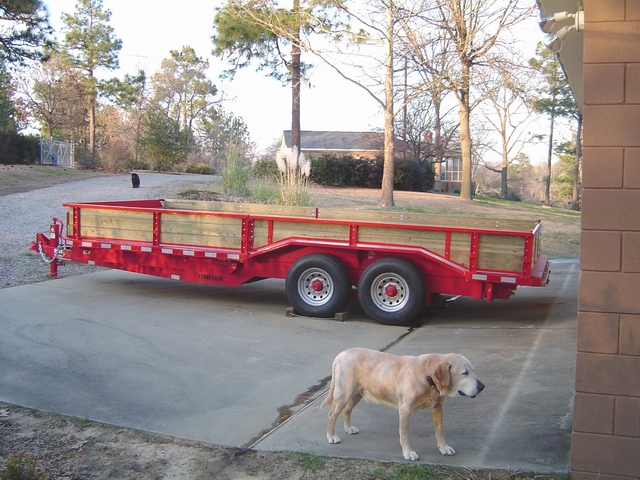

Finished with the trailer...Each side is partitioned in 2 parts for easier one person removal, and the back door has 3 grab handles and weighs about 60 pounds.

Looks real good. I know your work will pay off.
   / My new equipment trailer... #66
I will be thrilled if my stock trailer accessory comes out looking anywhere near so neat as your trailer job!
Pat
   / My new equipment trailer... #67
Dude thats a sweet trailer !!!!!!
as for all this talk about loading it and axel placement here is what i did on my 18 foot dove tail. make you front gate where it can go in multiple locations on the trailer, foreward or back depending on load. I did this and since you can only haul so much it helps you from over loading it. I just unhook mine and block it up then use the tractor to empty it but i really love your trailer. We had a problem getting trucks on and off a drive on lift when the ramps were wet so we put they painted them with an abrasive paint. when that wore off they put grip tape on them, and when that wore off i welded expanded metal to the ramps, no wear so far. i would think wear would be a concern with any paint or tape on your trailer.
