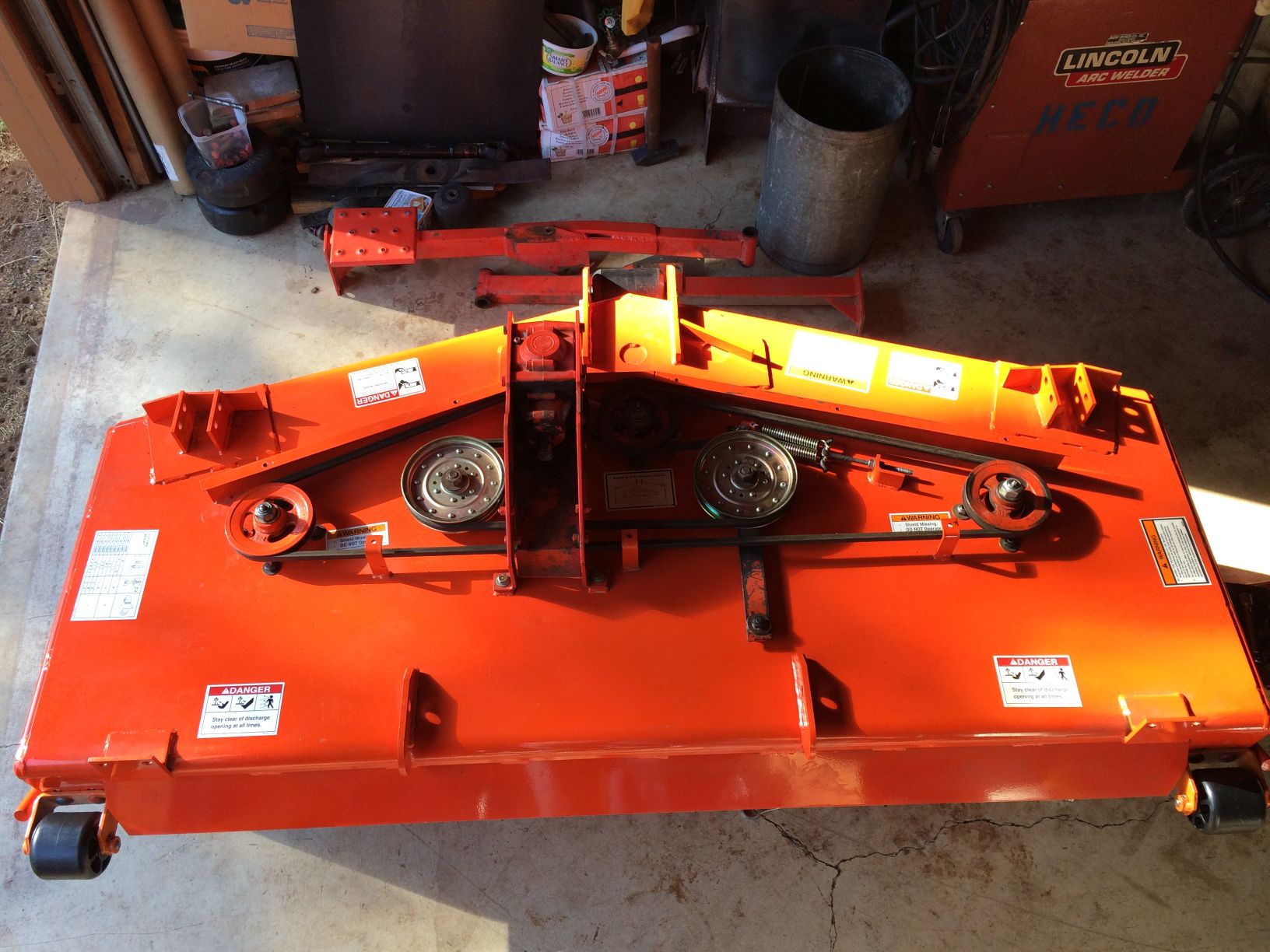

See a photo of my 72" replacement deck shell being worked on:
   / My New Kubota ZD1211 Mower #184
I’d be removing that :D
