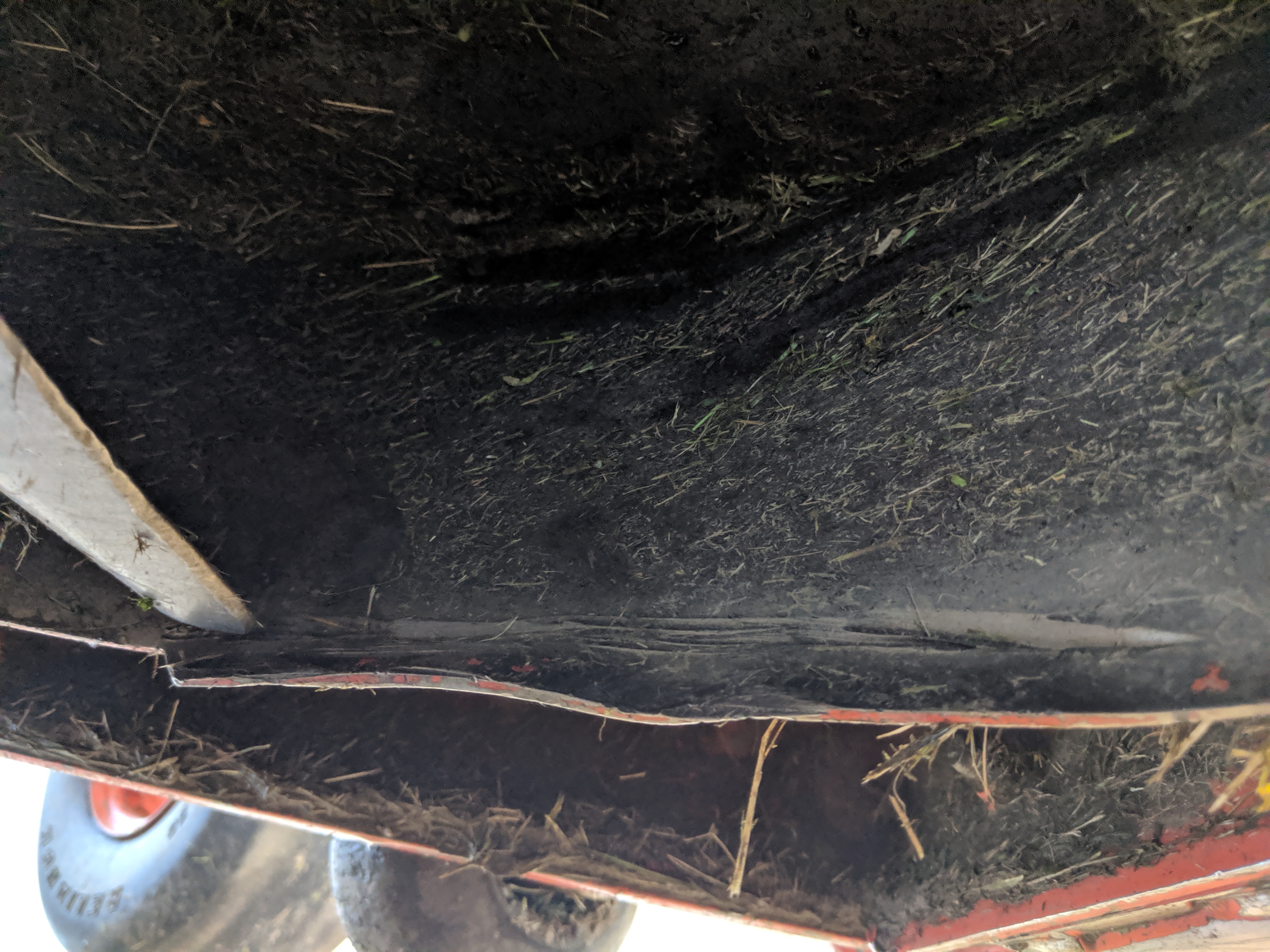

On the 70R deck, the shroud around the right blade protrudes below the front edge of the deck. This shroud got bent on a tree root when the deck cleared. Right blade started a metallic banging with sparks.
This right shroud is 1/2" lower in the middle from the other shrouds.
I might just trim it off, but it's there for some unknown reason.
Blade marking from hitting shroud
Front view of shroud tab
   / My New Kubota ZD1211 Mower #173
I’d beat it back outta the way with a 3lb hammer.
