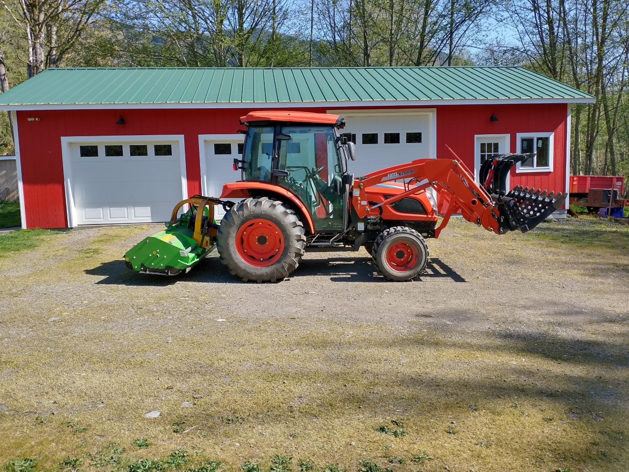

I'm sorry your having issues with the fittings on the top link, so if I understand right you can't install the second 90 due to clearance issues? I will have to double check mine in the morning but I'm almost positive mine had clearance, not much but just enough.
   / My NX5510H
#145
country, the JIC end of the elbow will hit the other fitting, which keeps it from being able to be tightened down. I don't think I'm doing anything wrong: I wish I were and I could minimize the height of the stack. A single fitting solution -longer elbow that's BSPP to JIC- is $36! These two fittings from TSC were $12. If I don't like the look/function of them I'll break down and shell out for the $36 fitting.
Regarding hoses, what's people's opinions on whether to put a protective sleeve on the hoses? I'm kind of thinking I might do this for in the back. Contemplating on it for the extra hoses that I'll be getting for the 3rd function on the FEL (just on the FEL side, not from the rear to the bulkhead connector at the FEL connection).
   / My NX5510H #146
Ok I am defiantly going to have to look at mine tomorrow on the clearance issue. Before I bought a 36 dollar fitting I'd look at getting a bspp to jic straight and then a jic male to jic female swivel 90 that would be about 7 dollars. Not sure the long fitting you posted about would be tall enough even to clear would it?
   / My NX5510H
#147
I was trying to find something local (w/o a lot of effort).
I'm unable to find a fixed BSP male to JIC female, but, this combo achieves the same thing:
9021 | BSPP x Female SAE 37° Flare (JIC) Swivel (item # 9021-06-06)
2500-06-06 | 3/8" JIC Male x 3/8" JIC Male 90°
Key is how much height the swivel piece gives, whether it gets it up above the ~ 1 inch mark (of the other port's installed fittings).
Here's that $36 long 90 (no mention of dimensions- would be a gamble):
9059L | SAE 37° Flare (JIC) x BSPP Adjustable 90º Long Elbow
   / My NX5510H #148
Yes those fittings would work just as well also. I looked at the link for that long fitting and also couldn't find dimensions.
   / My NX5510H
#149
Tractor was returned late yesterday (I wasn't at home). No word yet as to what was done. Forecast shows 1" of rain for today in which case that should be a pretty good test of whether the cab is in fact sealed up now.
Won't be able to get around to installing the cameras and monitor, as well as the hydraulic top link, for another week.
   / My NX5510H
#150
Can anyone suggest a suitable hose to use for mocking-up running hydraulic lines to the FEL (from rear remotes)?
