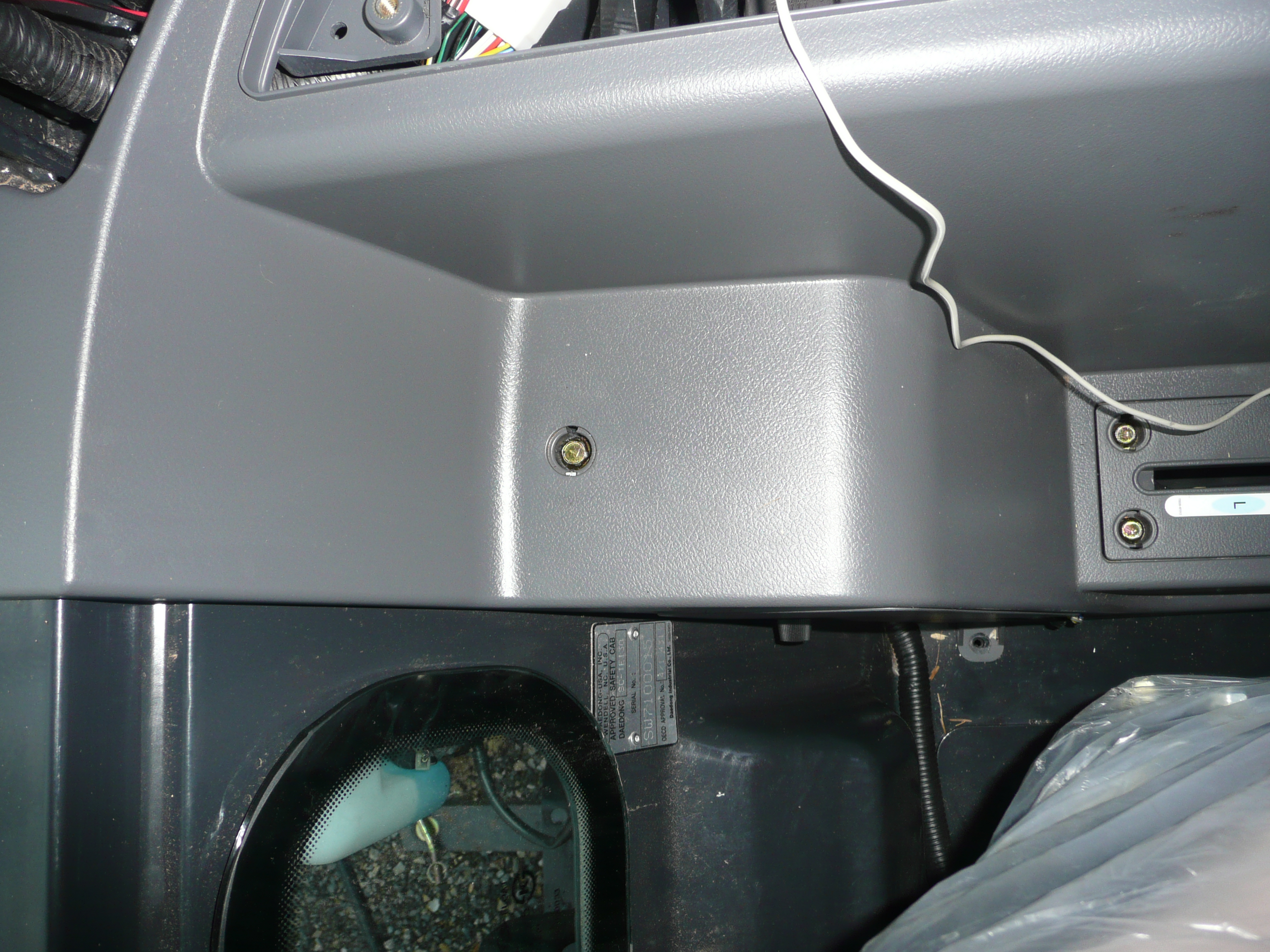

In the process of installing my cameras and monitor.
Can anyone tell me what it takes to remove these bolts:
Removed all the others except those. Can't get any of my sockets down in the recessed plastic!
Is this the channel that folks are referring to for running the cable from the monitor (back to the fuse box)?

OK, success in locating something to remove those recessed bolts: had a cheap-o screwdriver bit set that had some sockets and a 1/4" adapter for a socket wrench. :thumbsup:

1/4" 10MM socket with a six inch extension on my Panasonic drill driver set on its lowest setting.
Anyway, 10mm socket.
If your sockets are too fat, hit one with a grinder to shave it down.

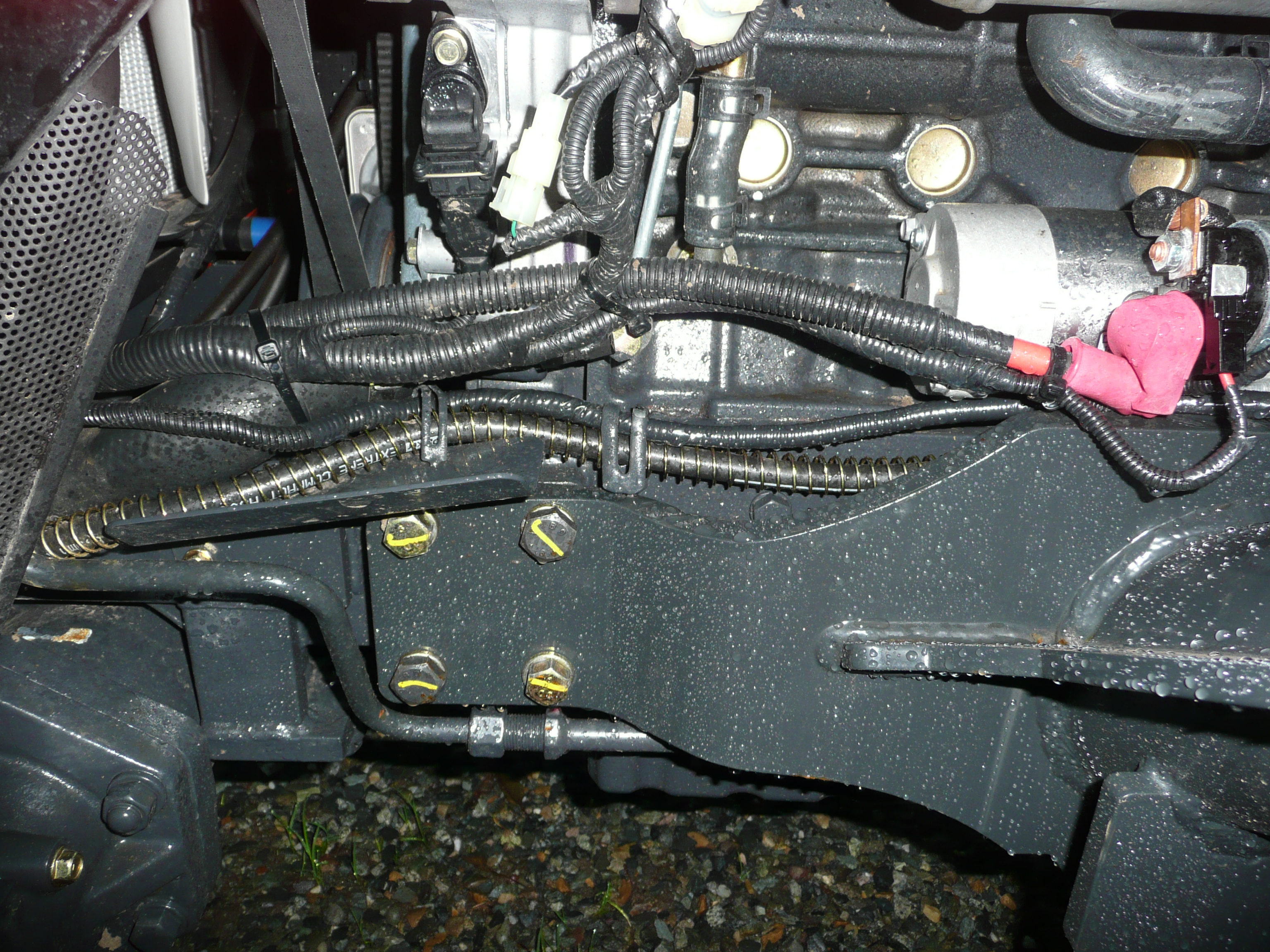

Also wanted to note that I measured for hoses for my 3rd function, from rear remotes to FEL. Going to route on the LEFT side of the tractor/loader, mimicking the FEL hoses on the RIGHT side- the flex loop and I am also figuring in for a bulkhead connection at the loader attachment point. Being just on the generous side I get:
7' 9" from top rear remote (will be 90 degree facing/routing left) to the loader attachment point
10' 8" from the loader attachment point to about the middle of the torque tube (I may keep it shifted to the outboard side)
Probably can take off a couple of inches from each for the length of fittings.

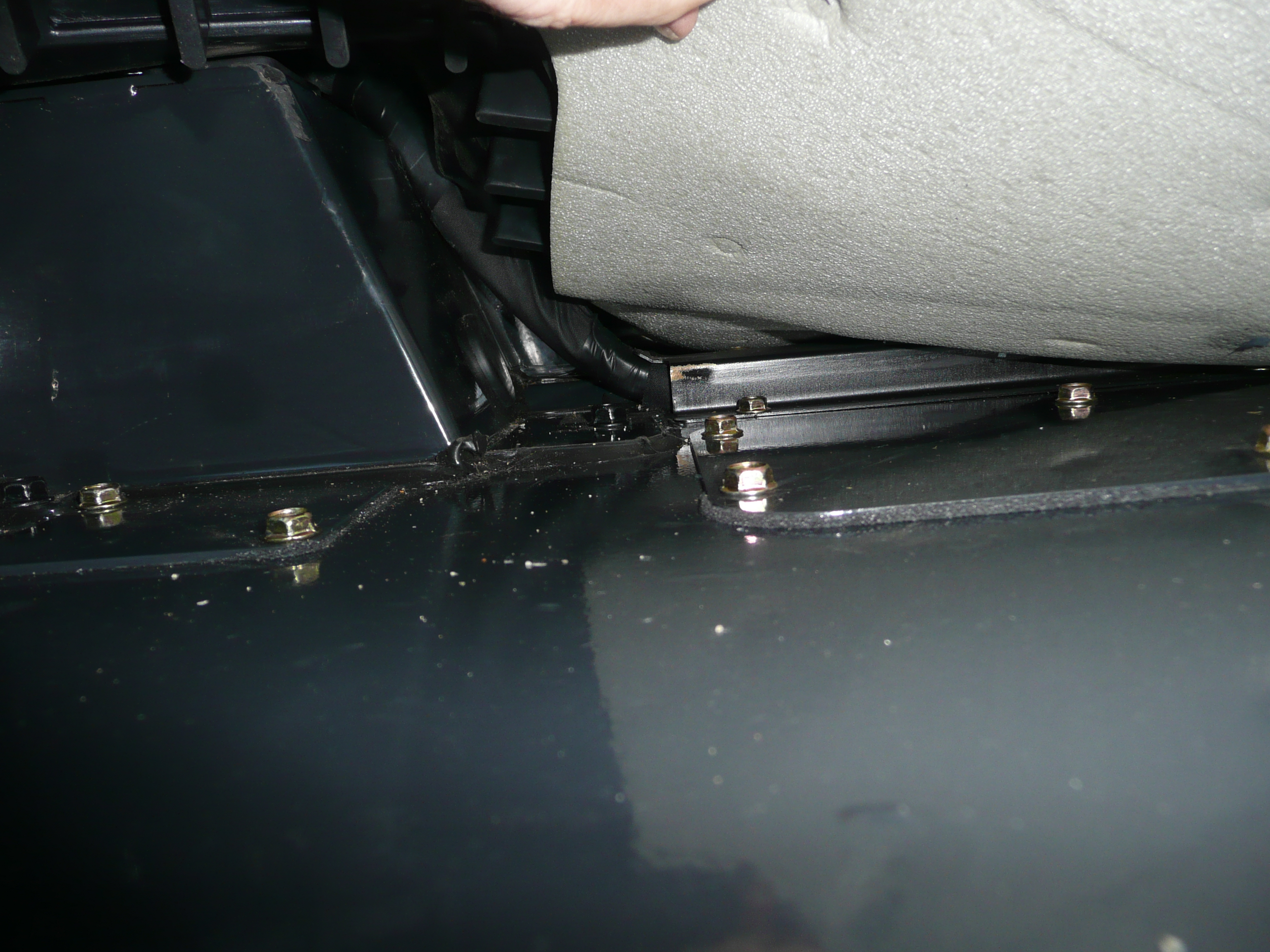

Hydraulic stuff ordered. I'm knocking myself for not picking up some sleeve material: I might look to get it before I install things. The hose has a higher abrasion rating, so maybe that will be good enough.
So, when I was mucking about with installing my cameras I discovered that prying the cap top up required, well, PRYING! I'd removed all the nuts and was just looking to bump up the rear part of the cab. I e-mailed the dealer and asked if they RTV'd the cab top in order to rectify the leak. They DID! :thumbdown: So, now if I have to go to remove the top I'm facing battling with RTV.

Got the monitor installed and the cameras. Waiting to get an RCA barrel jack to make the video connection for the rear camera.
Front camera - notice the high tech mounting solution- electrical tape! :D It's off center a bit. When I determine what location is best for viewing my pallet fork work I'll make things more permanent.
Tried being fairly tidy with the wiring. Ran the front stuff through a piece of loom I had kicking around (and taped it up). I ran the wires/cables through the grommet that runs up under the radiator (though no loom through there). Wires are then just laying inside the battery box area and then out along where the hood closes and up and along the brush guard.
Rear camera was mounted under the rear lip of the cab top. It's currently dangling there. I wasn't sure if the angle would work, so no permanent mount yet. I'll likely tape it first to check.

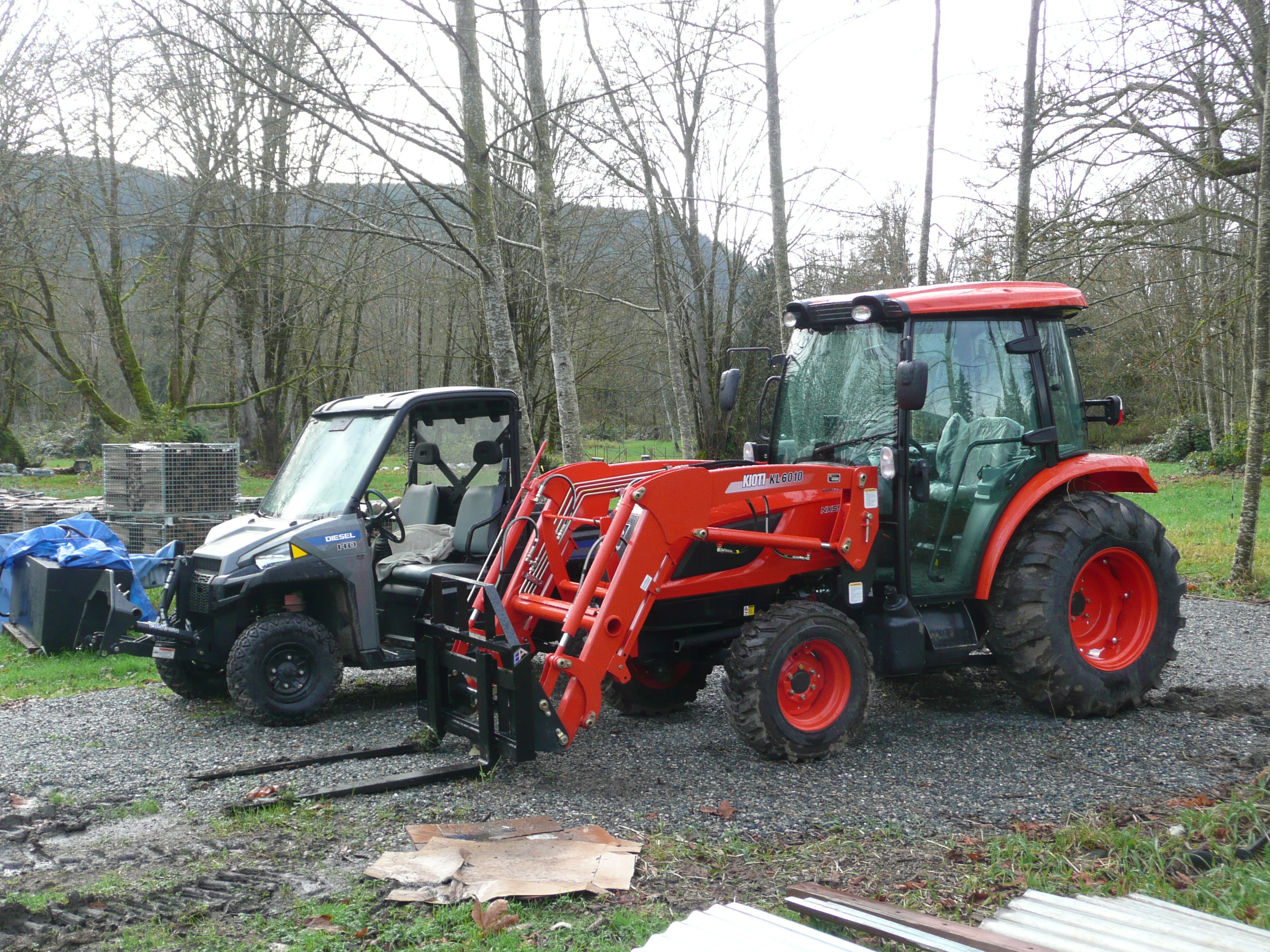

Not much happening on the tractor front. Attached the pallet forks and moved a pallet of wood up to the house. First use of the new camera/monitor set up; I didn't have a very good angle of view- need to work on, probably opt for increasing cable length and doing temporary camera mounts (use magnetic base).
Showed the wife why all the fuss with this camera stuff. Having her sit behind the wheel allowed her to "get it."
Tractor and Polaris are currently parked side by side and I thought I'd grab some pictures of them after noticing how much smaller the front profile of the tractor is with the bucket off (had the pallet forks on).
For some reason I thought I'd bought a bigger tractor.
Oh! Now I see it!
Does this Polaris make my rear look big? :laughing:
