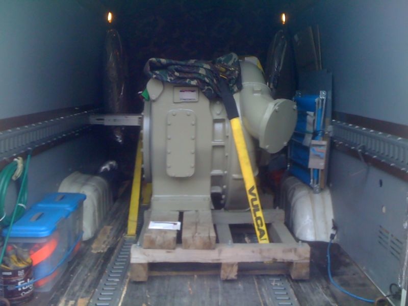

who says big turbo's are only for diesels
Big ? .... you call that big ? <snort>
.... now this is a big turbo (about 1900 lbs. big :D):
/ my other adiction! #7
Seriously though .... nice TIG job ;)
