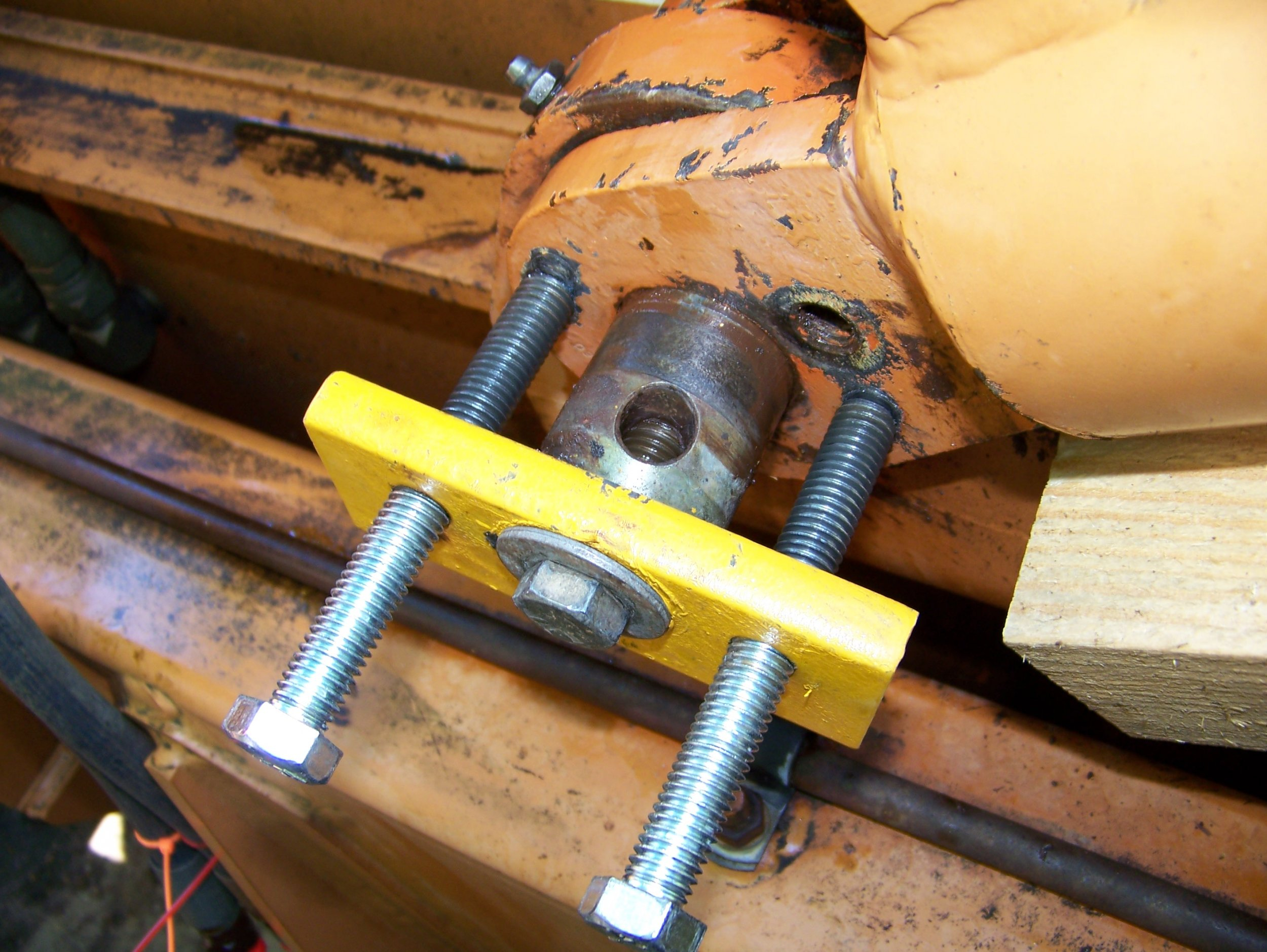

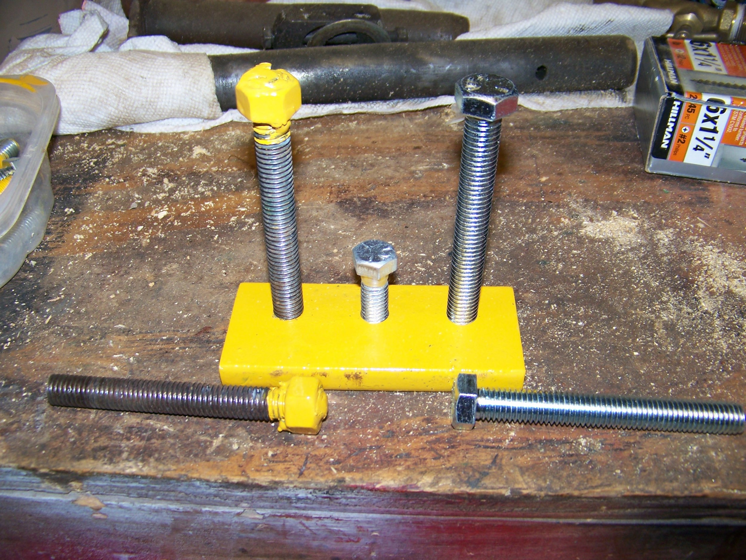

I made a pin puller for the Lull's two slave cylinder 4 pins.
The cylinders need to be rebuilt. I could have repacked them myself, but I suspect something funny going on inside them and I want the experts to look at them.

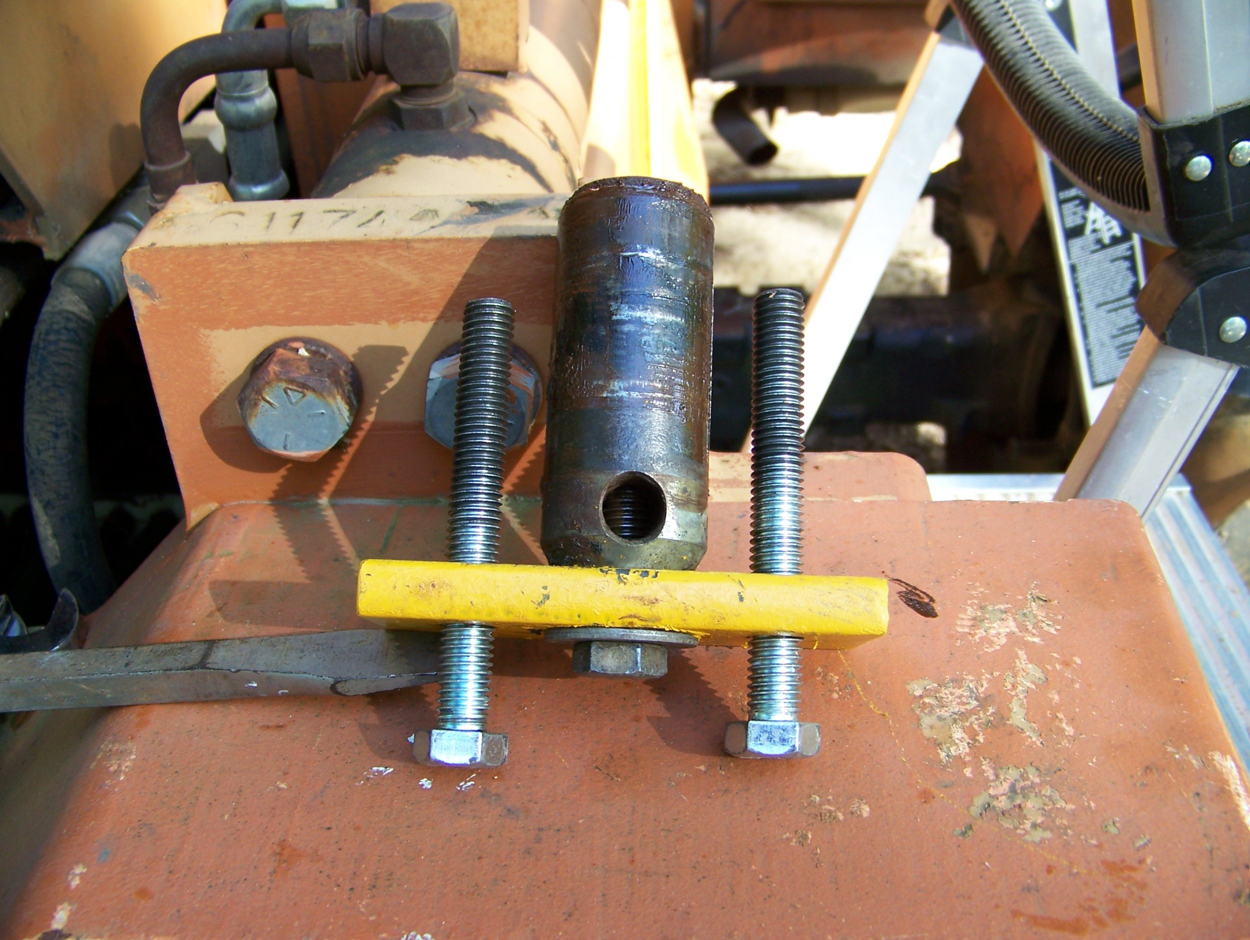

I got 3 of the pins out Sunday.
But one pin didn't want to leave it's nest. It was stuck in the swivel.
Today I spent 5 hours putting tension on it, hammering on the swivel bearing, then hammering the pin back in. It started moving so slowly, I took my 100ths scale out to measure the movement.
Finally, I had it out 8/10ths of an inch.
Then success.

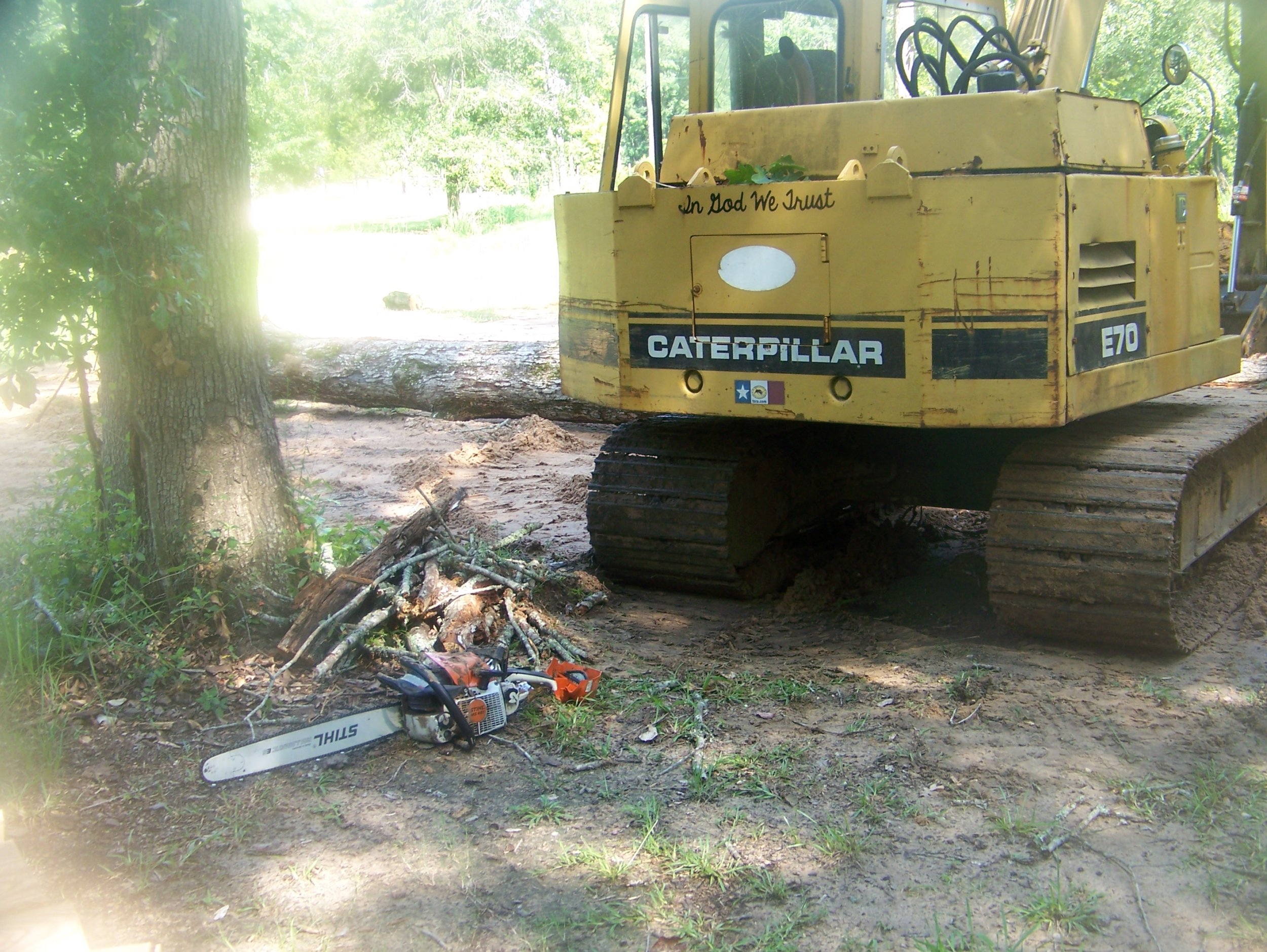

I got up at daylight this morning to dig in the shade. Got the tree pushed over and cut the log off. With the Mahindra down for a head gasket, I tried to lift the log with the excavator and sit it on 4x6s, to cut later. All was fine until I moved to the butt end and lift it. I backed into position to lift it and realized I had backed over my Stihl chain saw.
After I moved the crushed saw and the CAT, I brought the Lull in and she lifted the 32 foot log with ease and took it to my hardwood stack and parked the log there to cut later into trailer decking.

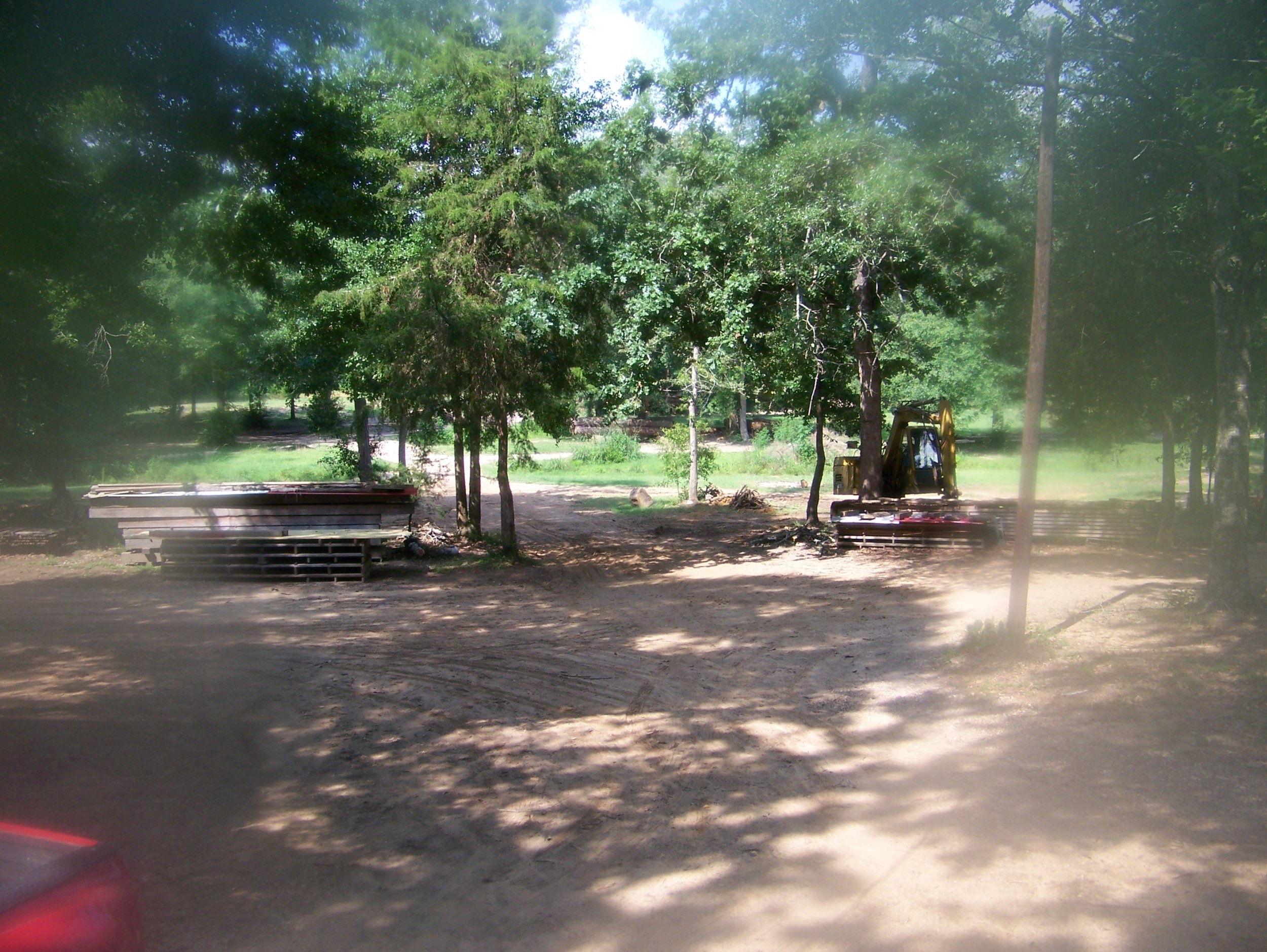

..............and the White Oak is gone!
