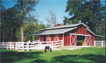

Flatheadyoungin said:
Well, I think you just solved a problem for me. I've been trying to figure out how to build my next garage/barn with two lean tos and with some style.
That barn looks great!
Thanks for all of the pics, when I get home, I'll have to save them all!
Flatheadyoungin,
Thanks.:) Imitation is the highest form of flattery!:D I modeled my barn after the one in the photo.:cool: It is fancier, but has a shed on the far side. Look back through this thread and you will see a drawing of the roof trusses, which gives the barn the 1 foot high full length ridge vent.;)
hugs, Brandi
