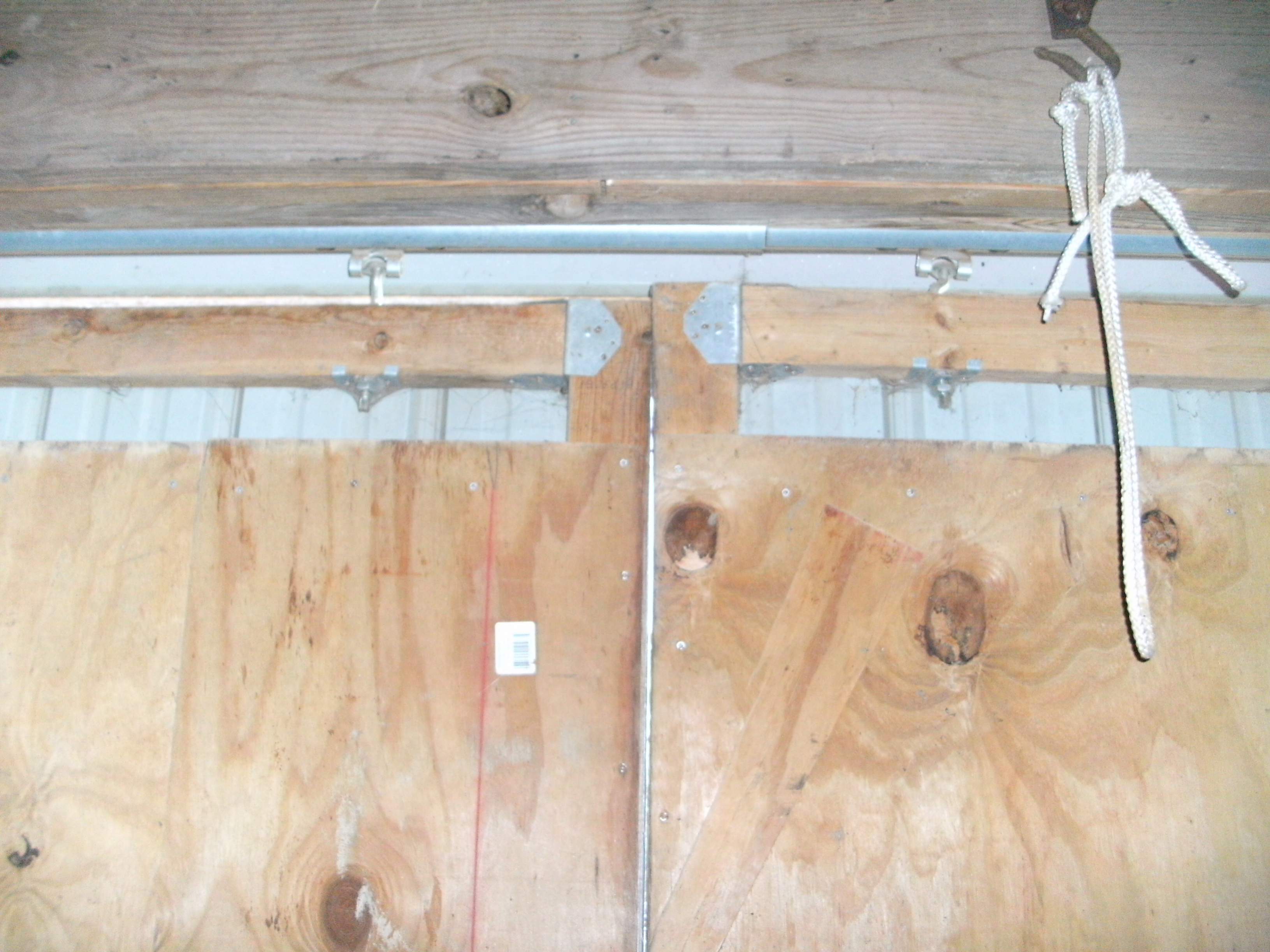

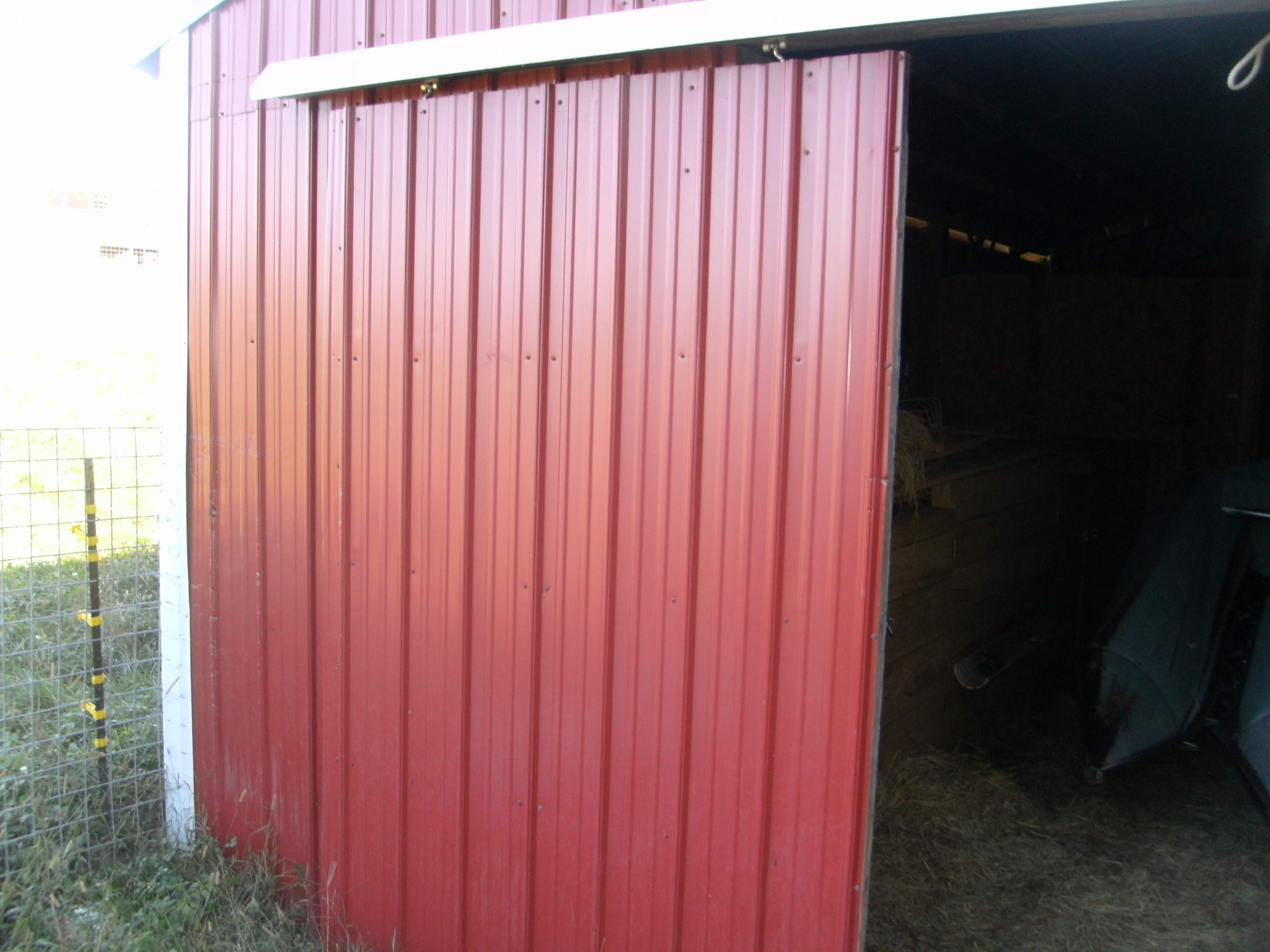

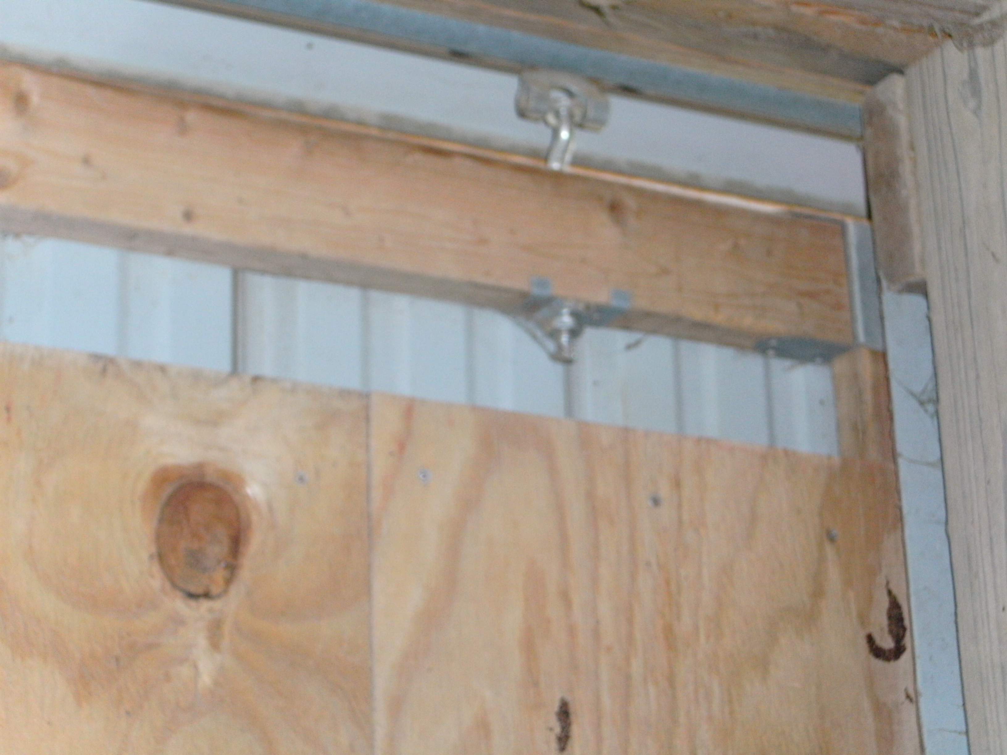

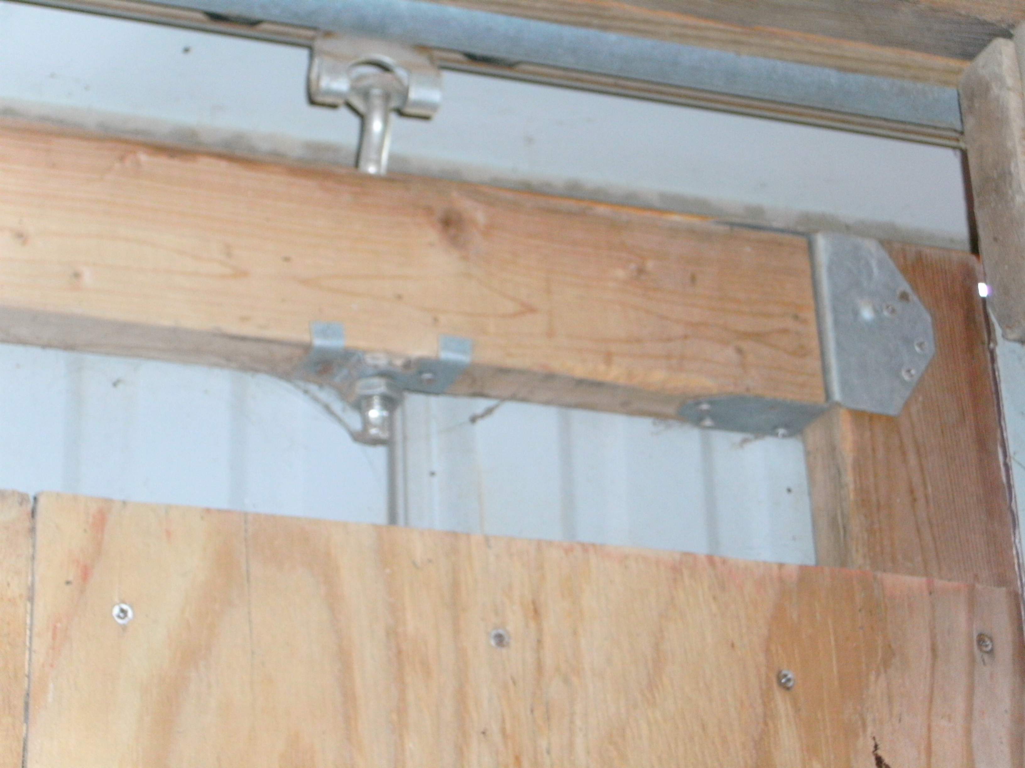

Brandi,
I built my doors the way a local company that builds pole barns and chicken houses builds their sliding doors.
1. Lay 2x4's flat on the ground. You don't want the door real thick, so you'll be looking at the flat "wide" side of the 2x4.
2. I bought metal corner braces. You'll see in the pictures.
3. I put a 2x4 around the outside and one every 2' on center top to bottom (Across the door). That was you had something to screw the tin and plywood to.
4. Sheath the whole inside of the door with 1/2" or 1/4" plywood, but leave a gap at the top to get to the adjusting hardware.
5. If you'll have help ( 1 person) and use The Big Red Beast to hang the doors, I would go ahead and put the outside tin on the doors before installing them.
Here are the pics:

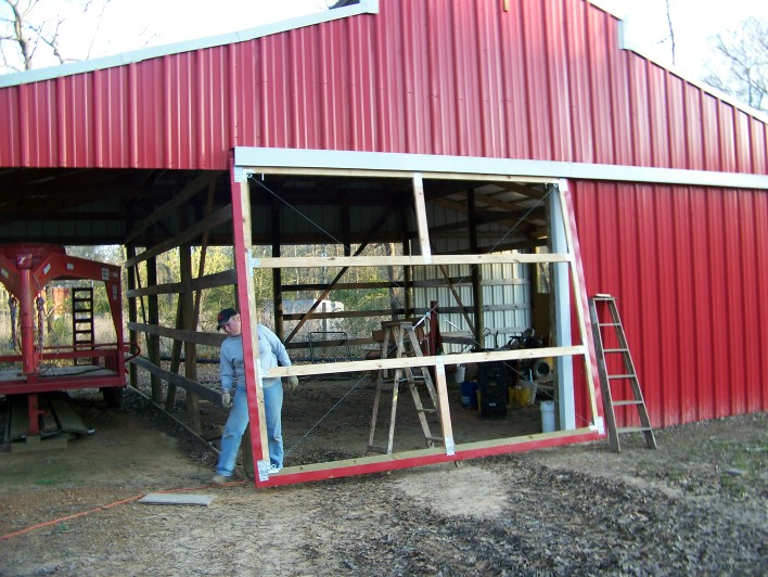

Luke and I hung the frame of the barn door last Saturday. It was easier than I thought. I hung it to get dimensions for brackets under the door to roll on when opening and closing. I will hang metal after final hanging of the door. Look close and you will see the "X" bracing wire that really works to put the frame square.
It has almost had no work on it the last two years while taking care Mom and Dad and their estate, but now I have some cash to finish it. It was two years ago, February, I started the siding. So now the door with it's checkboard siding will be finished soon!
hugs, Brandi
