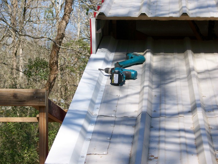

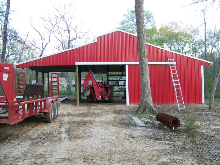

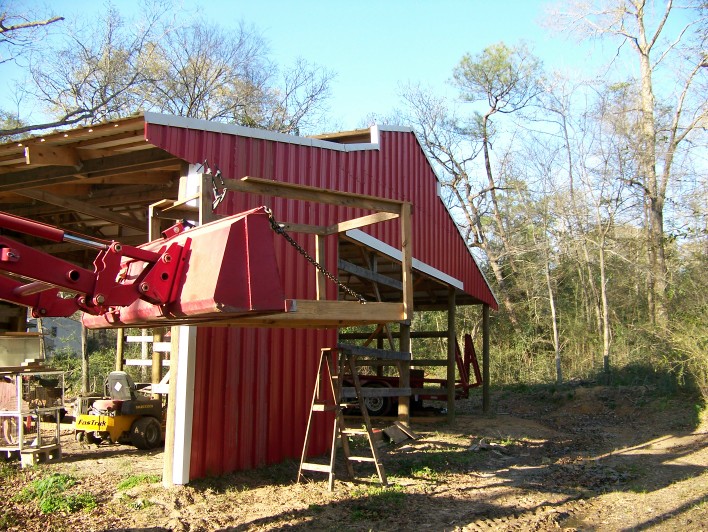

I got enough siding up so I could install all the roof edge trim.:) My choice of treated 6" diameter poles instead of 6x6 treated timbers came back to haunt me again.:eek: Three of the four roof edges needed to have the roof metal cut at the edge and a piece of metal with a ridge spliced near the edge. But anyway, the up high outside work is done.:cool: I can now disassemble the wooden work platform. It worked well. I did have to clamp my step ladder to the railing to work the upper ridge peak.

In your last post, the last of the three pictures shows your gooseneck with 4 chairs on it, was that for your audience to watch you as you work?:D
You have done a terrific job!!
   / My pole barn...a solo affair
#108
Deereguy,
Thanks! I just knew someone would fall for that "hook" and ask a question.;) I just didn't realize it would be so fast!:rolleyes: No, they were given to me and I don't like them, but feel bad about just burning them.:eek: So the trailer is as far as they have got before I give them away. I had to pull the trailer out to have access to the 15 foot long roofing metal I have stacked under the trailer. You can have them if you come pick them up.:rolleyes: The only people that come watch are Mom and Dad.:cool: They get the preferred seating.........lawn chairs in the shade of the barn. Booger usually is the the only one around.:D But he is either chasing squirrels or wants to play ball. Nice and peaceful and full of solitude.:cool: Good therapy after a hectic work week!
