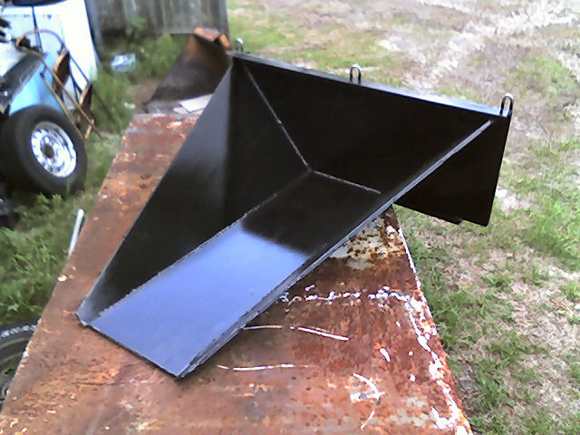

I've been looking for something like this, and have just about settled on this model. The videos on the WEB site show it on a skid steer, and it looked pretty impressive.
I have a JD 2130 2WD with a Woods 1020 FEL with a Bobcat type quick attachment. The tractor weighs about 6000 pounds. I would be using it mainly to dig holes for planting B&B trees that will need a hole about 4 feet diameter by 2 feet deep. My soil is mixed sand and clay with some small rocks.
For the first batch I rented a Bobcat 331; it worked great and sure was fun. But I think would rather have my own equipment. if this would do the job.
I also wonder if it would be stout enough to try to get up some sweet gum stumps.
Too bad I don't have the skills to build it myself, like some of you have done.
Thanks
Charles
I've never come close to deforming it. it'll dig your holes all day long, no problem. Popping out stumps might require a bit moer abuse, but I'd have zero hesistation about it.
The largest hole I've dug was for a 54" root ball. The hole was 7'X4'. Minimal shovel work to clean it all up. Hardest part was getting the Willow Oak into place by myself.

I think that settles it. This is what I will order.
One question: I assume that for digging large holes, you just dig one scoop, move around a little, dig another, etc. Is that the technique you use?
If you're doing a row, like a wind break, then you just jam it in at the appropriate angle (45 deg-ish) plunge it all the way down, and reverse it out cleanly, then drive forward to the next spot and repeat. Then you turn around and come back down the row start popping the plugs out. It takes some practice, but you can get some clean holes. If you don't come at if from opposite side, and try to pop it on the fist try, the hole will be a mess for a smaller 24-36" root balls.
For my really big hole, I just went at it. There was no real technique. Lots of trips out of the "yard" to remove the spoil. Of which there was plenty.

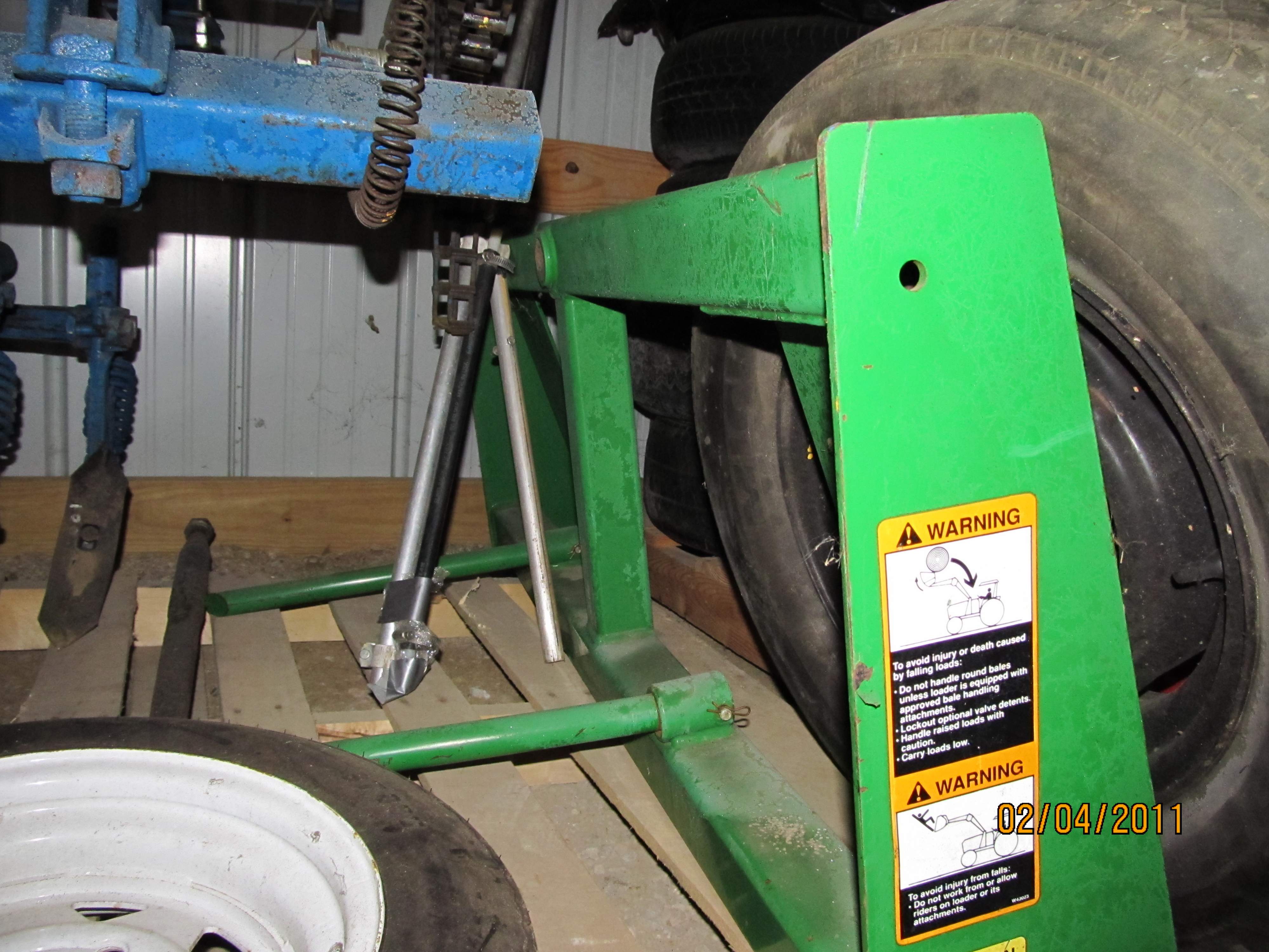

I have a 75HP Deere 5520 4WD tractor with a QT loader. I also have a Deere QT bale spear and bracket that I would like to use and nount the scoop to. It is very rugged and gives me dual use for less money. A grainy photo from my cluttered barn is attached and hard to see but shows a nice flat mounting surface that I can U-bolt clamp my tree spade to. I'm pretty sure this is a good idea but what do you guys think? I just U-bolt clamp the flat mounting surface to the framework of the bale spear bracket.
Questions I have are how thick is the flat steel mounting plate and how big is it? The 45" diameter has been mentioned and does tghat sound right? My bracket is maybe five or six ft wide so any size would fit. Should I go thicker because of my bigger tractor?
Also, what length is the scoop from the bracket to the tip and would it be flat with the bottom of the loader bracket or is it on an angle?
What size trees do you suppose I could move with this? I'm thinking up tp 12 or so feet"
I realize this is a lot of questions and I don't mean to be a bother so any info anyone can offer is good for me. I'm also searching the commercially made spears for clues but you guys can give me more in the way of practical application. Thank you.
Can't get photo to work .

Here is the QT bracket from a side shot. Front of bracket would be to the left.
See how strong it is?

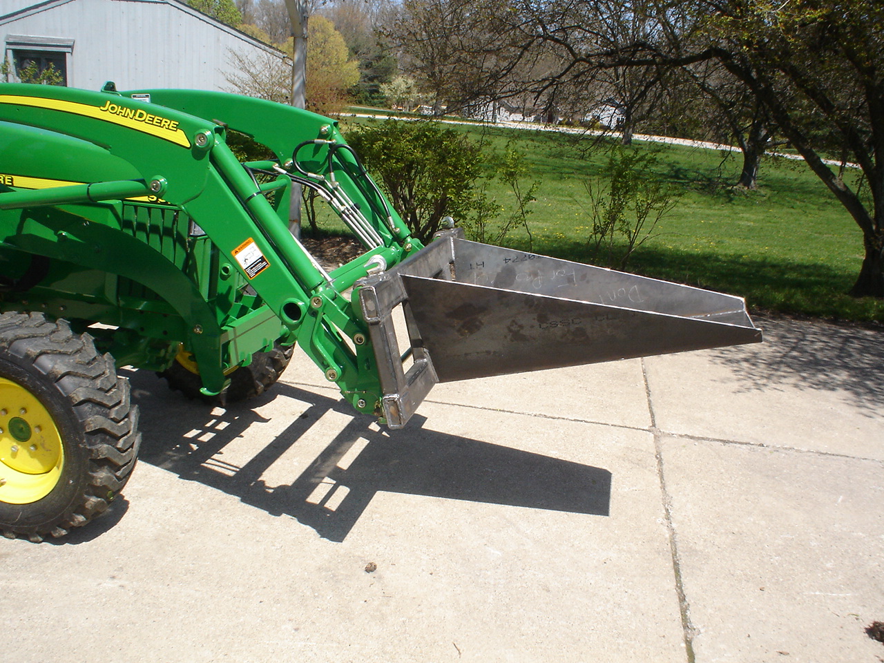

The tree scoop that I have is 3/8 plate. The bottom is flat and about 16 X 48in. The sides go from 2 in at the tip, to about 18 in at the back. The scoop in the green tractor is similar to mine. You can either do flat plate, or have one piece cut and rolled.

Very helpful, JJ.
Thanks.

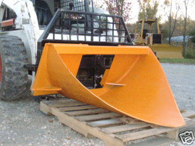

JJ--
Who made the yellow one?
