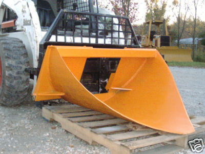

JJ--
Who made the yellow one?
Can't remember. I saw it awhile back, and I saved it for some new ideas. You can make them any size you want. Just use a cad program and lay it out for cutting, and then have them bend it to the shape you want. You can probably bent 1/4 steel plate by driving over the steel on top of a wood frame. Then take a come-a-long and wrap a chain around and bend it to the shape you want. A plasma cutter or torch can shape one fairly quick.

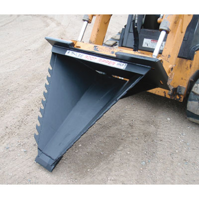

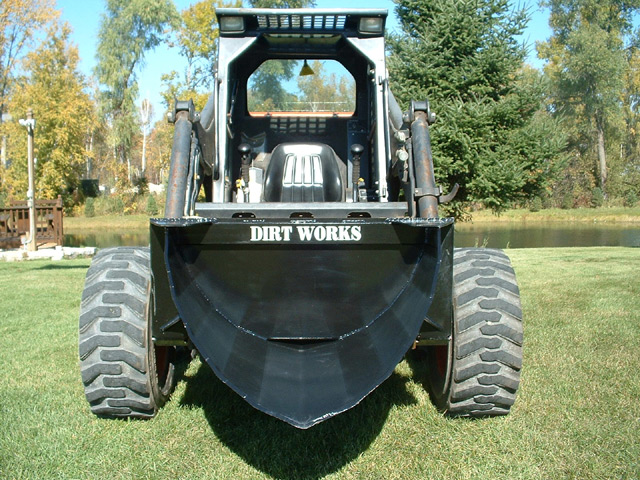

I need a little help here...should I go with the more pointed tip like the black one in the photo or should I go with the more rounded looking tip like the yellow or red ones? Any thoughts or opinions on this?
The black one is commercially designed so it must(?) be de-bugged but the other ones look like they would work better especially in popping trees out of the groumd.
I took some sketches to the welding shop today and am taking my tractor front loader bracket tomorrow for him to get started. Sure, I could weld this myself but it's 1/2" plate and still winter, here. This is cheap money spent.
I'll post pictures along the way but am having the shovel welded on to a plate and then either having QT loader brackets welded to that plate OR U-bolting the plate to a bracket I have that fits my loader QT brackets.
For now, any thoughts or opinion on the shape of the tip of the shovel itself? More pointed or more rounded on the tip portion ?
Thank you.

I noticed the yellow one does not have a sealed back. You dig stuff out, lift up and dirt will fall out the back.
I use my stump bucket for narrow small hole digging jobs and need to carry dirt around or dump dirt...Even use it to hand mix cement, (using a hoe to get the slurry right), and carrying it to where it needs to be worked.
These stump buckets fill a nitch where a regular bucket would be too wide.

The Kubota with the black bucket is my machine. I recommend the slightly flattened tip. This allows the bucket to cut the roots. A sharp tip bucket tends to push the roots to one side or another and not cut. That's my opinion.
