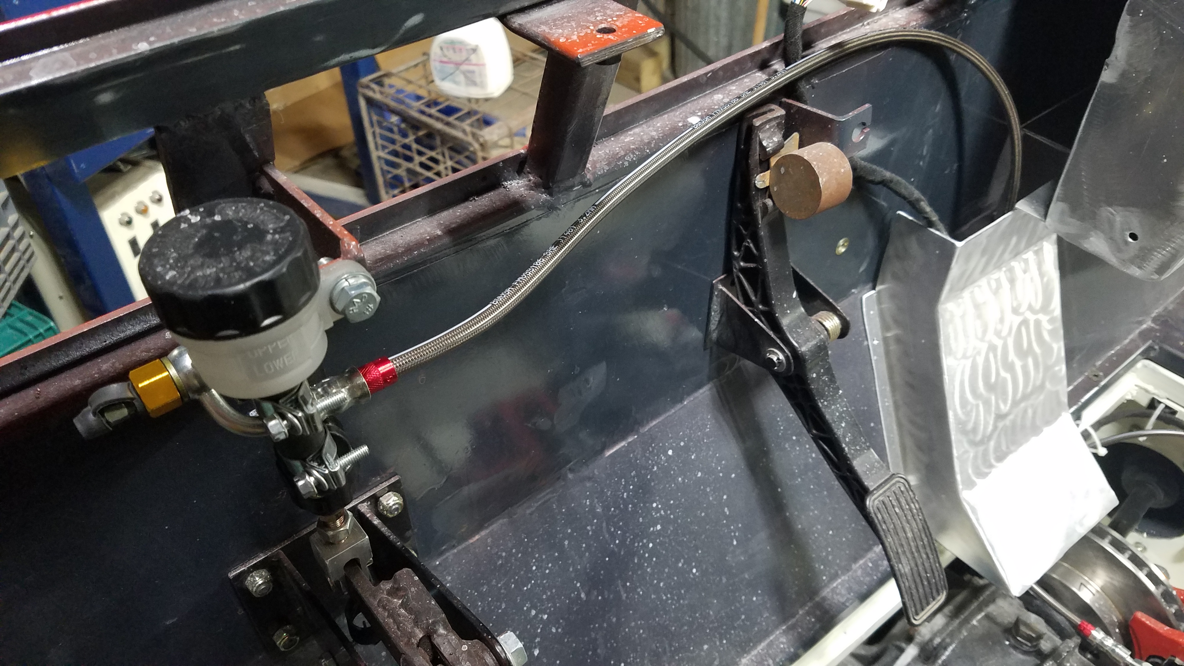

I had some brake lines made up and installed them. I will fill them, bleed them and try them out soon. Working on the tracks and front bumper next.

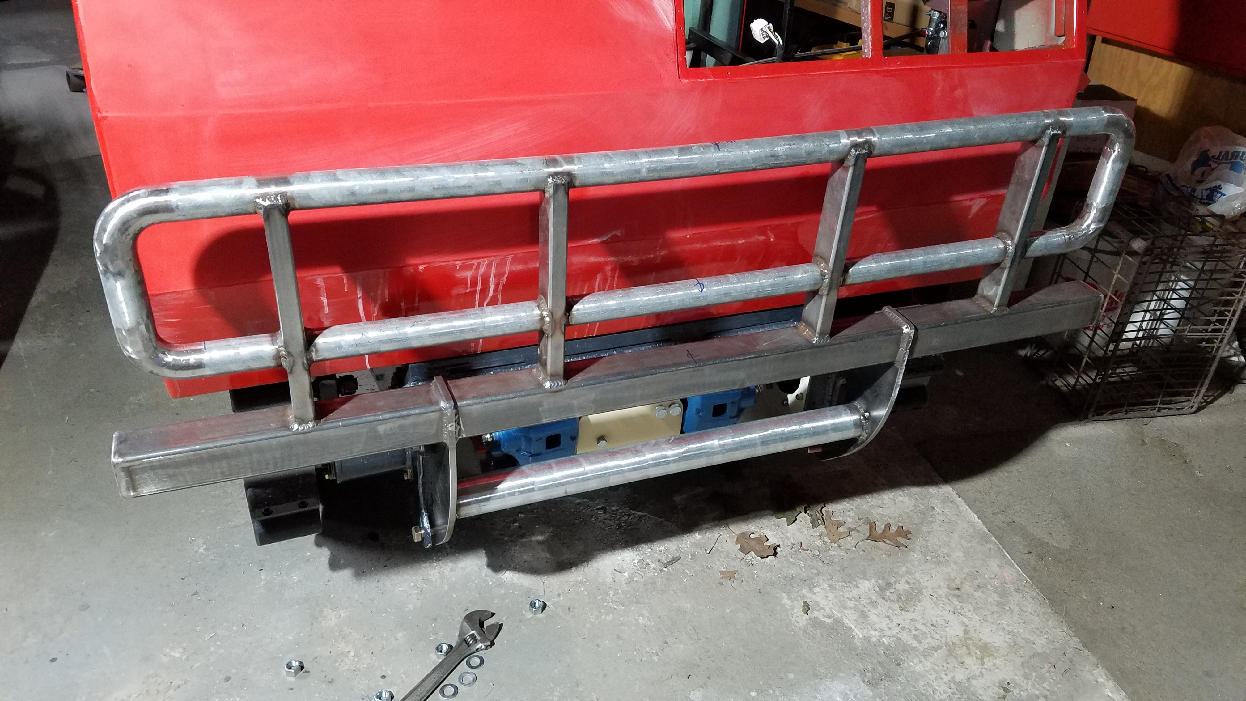

Now this is what they call a bumper: :dance1:

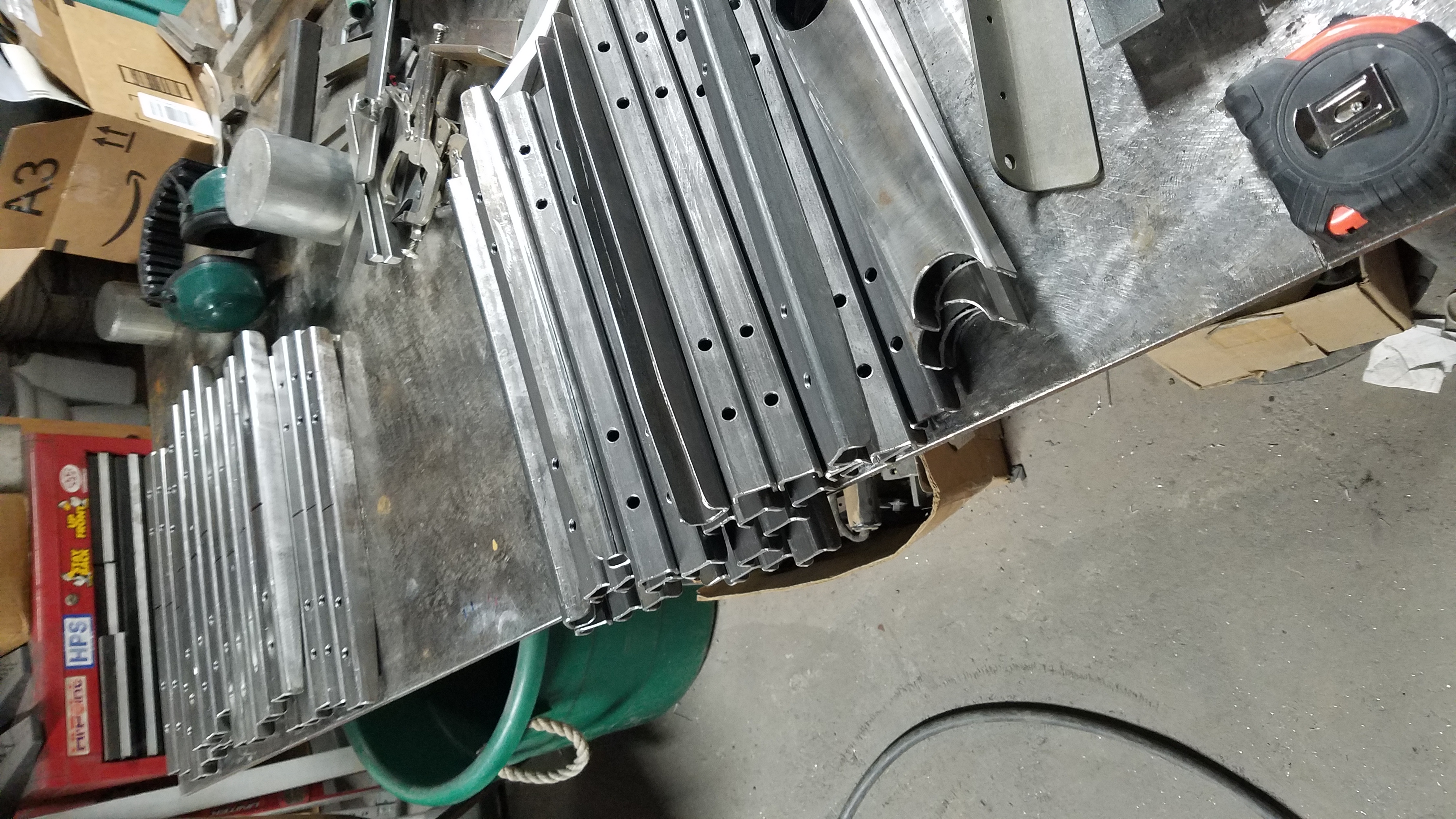

I also made up some track bars:
