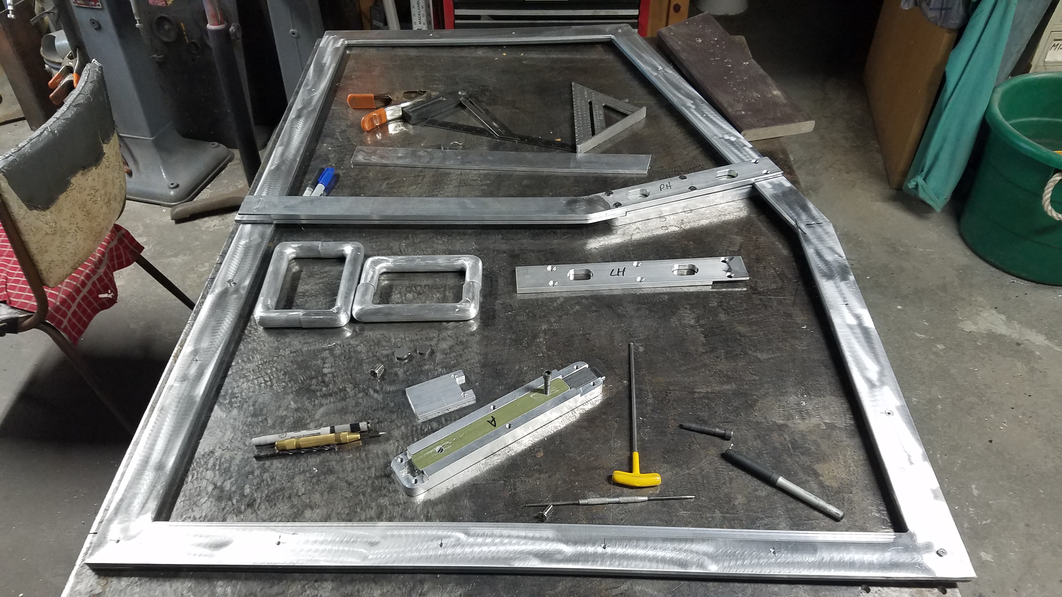

I have actually been busy. The weather has been sucky so I saw no reason to bring Snowzer outside (where it would stay) when I can work on it in my 68F shop. Here's some of the door parts that remained after I created a bunch of chips/shavings.

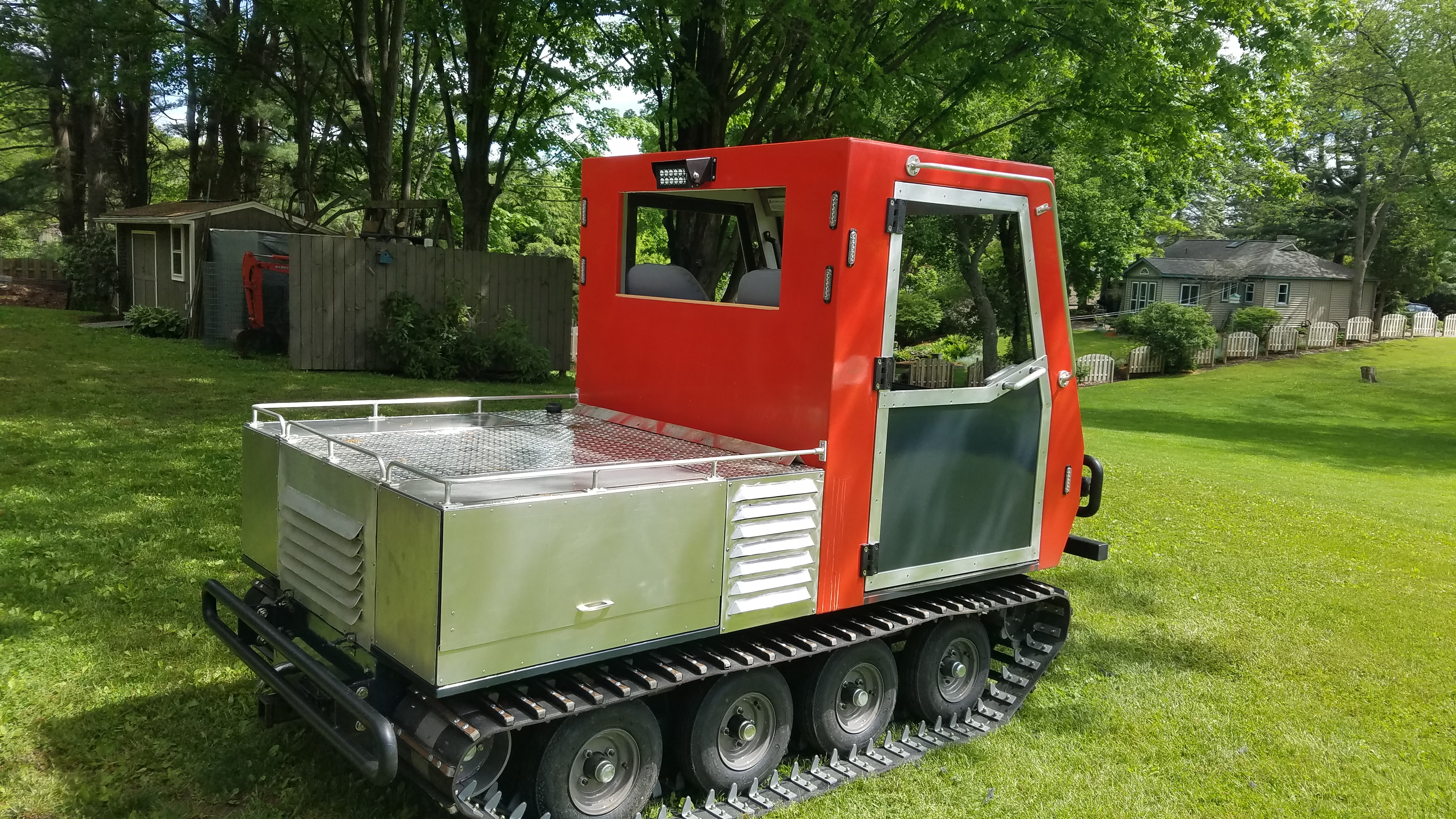

#336
I did get it outside and took a nice photo of it. It runs and goes forward and backward. I still need to work on some issue like it does not steer nor brake well. I guess I need to get more clamp pressure to the brake calipers by probably adding brake boosters. Please offer your suggestions. Also, the track bars are rubbing too hard on the drive sprocket faces - I will need to play with the tooth geometry to lessen this. Once I have it driving around the yard, I will post a movie like the real "Swamp Thing" snowcat. Stay tuned. :dance1:
   / My Senior design project - a "Swamp Thing" tracked vehicle clone #337
If I remember correctly you were using disc brakes for the steering. Add a second caliper to each disc or find a different differential that lets you cut the power to the side that has the brakes applied.
Lowering the center wheels so that the vehicle can pivot on the center tires instead of the whole track would also help.

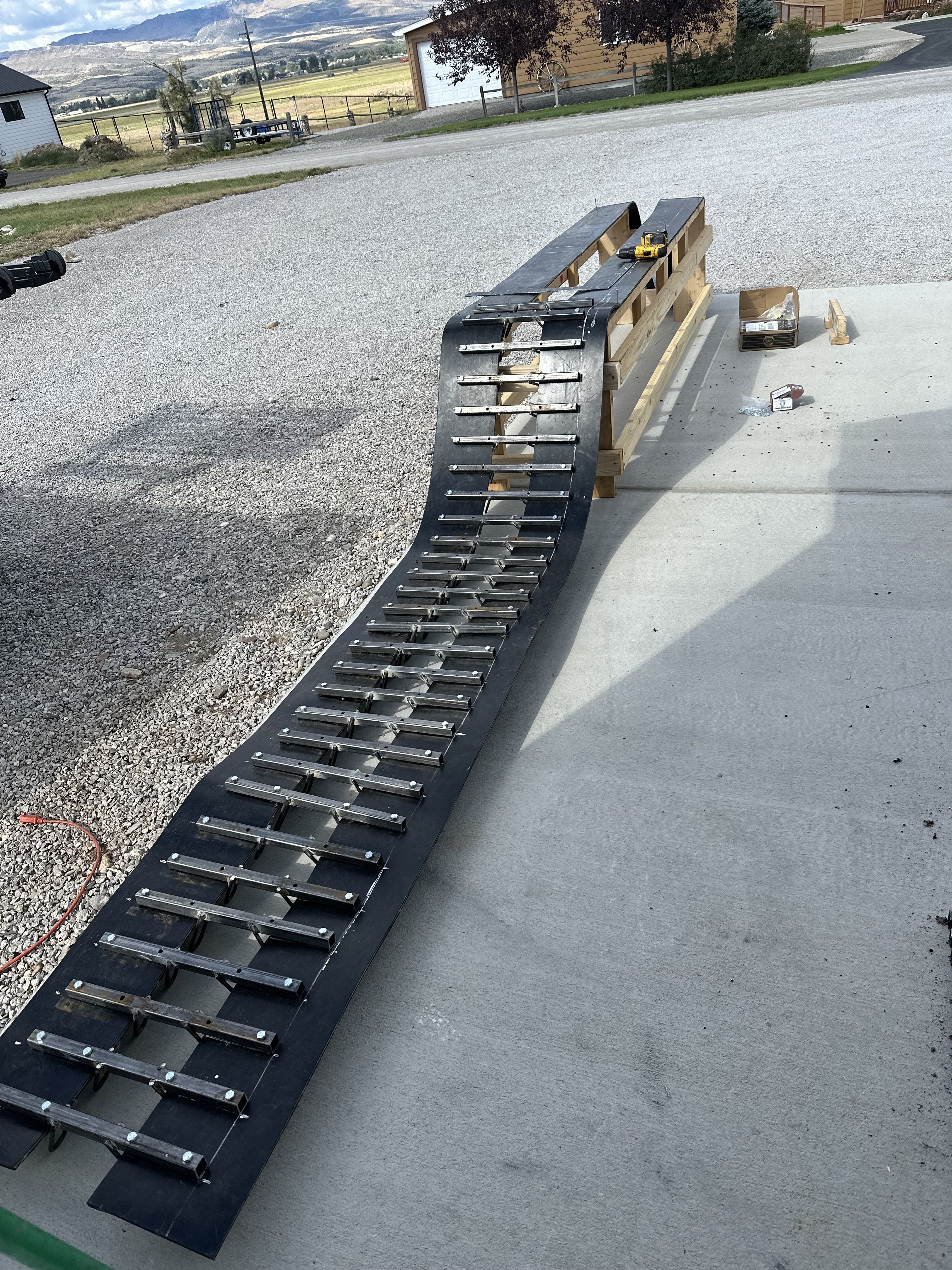

On all the snow machines I've worked on, I've not seen a change in idlers down pressure through the machines length. That doesn't mean that what you suggest might not work, but I haven't seen that done to improve steerage.
I have a second set of calipers installed on each disc. One set is used for the service brake and the other are used for brake steering. The diff is open so I can brake either side for steering.
That would not be feasible as each two wheel set is mounted to a pivoting walking beam.
