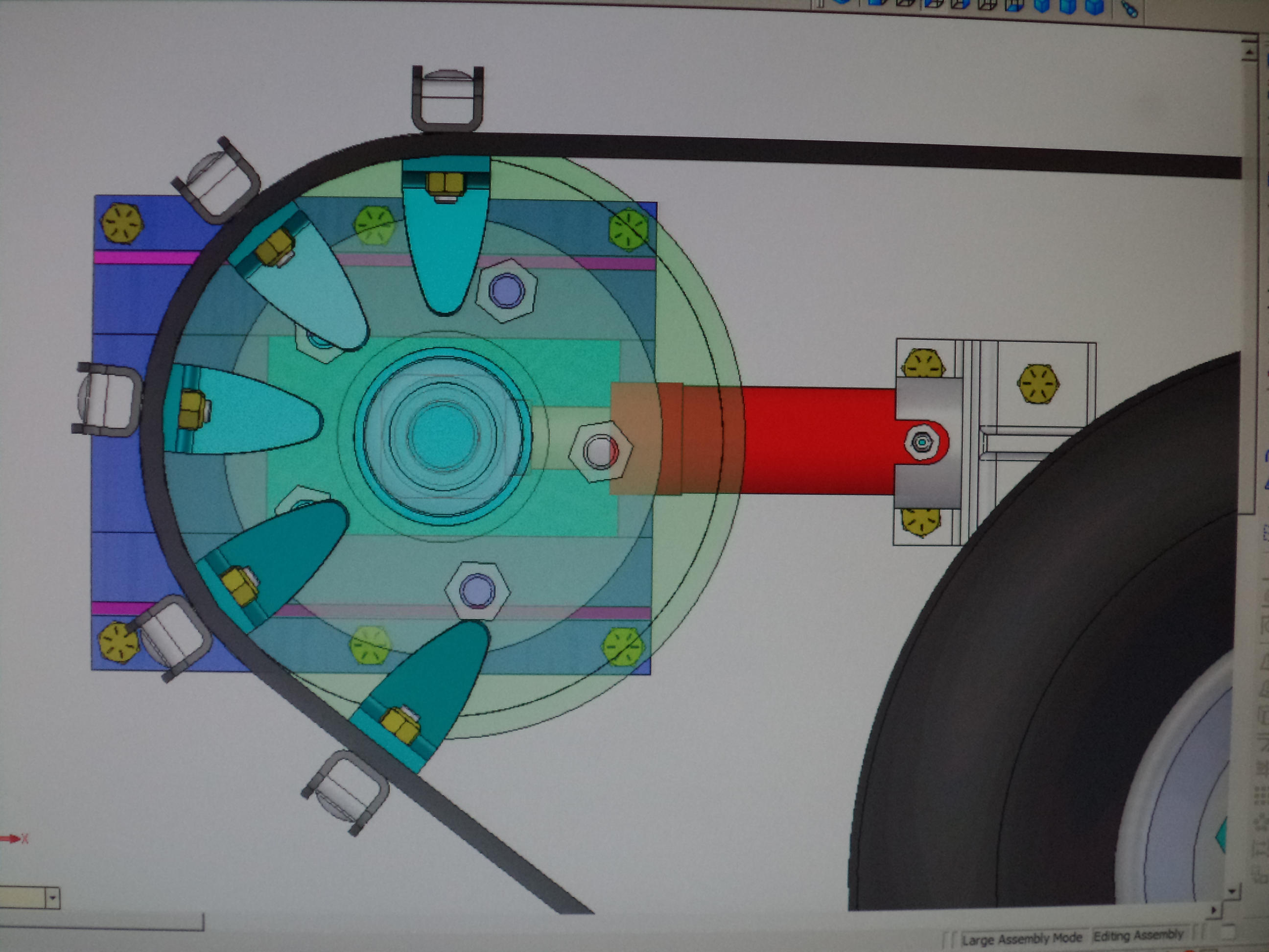

I have a hydraulic Porta-power cylinder that I pressurize with grease to tighten the tracks up. There is no heavy spring used to tension them. Here's a cad image of the rear take-up spool mounted to a slide and the cylinder (red).
   / My Senior design project - a "Swamp Thing" tracked vehicle clone #372
This "grease cylinder" tension system was used by many manufacturers over the years. Subsequently they have been replaced by hydraulic operated ones.

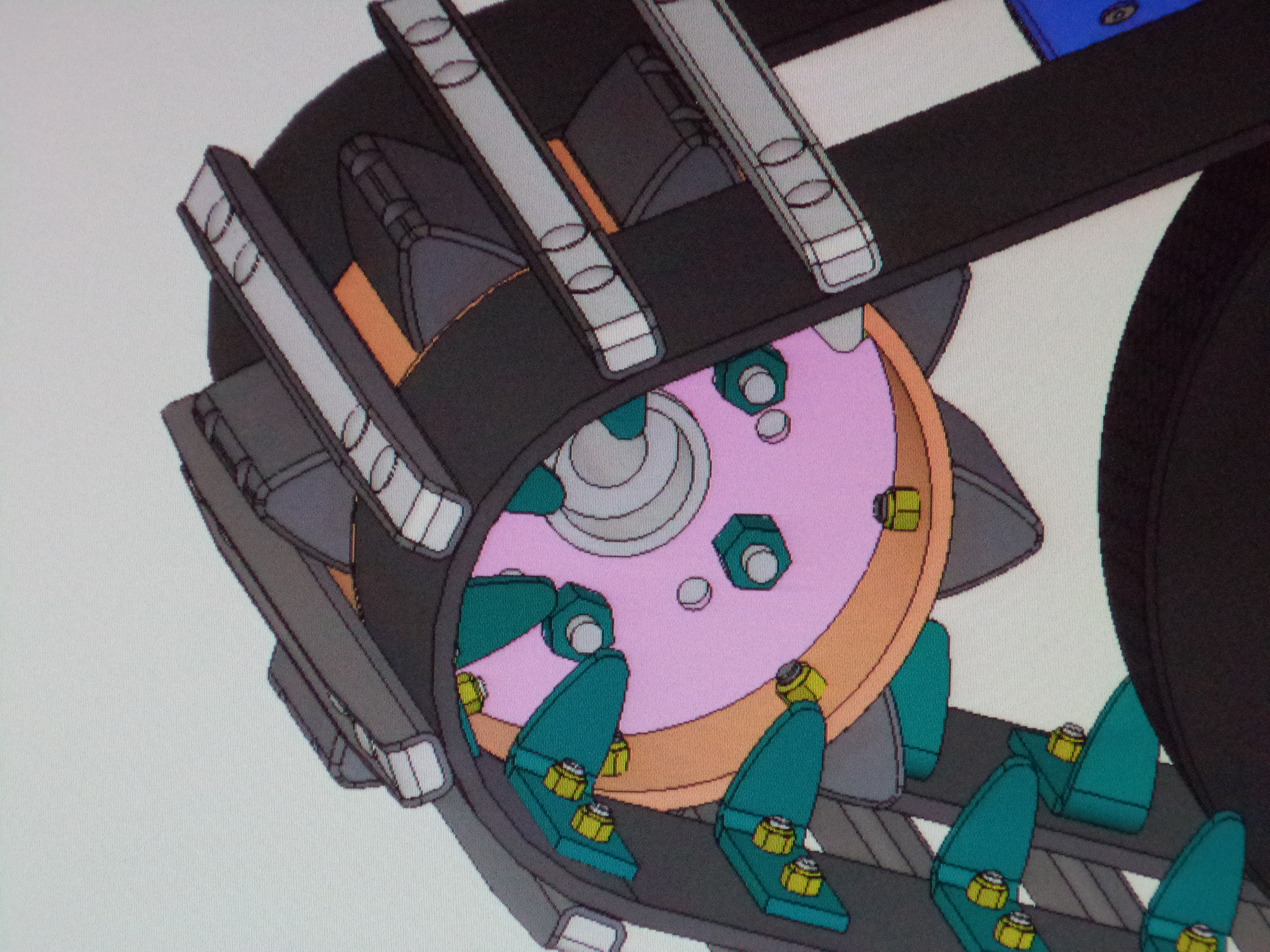

I think your drive sprockets maybe a little wide and not a sharp enough profile. Meaning the resultant force is lifting the cleat off the sprocket instead of pushing the cleat. This force should be fairly straight forward to calculate since you have full drawings. Couple that with potentially under tensioned tracks and that could be why you are getting track slip.
Also increasing diameter of drive sprocket may be very helpful. Just some ideas.

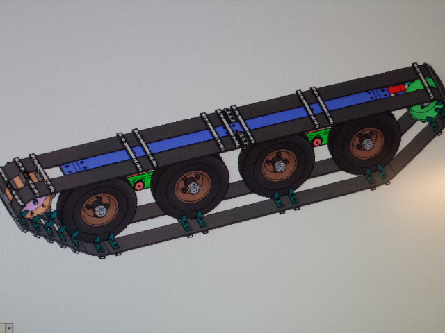

I have developed new higher and sharper tooth profiles and I have the plastic stock in a box. I just have not had the time to make a cutter and mill the new teeth. I am revising the upper track support method. Currently, I have a pair of HDPE blocks that the track bars slide on and I found that the weight of the unsupported track allows it to drop enough where it contacts the ramp on the block rather harshly and thus, causes a lot of chatter. You can hear it in the video when I am traveling straight. I plan to use a long 72" steel plate onto which a 3/8" thick strip of HDPE is attached to support the top track. There will be a minimal gap between the drive and take-up spools and the new support. A 5 degree slope on each end will gently allow the track bars to approach the plastic strip. Here's an image of the design with the UHMW strip shown in blue. I have my fingers crossed that this will be substantially quieter.

Here's a look at the new sprocket teeth. I plan to make them up over the weekend.
   / My Senior design project - a "Swamp Thing" tracked vehicle clone #376
Do both ends have sprocket teeth? We had a barn cleaner conveyor one time that had sprocket teeth at both ends and would sometimes cause problems. Obviously you need sprocket teeth in the driven side, but the passive side was replaced with a smooth roller. Things functioned much better after that. 50% reduction of things that had to mesh.

Airbiscuit - take a close look at the image in post 374 and you will see that the take-up spool is smooth.
   / My Senior design project - a "Swamp Thing" tracked vehicle clone #378
I guess I didn't squint enough:)
   / My Senior design project - a "Swamp Thing" tracked vehicle clone #379
I think your sprockets are slipping because the belt has too much stretch in it. I also think you should make an extra pair of sprockets for each side that helps keep the belt round instead of it going flat between the cross bars as it goes around the sprocket. The pitch between the bars of the belt is changing because the force on the belt is pulling the belt flat between the teeth as it goes around the sprocket. This results in the bar on the belt hitting the tooth half ways up the profile of the sprocket instead of at the root of the tooth where it should be. The noise you hear is the bar on the belt slapping against the sprocket as it slips down the tooth into place. Your drawings show the belt as following the curve of the sprocket but I'm thinking if you watch a video of the rear sprocket you'll see what I mean.

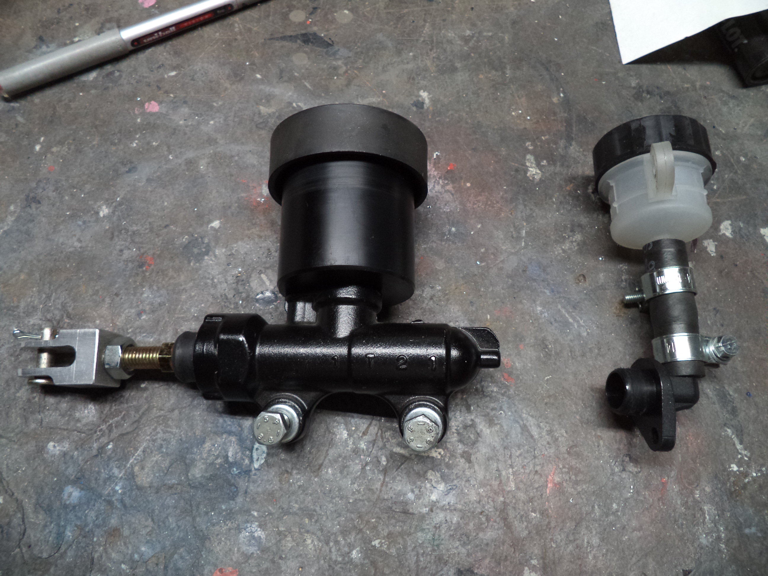

While I am waiting for the the long track support materials to arrive, I removed the service brake master cylinder assembly and disassembled it. As I mentioned earlier, the service brake hardly worked as the master cylinder piston bore was too big at 1-1/8" diameter. I plan to install a smaller master cylinder made for a Kawasaki m/c. It has a 1/2" bore. As you can see, the original m/c brake fluid reservoir was really small so I made one from 2" Delrin round bar and will use the snap-on cap from the OEM Toyota reservoir. I hope I have enough volume to clinch both rotors. If not we'll try something different.
