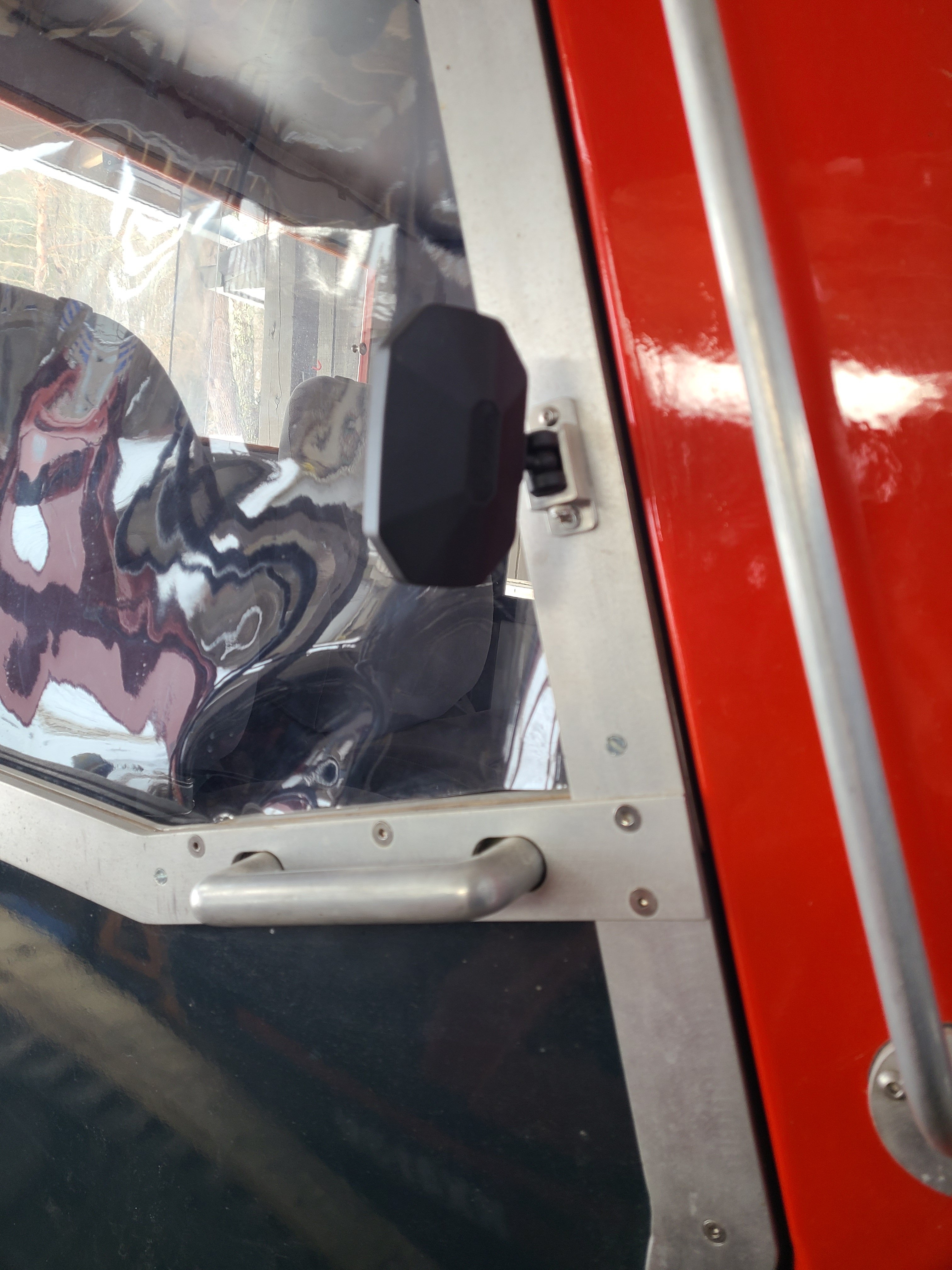

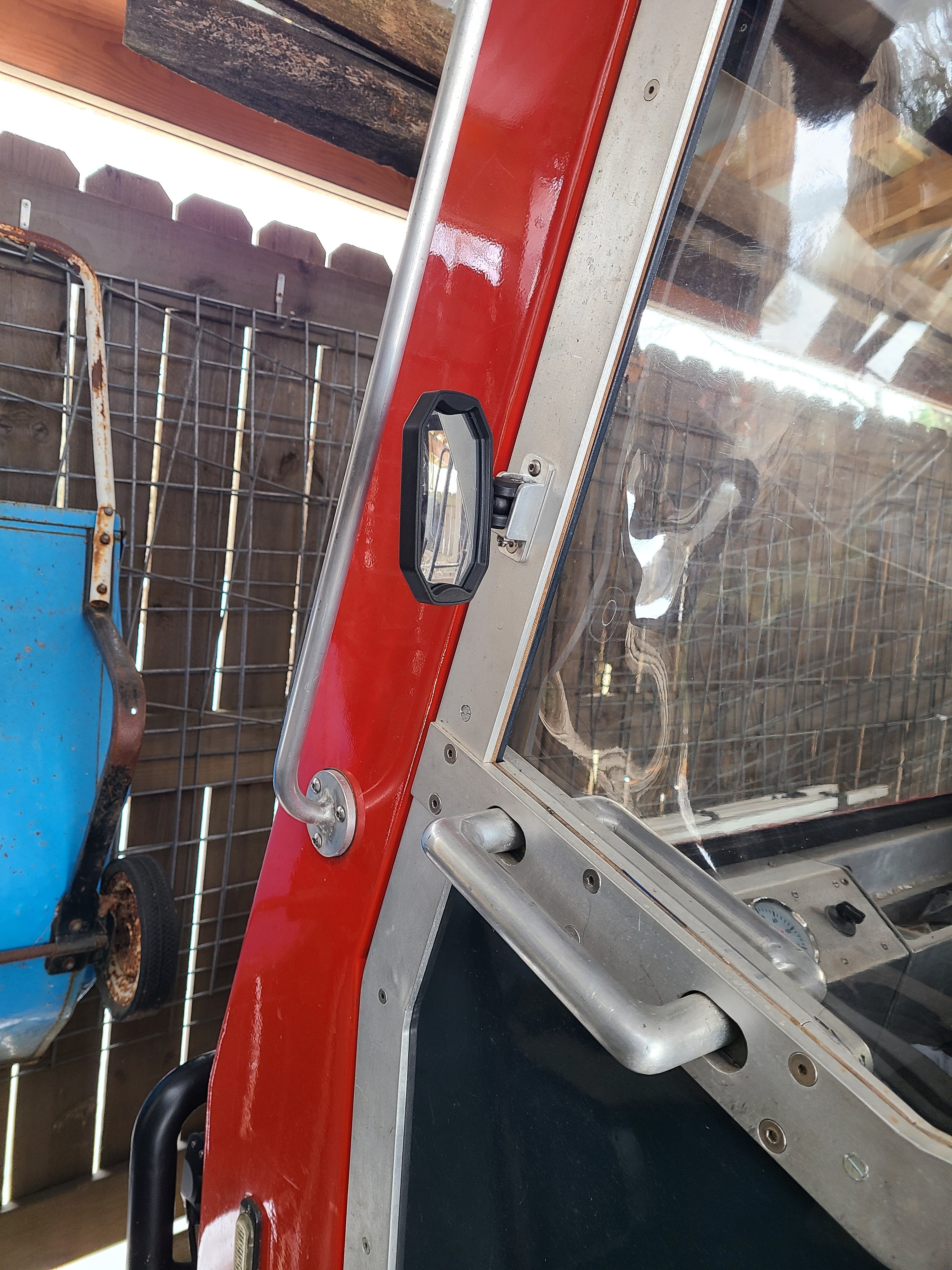

A quick update - recently, I did take off the teeth from the front sprockets and removed a link from the new #50 roller chains to effectively loosen the tension on the tracks. I took it out for a short spin (so as to not mess up the grass too much due to only 3" of snow) and the reduced track noise sounded promising. More evaluation/adjustment is needed. Today, I made brackets and mounted a pair of small rear side mirrors so I can view the tracks so I don't run over things. A rear-view cam & monitor may also be worth installing.

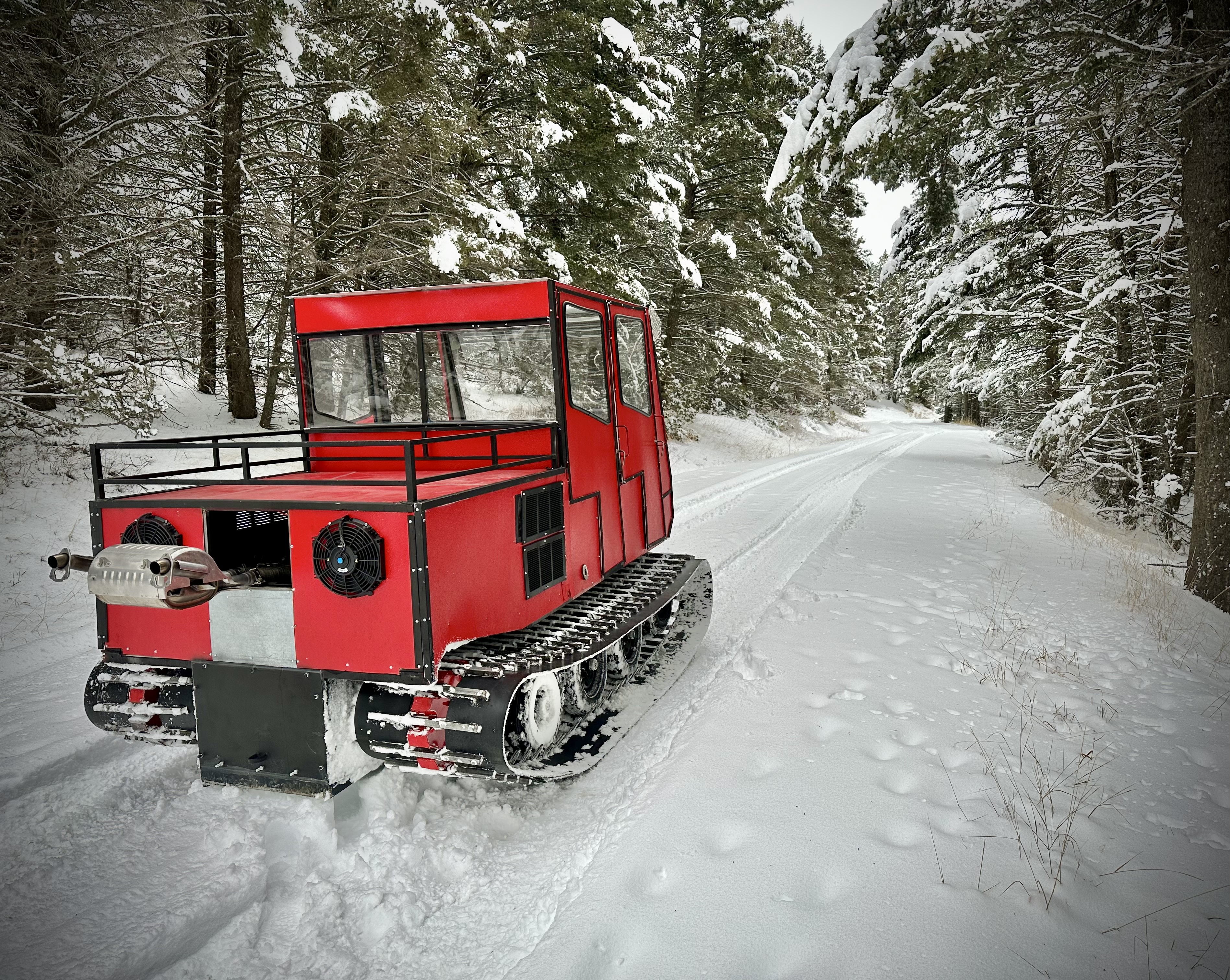

Just ran across your thread. In my brief review, you and I have had somewhat similar trials/tribulations. I built a similar size cat recently.
Engine:Yamaha RX1 4 stroke 4 cylinder 140hp/85ft/lbs
Transmission: Stock Yamaha CVT to "chain drive differential" 4:1 reduction
Differential: Chevy 10 bolt from Suburban
Steering: Brake steering similar to yours
Weight: 2,000lbs
Tracks: 24" wide
PSI: About 0.55lbs/sq/in
Struggles:
-track noise, yup, same as you
-track pitch issues, intermittently yes, fixed to some degree with track tension
-hot brakes, yes, but they otherwise work great (UTV calipers x 2 per rotor)
-broke one axle (because I welded one up for length)
-new axles aren't welded, doubt they will break
-turning in deep snow requires a fair bit of HP and energy
Plans:
-probably convert to hydrostatic this summer, we'll see.

No blog or specific build details. The CVT was tricky getting alignment/deflection correct, but works fine so far. I ran sprocket/chain 4:1 off of the secondary clutch/shaft down to "chain drive" differential which is just a 60t sprocket taking the place of the ring gear. These configurations are used when people put motorcycle engines in small cars.
The CVT is a common Russian tracked vehicle build technique, but they often use much smaller engines. They often do engine to CVT to chain drive to automotive transmission to standard differential/axle unmodified. This makes a wider tracked vehicle because rear axle isn't cut down, but it keeps the fabrication to a minimum.
I watched your track pitch videos and noise. I chased the same damn noise on mine. Thought it was a million different things but ultimately it's occasional track noise/binding. It's hard, because you have to recruit someone to shoot video of it to diagnose it. But mine is very similar.
I'd like to 3D print a new sprocket design/mold and ultimately make polyurethane sprockets. But, a million other tweaks have taken priority.
