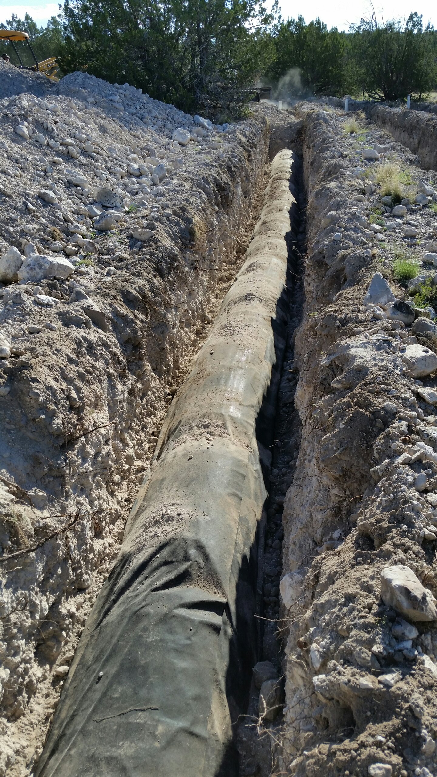

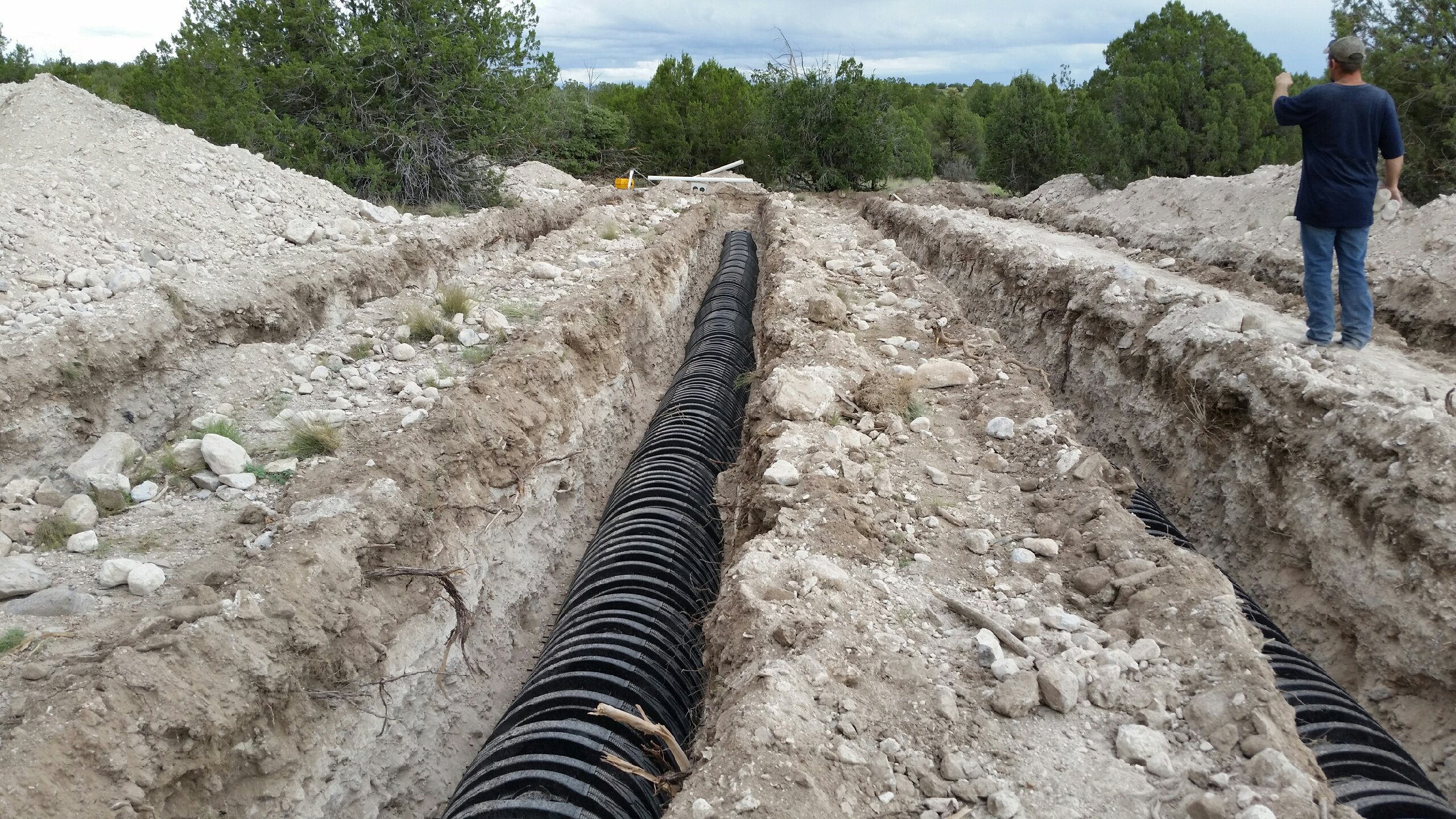

I paid around $10k (including permits) for a 2,500 GAL concrete tank (2 chamber), 4 leach lines x 80' each of the infiltrator dome chamber system and all the labor to install. I put landscape fabric over the chambers as an additional safety for soil infiltration.
It was approved for up to 7 bedrooms/7bath usage. Basically 2 homes can use the system without any issues. Add my $300 aerobic setup, this system can easily handle more than that if needed and it produces a clear effluent and I will never have to pump the tank.
