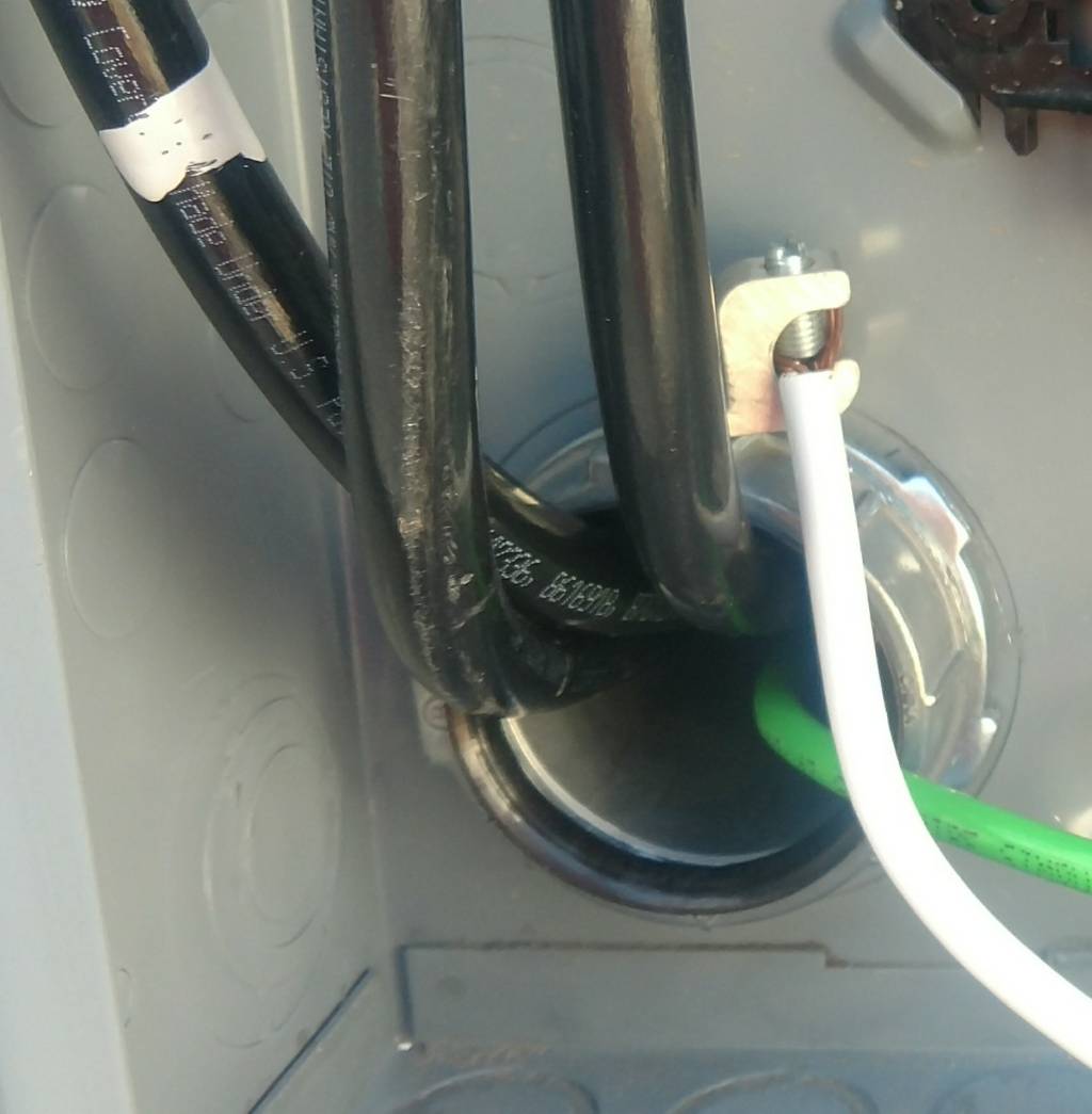

I have a friend that is a licensed and practicing electrician in Houston where he does have to get everything inspected. He looked over the photos of the electrical work and never mentioned the putty but, it's not a bad idea if for no other reason than to stop air movement through that pipe. I've usually just used expanding foam to seal those up inside but, the putty sounds removable and reusable so thanks for that tip. On the bushing, if you zoom in, you'll see I have an insulated metallic bushing with a ground lug on it that has the plastic inside of it. All the boxes are connected with metallic pipe (required by my PoCo) and that pipe is grounded with the bushing on the inlet side of each box (except the meter can that is fed through PVC). I do still need to add some green tape to the white wire running from the ground bar to the bushing, I would have used green wire like the rest of it but, I've got to drive 2 hours round trip to Corpus Christi to get that or order it online. They had some white #6 at the local McCoy's so I just got that and ordered some green tape. I do generally try to make sure the electrical and plumbing meets code, even though there's nobody here to make me do it. I don't want to get electrocuted and most of the rules make sense once you understand the reasoning. You'll notice I did do the little stuff like painting white on my neutral wires, isolating the ground past the bonding in the meter can, etc.
Please don't think I'm being defensive of your suggestions, I'm really not and I will add the putty.
No worries - it's an internet forum. You are welcome to take or leave any advice offered, especially given the price! :D I like the use of EMT for all the wiring, as there is no good way to do an open building like that without conduit. A bit surprised that the PoCo cares what is on the other side of the meter. Around here, their responsibility stops at the meter. What is inside is between you and the inspector. And yes it does seem like you are doing very nice quality work on the electrical from what I can see. I zoomed in but could not tell if there was a bushing on the incoming conduit stub, thus my comment on that. Around here even Home Depot carries the putty, so it should be easy to find.

This pic should show it better, it's the black plastic ring inside the grounded bushing.
The PoCo cares about 2 things after the meter here, that you have a main disconnect outside, a rule I don't like and don't really see the point in, they say it's to protect the lineman from an arc flash when setting a meter but, I'm the only one on this transformer so they could, and probably would, just pull the fuse at the pole. The other rule is that the outdoor disconnect has to be connected with metallic pipe no shorter than 2". I believe this one is to make sure that the box their linemen will touch is properly grounded but, although code requires it, they don't check that box or the metallic conduit for a grounded bushing so, if things settle weird and the concentric knockouts pop out, the ground path they were counting could be broken. I get frustrated dealing with them because the rules seem kind of arbitrary and the ones that do make sense seen incomplete to accomplish what they're actually after. They've got the power though, so I do what they ask and then make sure it's fully correct for my own peace of mind.

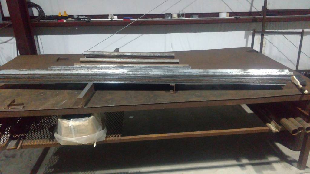

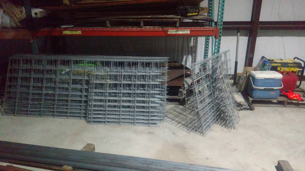

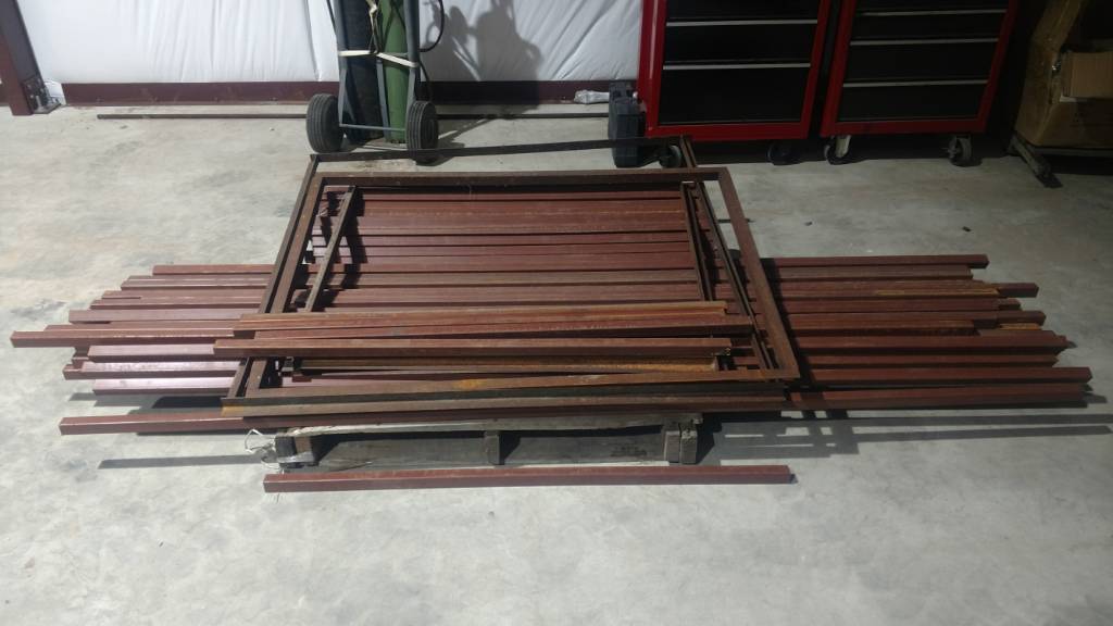

I got a good bit of work done yesterday, it sure was nice to have a flat, level floor again with walls and a roof. I'd forgotten how much easier it is to work like a civilized human. This is 8 box traps and 4 corral traps all cut and ready to start welding this morning and a welding table with all the rust brushed off.
