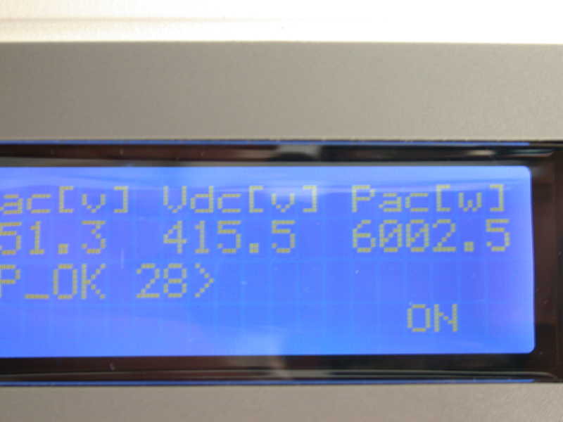

I wish I could still edit the post, that must time out after some amount of time. Was also kicked by pasting in the descriptions, the single quote kicks in some sort of font change under the "right" (really wrong) circumstances.
OK on the life. in 50 years I'll be at zero percent output with slight fertilizer residual value :laughing:. The typical longer life you mention does suggest that roof mount systems might collide with roof replacement down the road. I have a metal roof, so nothing is going up on that (it has a 50 year life in theory). I do plan on covering the wires as they run between the panels with black nylon spiral wrap so that the wires will last as long as the aluminum, glass, and silicon. That will probably be a change every 10 years based on other places I've done that (such as the indoor thermostat wire that the HVAC guy used outside at the old house).
The Fronious inverter has 3 stages that can be kicked in, so the efficiency is across the entire operating range. High power, high voltage P channel MOSFETs sure do help. I'd love to take the skin off and look, but don't want to risk wrecking the inverter or warranty. I got the 10KW inverter so I could take the DC array up to 10 KW if I wanted to. Will probably be limited by if I can get the same size panels or not. If not, I'll have to take it all apart and intermix the "new" panels into the existing strings. But that's a problem for another day after the financial dust has settled and I have a better feel for performance.
Your system sounds great, too bad the incentives aren't there for grid tie. Batteries definitely up the cost a bit.
