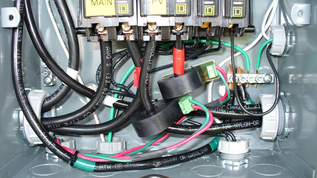

I've got two 40 amp 1000 to 1 CTs on the solar panels. I suspect that only one is needed since the currents _should_ be the same, that's all part of the learning curve. That's the first picture.
I've got 200 amp CTs on each leg of my breaker boxes, I'll have to make more of these PCBs to get that going so I can measure the power use in the house.

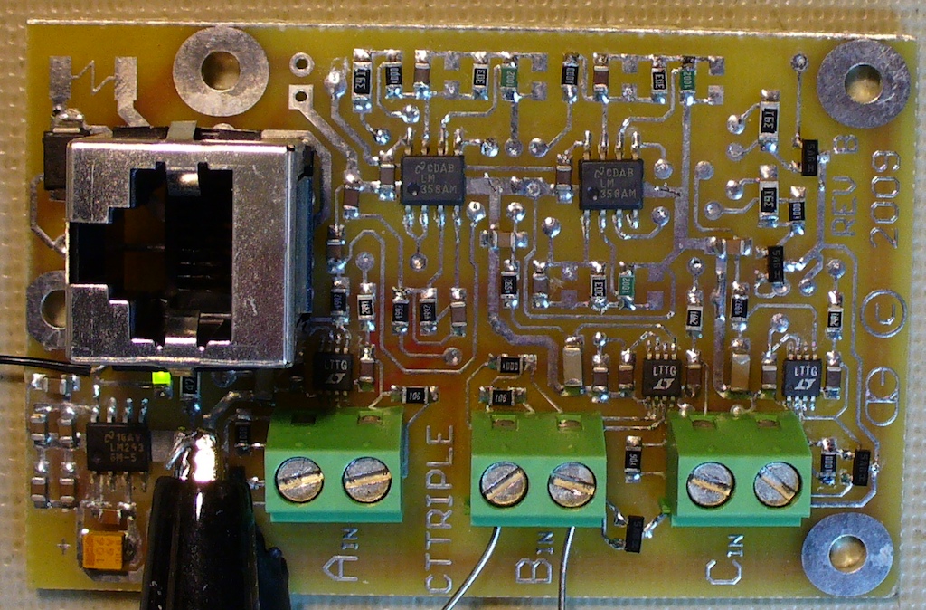

Tonight I just finished firing up a new cut of a PCB that does true RMS to DC conversion for the CTs. That's the second picture. 1 volt RMS in yields 4 volts DC out, true RMS, crest factor of about 3, frequency response good to over 1 KHz. Core part is a Linear Technology LTC1966. The PCB has 3 converters on it, they come out on a CAT5 which also has input power of 6-18 volts DC. With 12 volts for power, the board draws 5 mA including the LED.
All the wires have been run from the solar array to the house, all CAT5, connectors on. Tomorrow I should finally be able to take some readings :D.

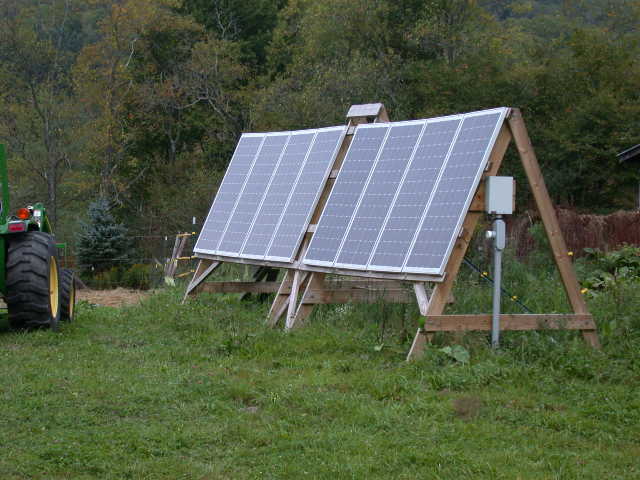

Loren, I'm south of you at about the 42 lat here and I set my panels on homemade supports. The angle I used is around 23 degrees, pretty verticle. I set them for optimum winter power. These panels put out about 1400 watts but more panels to come along with a couple of windmills in the front field and a small hydro.
Pete, impressive!
Rob
