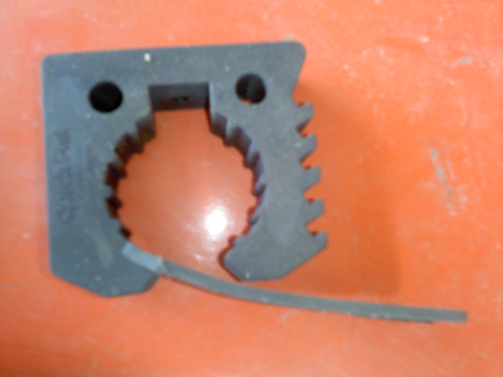

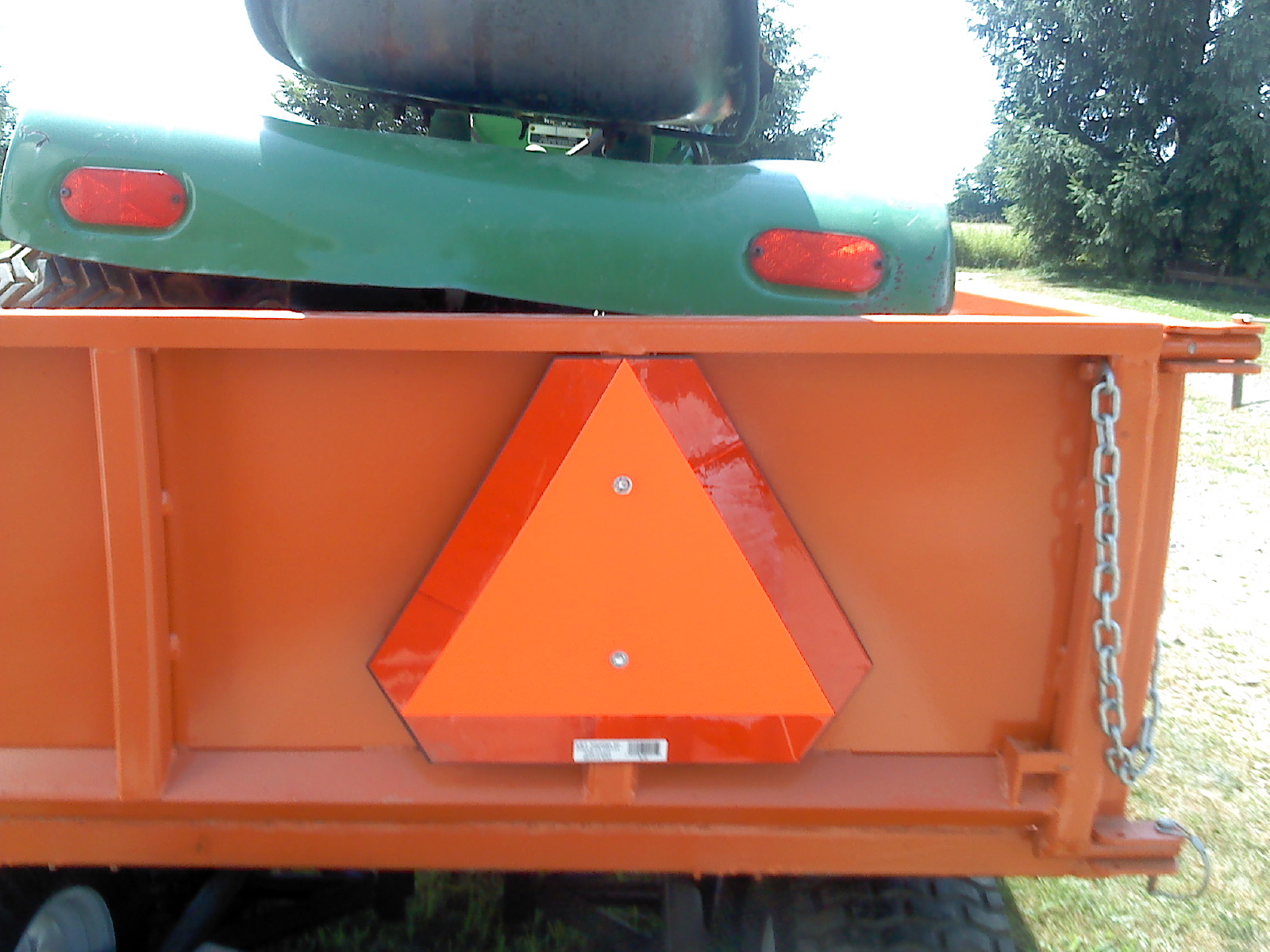

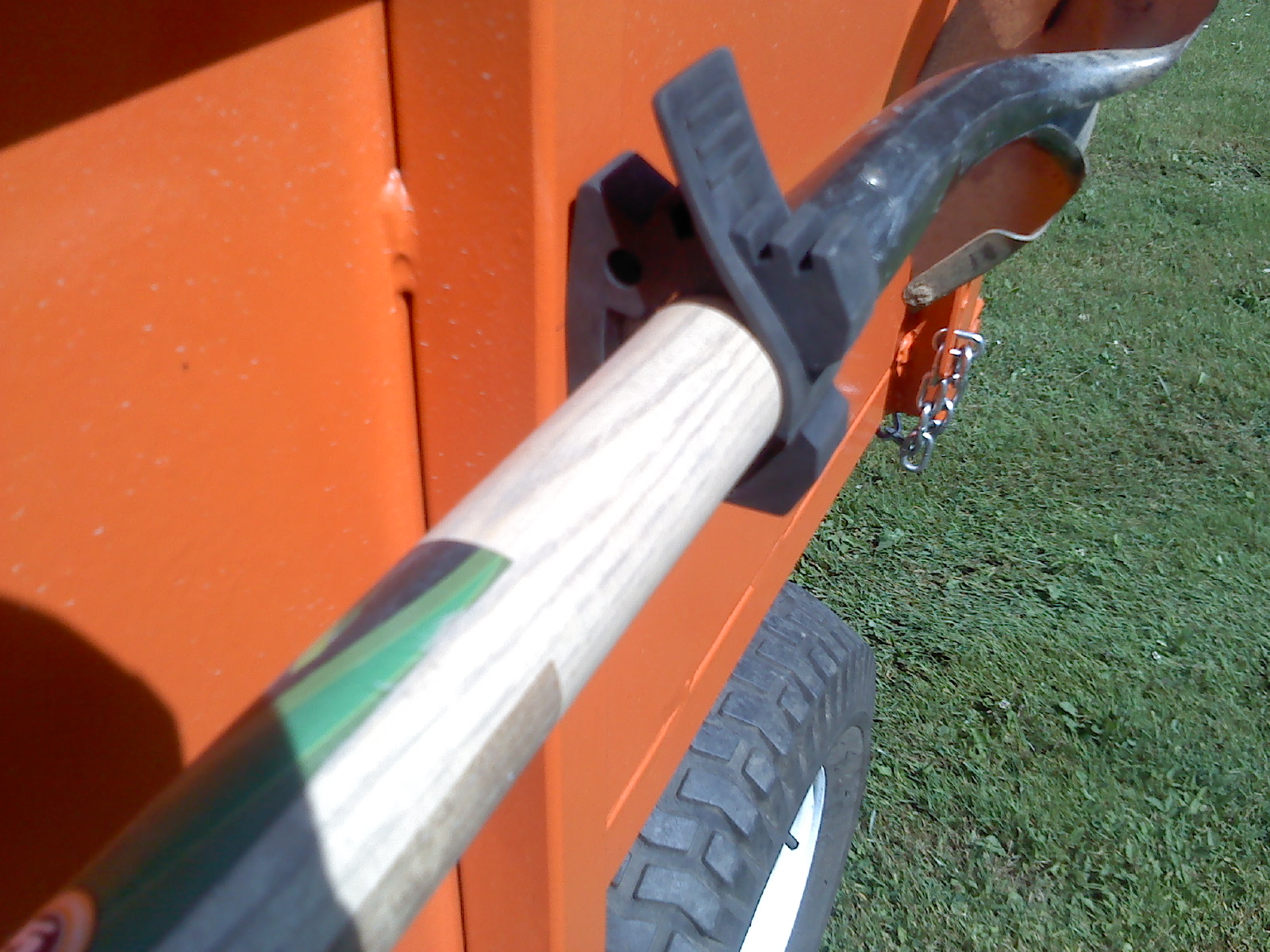

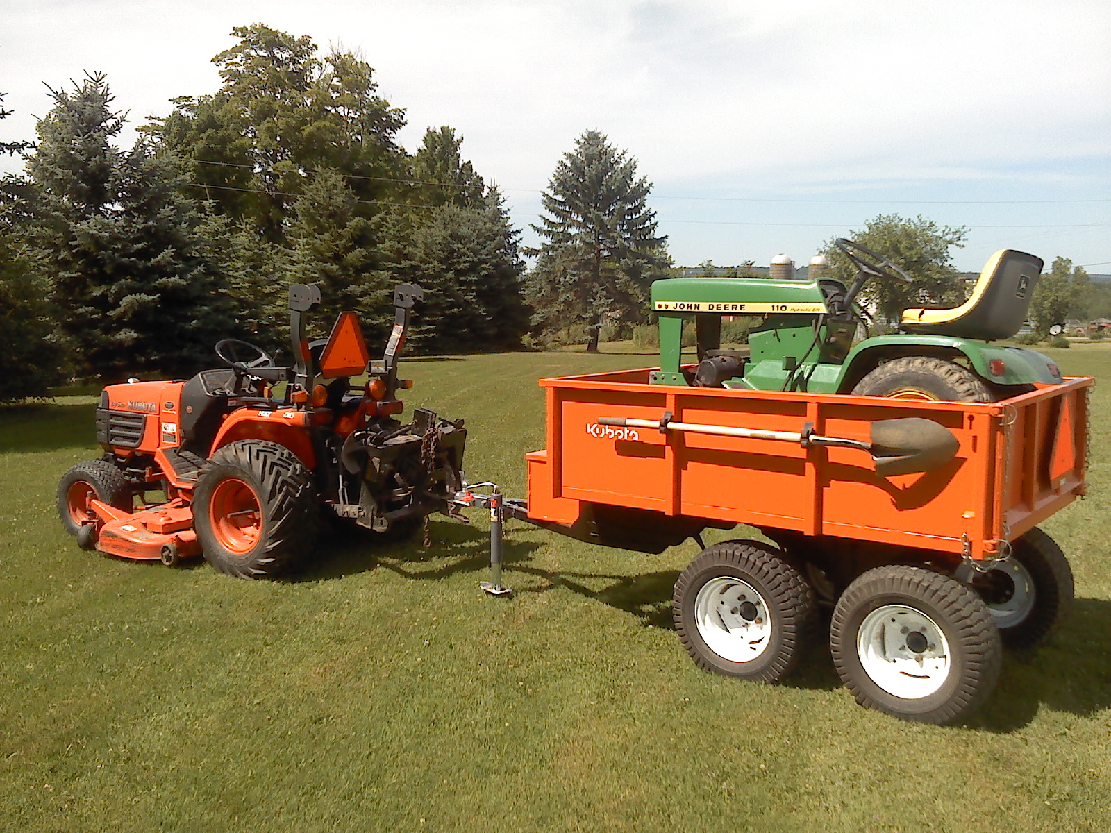

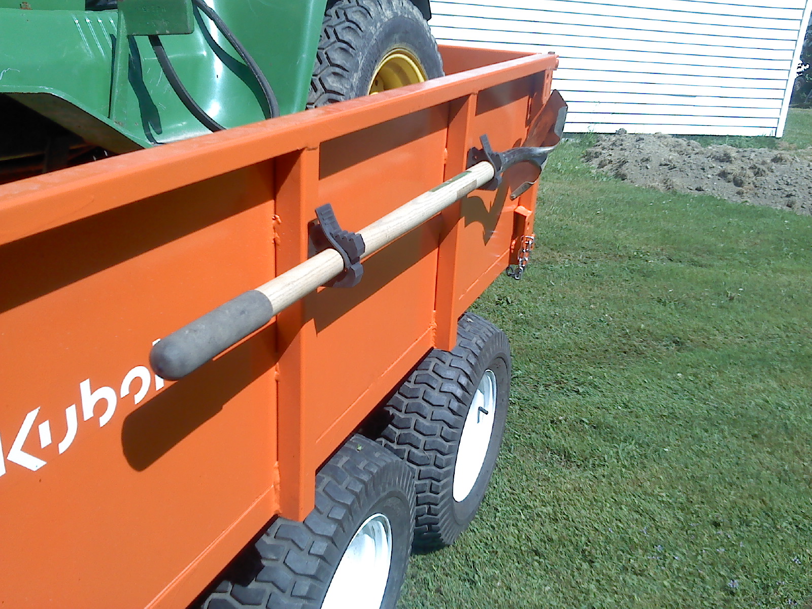

I made some modifacations to the KF DT2.16 today, I added some clamps to the side of the dump so I can carry yard tools with me. I may add another set, not sure. I bought them on ebay a couple years ago after I read a post on TBN about them but can't remember where it is. They are called Quick Fist rubber clamps and they work great :thumbsup: for holding all sorts of tools or pipe, I have one on my Quick hitch to hold my "D" handle round point shovel so it is always with me. I also put a SMV on the back so if I am taking it down the road I don't get hit from the rear.
The last pic is for banditbooker's benefit!!!! :laughing: :D I'm just giving an old timer a lift!!!! :D

looking good!, well, the modifications anyway. haha, i just added a jack to mine last weekend. i'm building a set of pallet forks for my tractor now. should be done this weekend if i get a chance to work on them. im renting a mini excavator to do some digging around the house. i'm actually gonna use my dump cart for the plans i had before i built it. :D

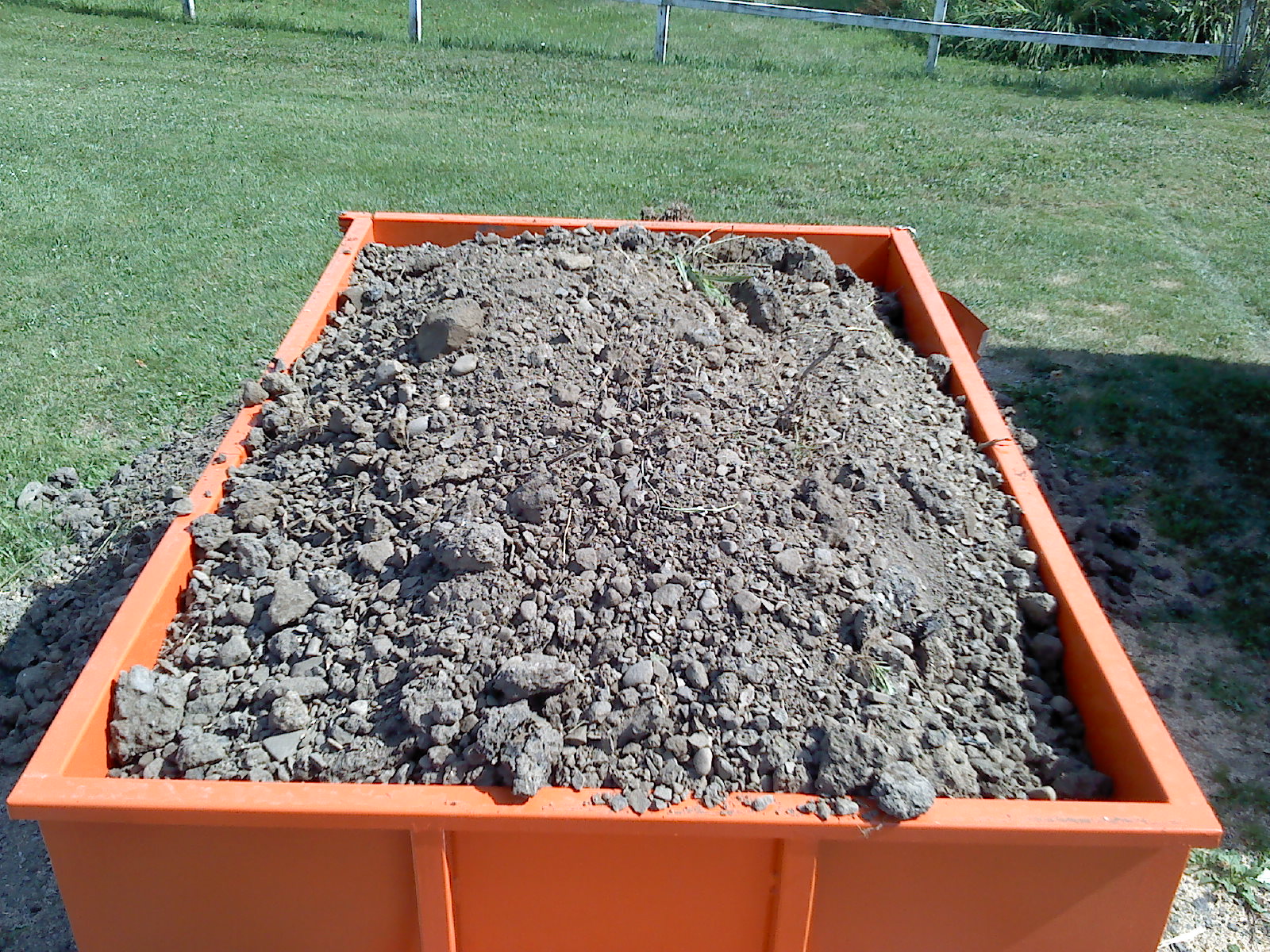

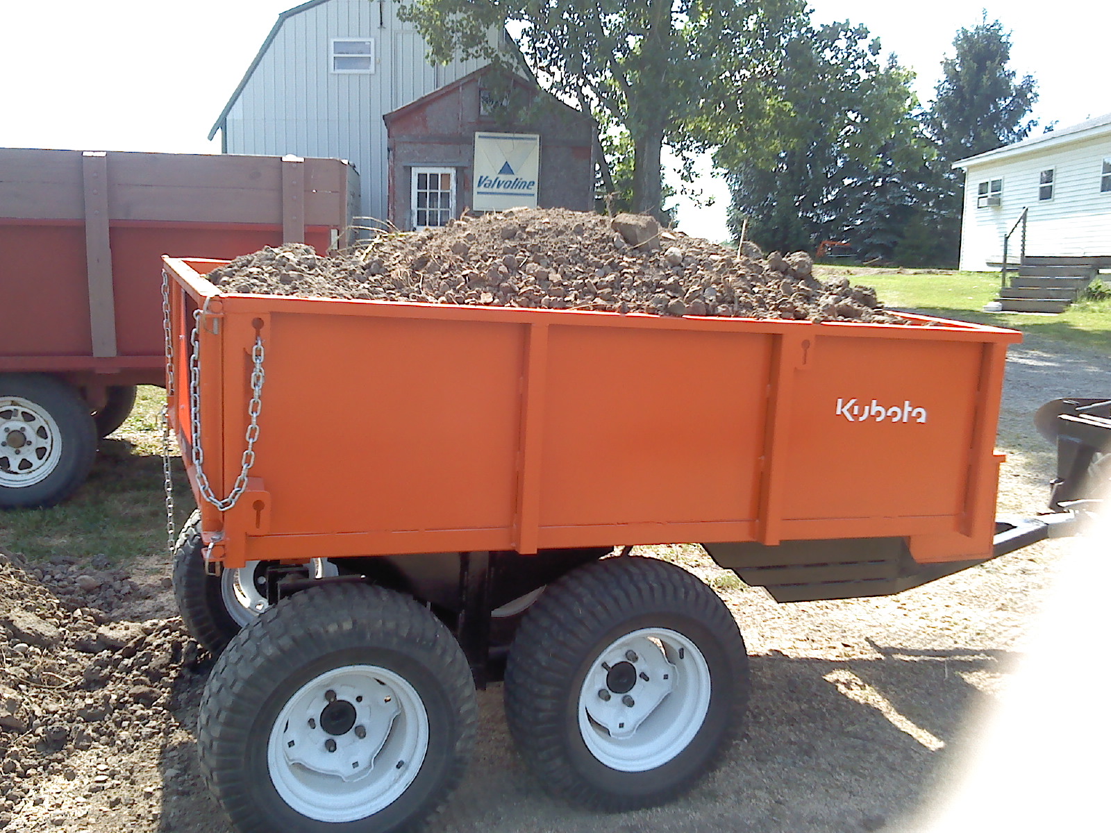

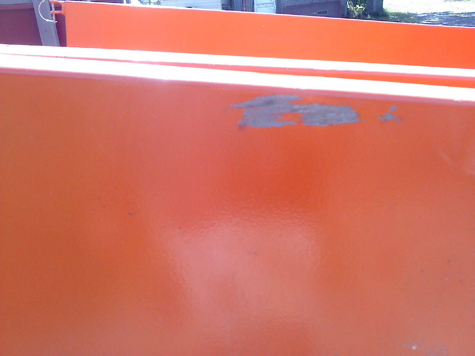

Ok I don't know how it happened but I found a scratch on the inside of the tailgate (probably from haulin that deere around!) So I figured it's broke in and now we can get to work with it! :laughing: I have my brother in-laws John Deere 2310 with a fel on it so I loaded my DT 2.16 with some dirt to test it out and it passed with flying colors!! :thumbsup: :cool2:
As you can see in the pics the thing was very full heaped up in the center and to the top of the sides (18").
There is a slight problem though and I don't know what to do about it but there is way too much tounge weight. While it was on the quick hitch it lifts the front of the tractor unless I have my front weights on. I don't know if it would lift the front if I had a ball on the draw bar, That will be how I have to use it I guess! But on a side note I could dump it without it hooked to the tractor!!
Here is a short video for your viewing pleasure! :licking:

   / my version of a KK xb dump trailer #146
Just my opinion, but the weight distribution issue could be solved by moving the axles closer to the center ... leaving them back a little, to maintain "some" weight on the hitch.
   / my version of a KK xb dump trailer #147
I've seen lots of boat trailers with the suspension mounted on a couple of angle irons that were clamped to the frame rails. This might be a good way to build a dump trailer.
The suspension could be moved back and forth to find an ideal location when loaded. Then it could be clamped permanently or welded.
Bruce
   / my version of a KK xb dump trailer #148
Is there some way you can get more of the weight shifted to your front wheels? Your rears are carrying more and that would cause your trailer tongue to be heavy. How does it look with the load on and unhooked from your tractor? I'm not sure myself whether it ought to hang in midair somewhat lower than your hitch or nearer the ground. Maybe someone can comment and tell me I'm full of it!:laughing:
   / my version of a KK xb dump trailer #149
..... I'm not sure about the weight distribution, but the build is great work and the humor... Well, that is the iceing on the cake!
Good job!
#150
If I were to move the axle mount I would also have to move the lift point for the hyd cylnder under the bed and there are a lot of welds under there so I am not thinking that would be an option at this point. :( Maybe if it proves to be a problem I will look into moving the axle.I wish I could have tried it with dirt in it bbefore I painted it then I would have moved it. :ashamed:
