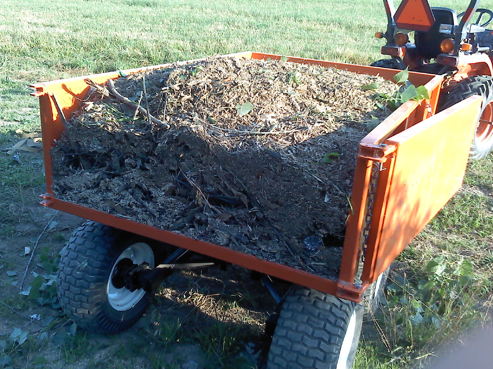

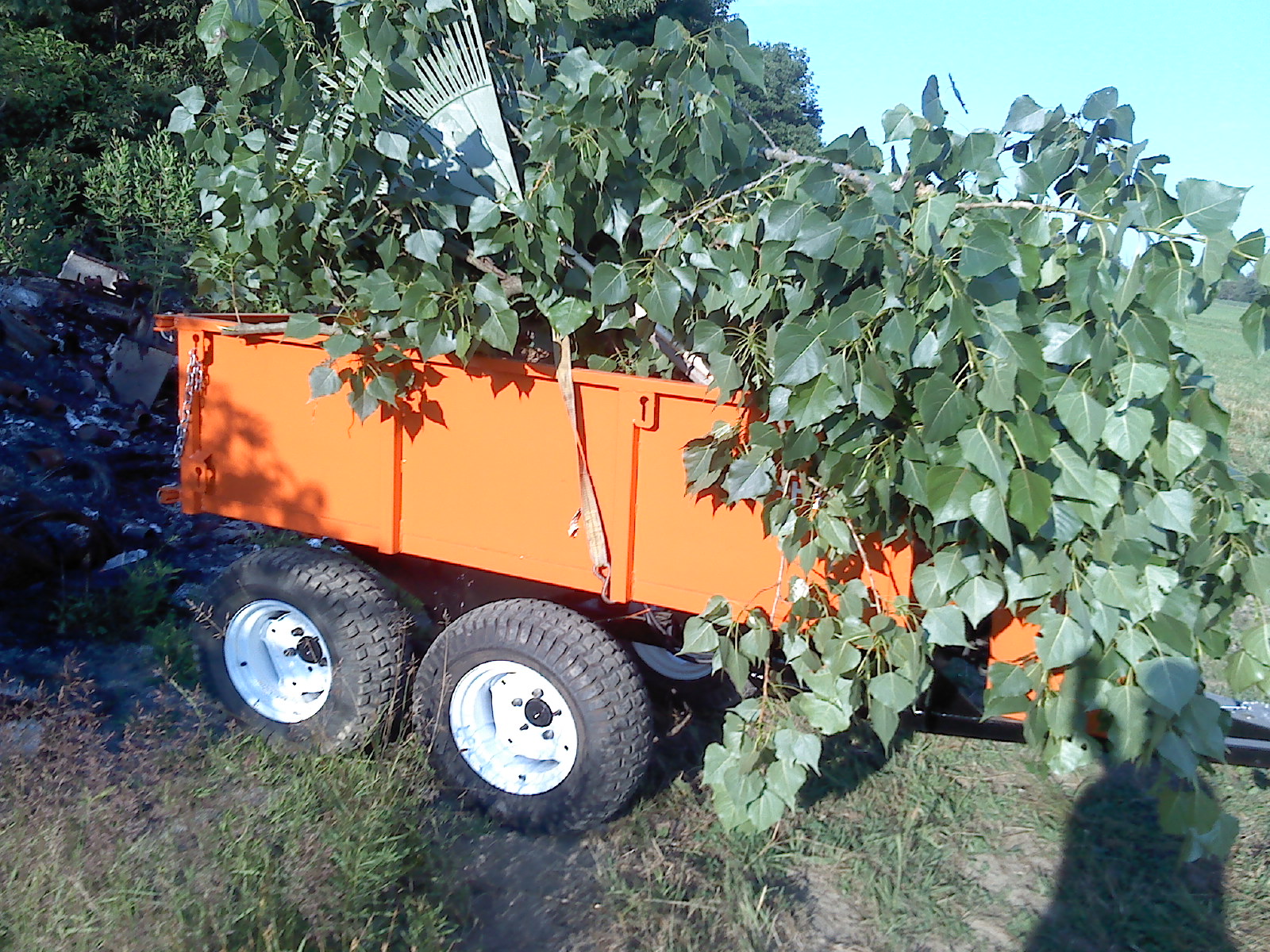

Drum roll please...... and here it is the maiden dump of the Ken's Fab DT 2.16!! It dumped with ease and everything came out. It was only bark wood chips and some dirt but it was the first of anything dumped out of it.....except water! :laughing:
YouTube - ‪Kens Fab DT 2.16 maiden dump‬‏
YouTube - ‪Kens Fab DT 2.16 B‬‏
I had to cut down a dead Elm tree this week so this is what was left after cutting, splitting it and having it stumped out. I also had to trim some branches from a Poplar tree and they are on top of everything else.
It all dumped out with none sticking in the bed. :thumbsup:
I pulled the branches off before I dumped the wood chips because I wanted them on top of the pile behind where I was dumping.
Also that swinging tailgate worked great!! :cool2:
