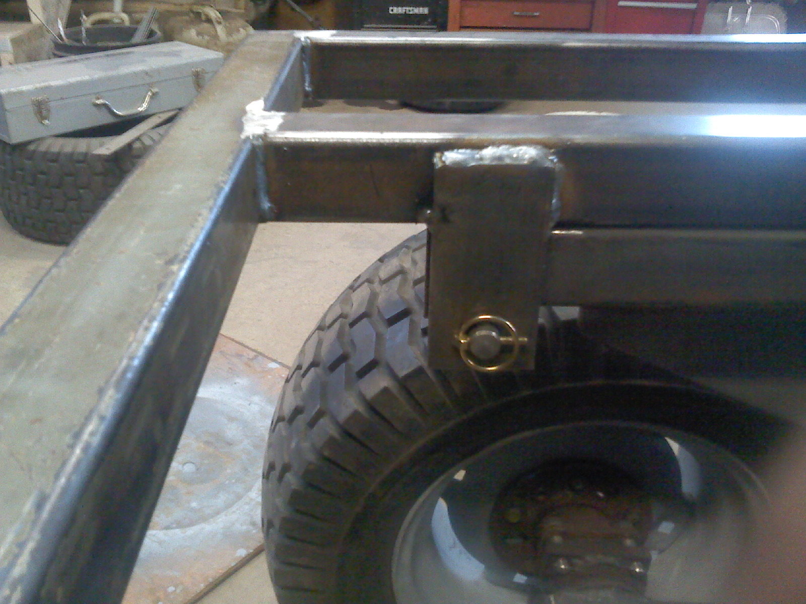

As I started reading this post, the first thing I noticed was that you needed to tie those two axles mounting brackets together to combine the strength, and keep the alignment in check. The last pictures you posted show that you have done just that, with the piece of rectangle tubing. Can't help with the requested information, because my dump trailer build was a little bigger than your project. (all dump trailers are not created equal, lol)

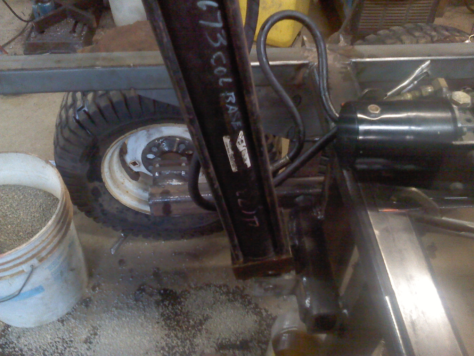

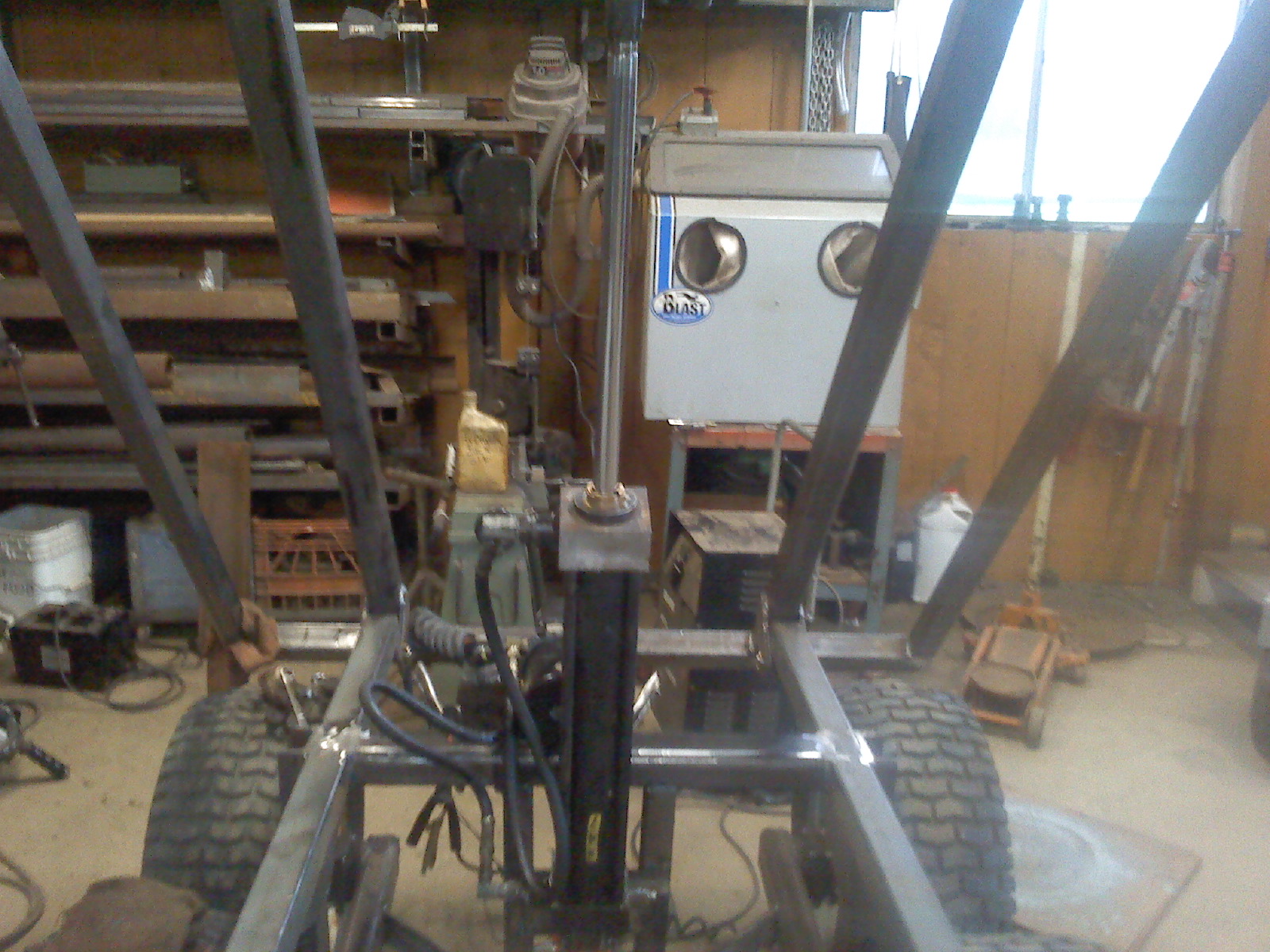

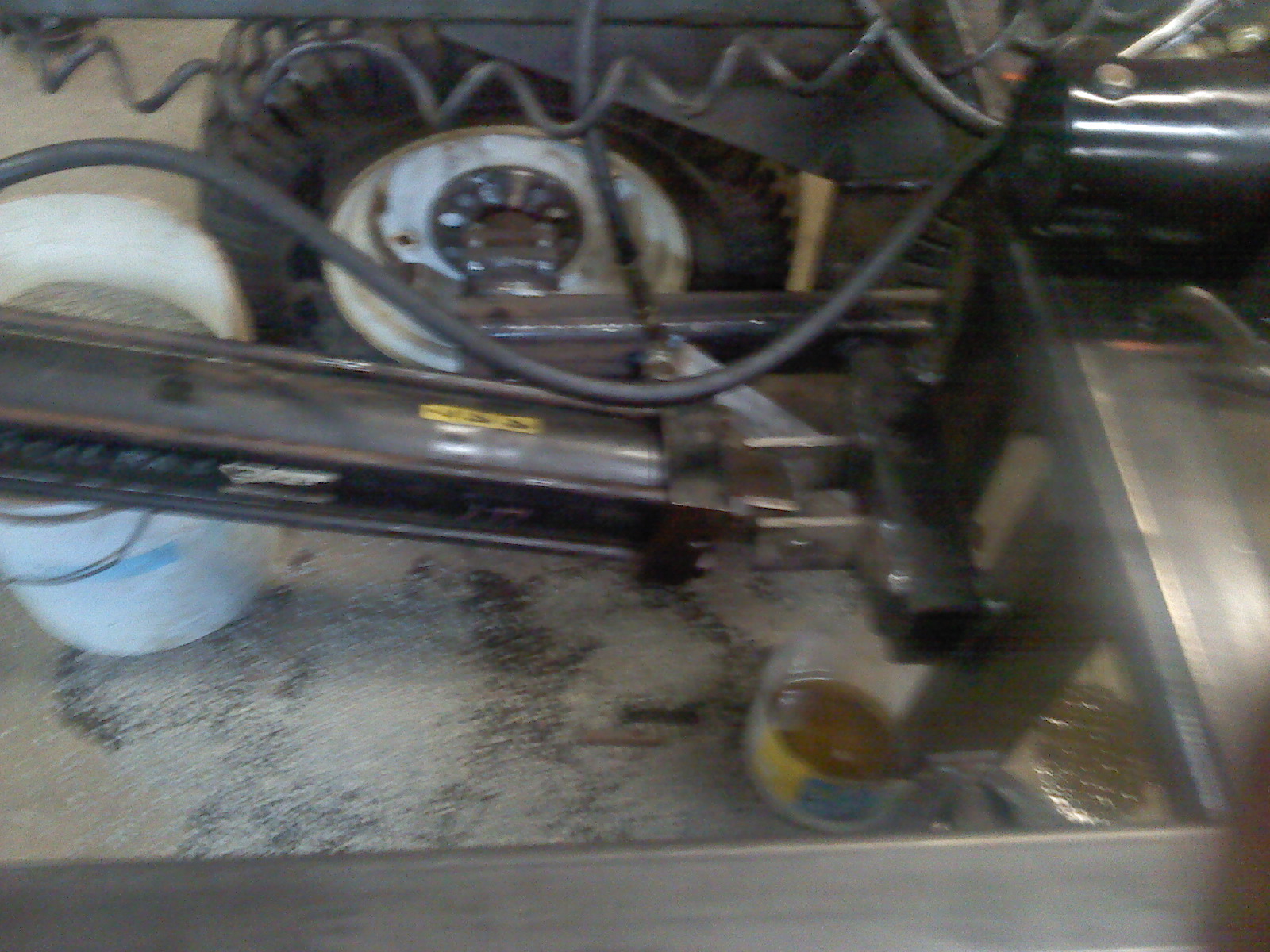

I haven't posted much in the last few days but thats because I have been working and figuring things out by trial and error which seems to have worked.
Thanks Sandman, I have figured out the cylnder placement by reading through Iplayfarmers build again :confused2: and read where he was advised to have atleast 15* angle on the cyl. when it was down and about 45* to 50* on the bed when in the dump possition. I have about 17* on the cyl. and about 48* on the bed in the up possition. I still think it sits too high but cannot/will not change it now. I mounted the stationary end of the cyl. between the upright for the axle but that didn't work because when I lifted the bed the suport jack would rise off the floor. I got on line and checked the pics for the KK xb and noticed that the cyl. actualy mounted infront of the axle so I went back and redid the mount so now the pin is about 4.5" in front of the axle. Now when it is raised it actualy pushes the tounge down. :thumbsup:
On Saturday when I was making the hinges I couldn't get it to dump right with hinge at the very rear of the bed as I didn't want the rear to dip down when the bed was raised so I went to my friends house to check out his Carmate dump trailer's hinge system and coppied that which ment I had to cut 7" off the back of the frame and moved the hinge forward which lets the rear dip down but I still have good ground clearance. In the end the problem was the result of where the cylnder was mounted not the design of the hinge but I am satisfied whith the hinge and as it turns out was a much simpler design than mine

I have a double acting 3"x18" with a 1 1/8" rod the cylnder was mounted on a machine and had no yokes on it so I had to make some and weld them on (I took the cylnder apart to do this)
Power will be from a 12volt power pack from a hyd. lift table the was being thrown out at work.
