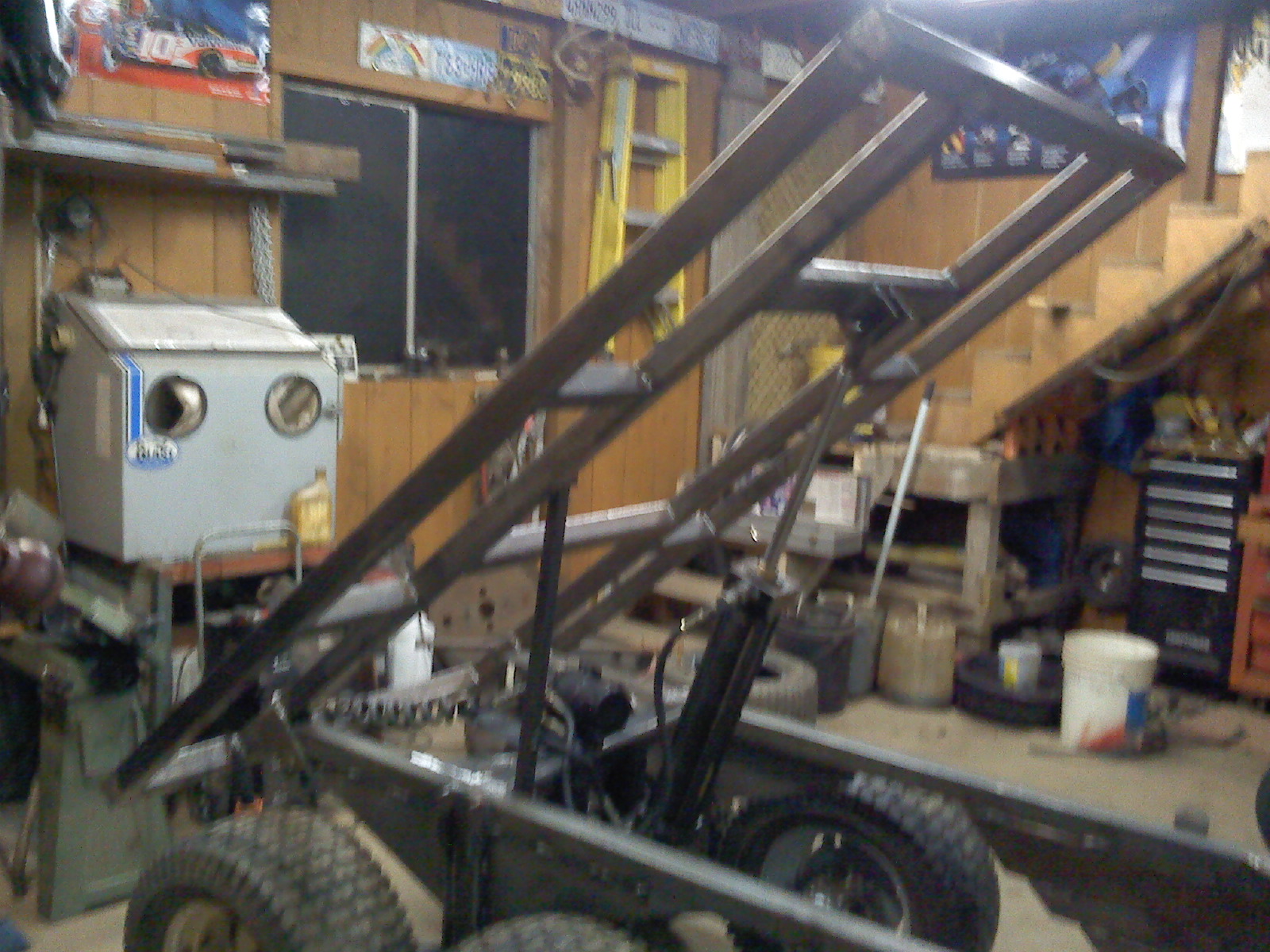

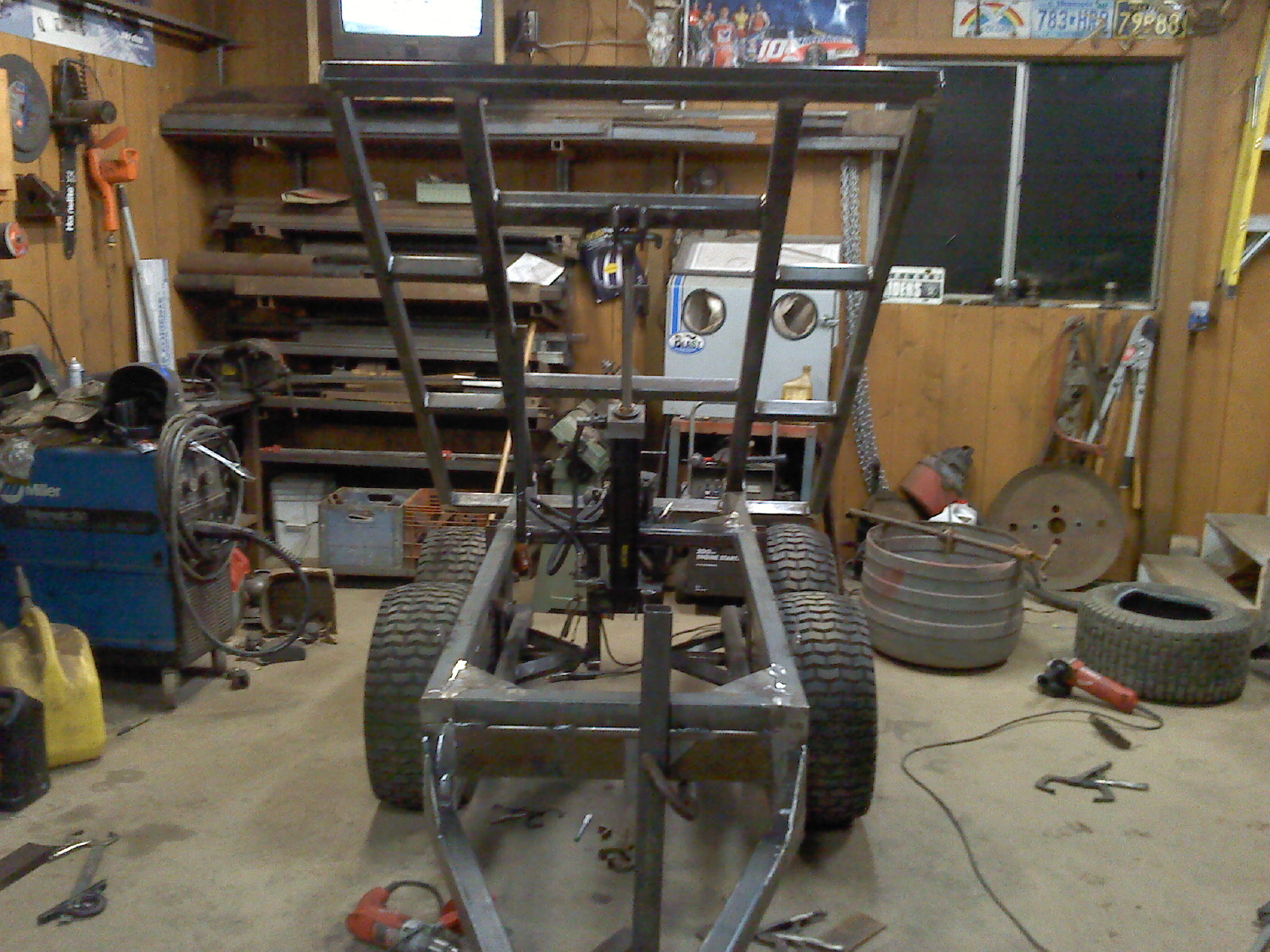

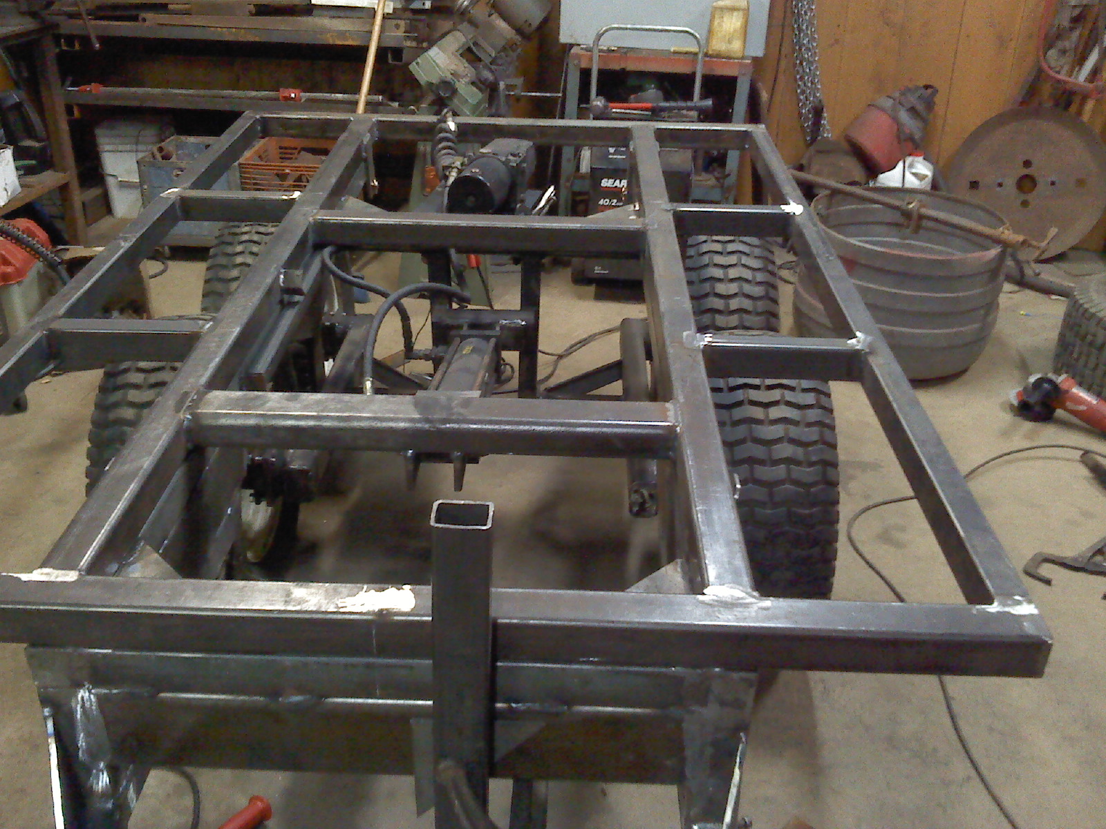

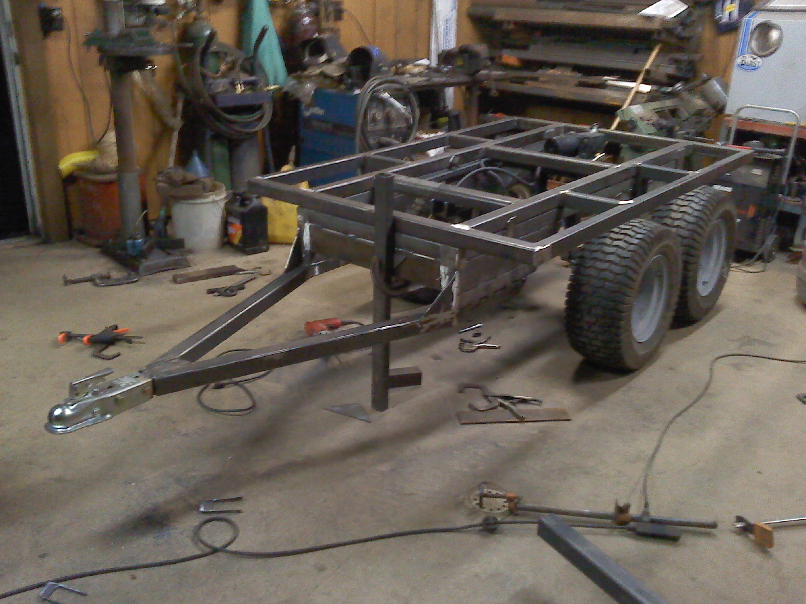

I haven't given up on my dump trailer in case you were wondering! I have been otherwise occupied this week, I usualy don't work in the garage on Mondays as I have a bible study/accountability group right after work and when I get home its to late to start anything. On Tuesday I got home from work and went to the garage to work on it and the first weld I ran out of gas for the welder :mad:...... Guess where I get my gas? Yup about 1/2 mile from my work and thats 30 miles away and gasoline is 3.99 and well you get the picture :mur:, Wednesday I had to go to Pigsburg, Thursday was a dr.s appointment and mowed the yard. Friday's I come home and take a nap for a few hours then get up and hit it so this is what I got done today.
   / my version of a KK xb dump trailer
#25
Since I couldn't do any welding Tuesday I took the oppertunity to clean the shop and straighten up the steel rack, also fixed a flat on the trailer. I picked up my steel for the floor and sides plus I went through our scrap box at the saw at work. I didn't get pics of the floor or sides but will try tomorrow. everything weighed #300 and I paid .15 a pound for a $45 price tag! Most of it will not be used in this project but I included it in the price of the trailer which I will have to tally up but think it is somewhere in the neighborhood of $250 so far. I had some time before my Dr.s app. so I stopped at a scrap yard not far from the shop (I worked there for a time when I was out of work and they give me very good prices on steel and this is the place I got my welder from. Millermatic 250 $400!) and picked up some 1 1/2 square 1/8 wall tube about 15' for the trailer and a 1/2 round for a stop extention on my HF band saw, $10
I welded the tongue on tonight and also some corner braces and stiffeners and also my safety prop.

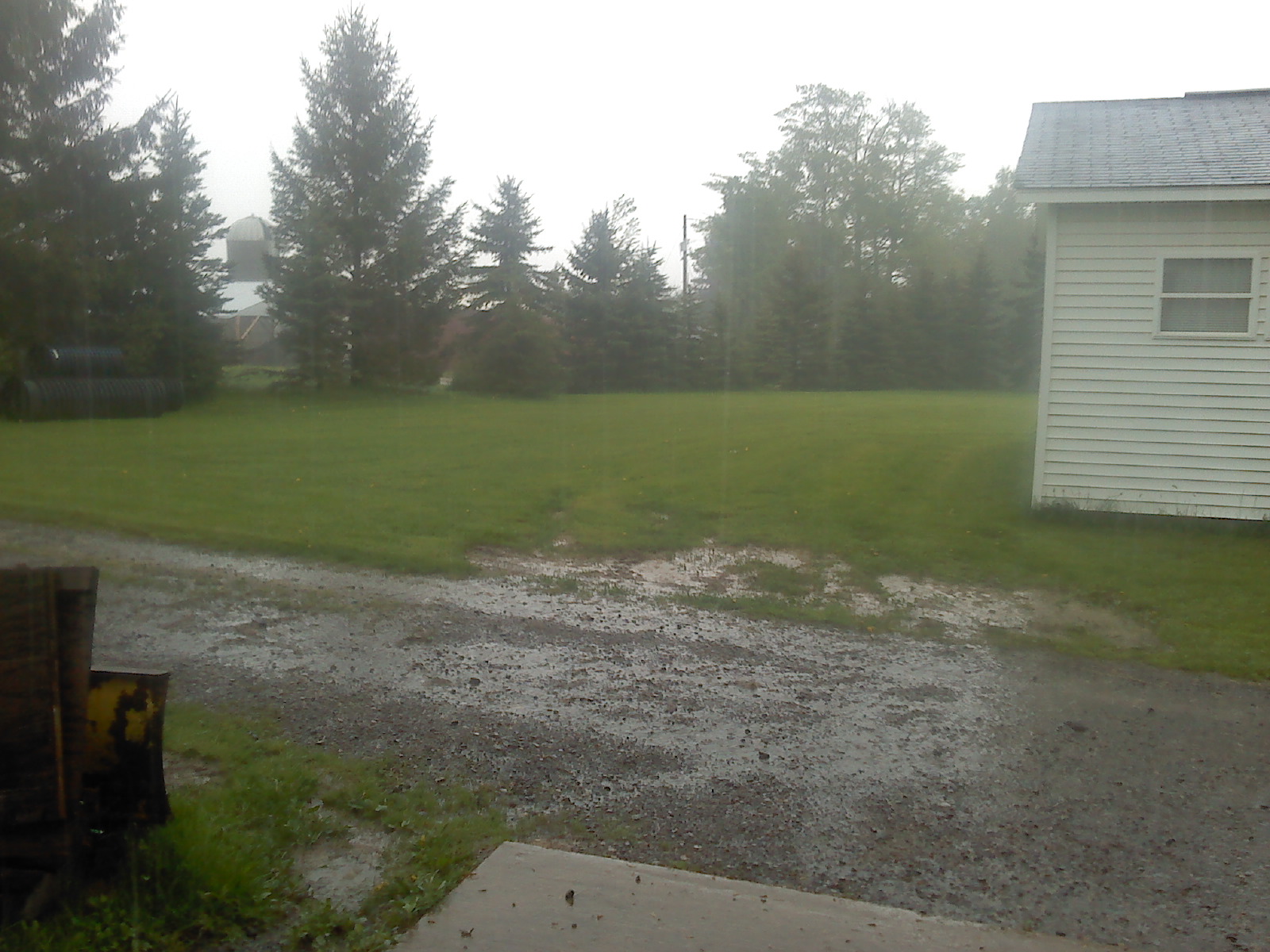

This is what I woke up to on Saturday, so I figured I'd have a good day in the shop and was not disapointed!!!
