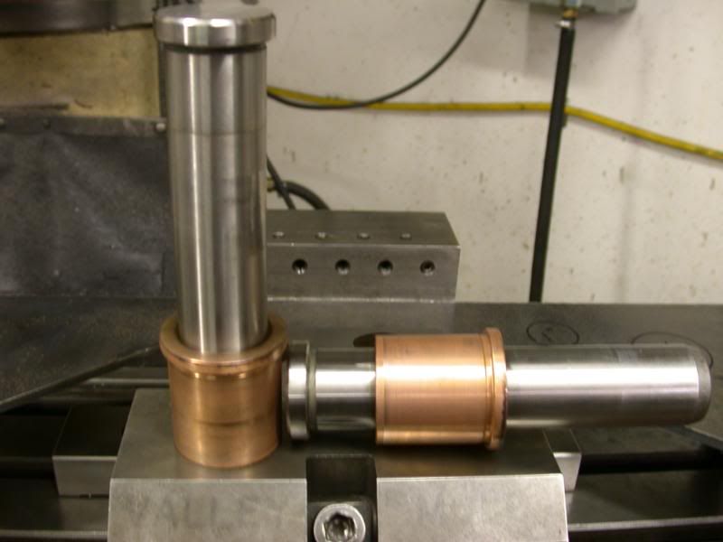

Rob -
Another silly question as I (slowly) continue my own grapple work. I have a length of 1" water hardening drill rod that I had planned to use for pins, but when I looked into zinc plating them (for a little rust control) I realized that alloy steels do not plate well (something about hydrogen embrittlement). I don't think that I can get away with chromate dipping them without zinc plating them first.
Anyway, I suspect that you used a milder steel for your pins. What did you use, and what have you done for the rust that will form on the ends (other than rub grease on them)?
Down here in Florida even the rust rusts. Plated and chromated parts tend to last much longer, so I want to do what I can to slow down the process.

Hi Gary,
Actually, I used case hardened H-13 leader pins and bushings for her grapples.
They are left overs when I do P&M on the plastic injection mold bases. Sometimes I use Nitrided ejector pins which have a super hard surface. They all make great pins.
No rust preventative.
I figure a good amount of grease on the working surfaces should be good enough. Don't forget to make the pins so they are greasable and will lubricate the entire inner surface of the bushings. The photos below show some of what I did to do that, like add grease holes and flats on the pins. I recessed the zerk fitting to reduce the chance of snapping them off.
If I were you, I'd just heat treat that water hardening drill rod after putting the grease grooves and such in and not worry about plating them. I'd think the grease will prevent any rusting for a long time.
