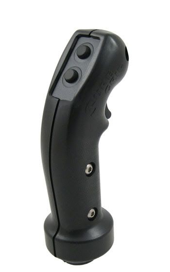

My good friend Larry sent me a link where he got his new joystick handle. When I first designed the grapple, I sent him a copy of the drawings so he could build his own set. He had to get some parts for his installation and found this neat handle. When I did my grapples, I didn't know enough to buy a switch separately, because I could have installed one into the pocket of my Koyker handle. So that is another option to mount the switch.
Click on this link and look at the different grips, switches and components for the handle.
Scorpion Technologies Joy Stick Handles
Well, I just got off the phone with Scorpion Industries and placed the order for a joystick handle.
Brian, the owner himself sent me a quote via fax within 5 minutes. I mentioned Larry's name and he new Larry and the Forum so he gave me a super deluxe discount. When I got the fax I called to place the order with Eden who was great to talk to. I got the "S" series customized handle with a rocker kit switch installed and an M10 x 1.5 mounting adapter to fit Loretta's FEL lever.
Larry also suggested placing a diode between the solenoid terminals to prevent arcing across and also to lengthen the life of the switch or something like that. He told me to get them at Radio Shack and that these would work, 2.5 amp 1000 volt diode (NTE125), so I will do that too.
He said "Just make sure to get the correct polarity on the diode - Cathode (white band on the diode goes to the positive lead)"

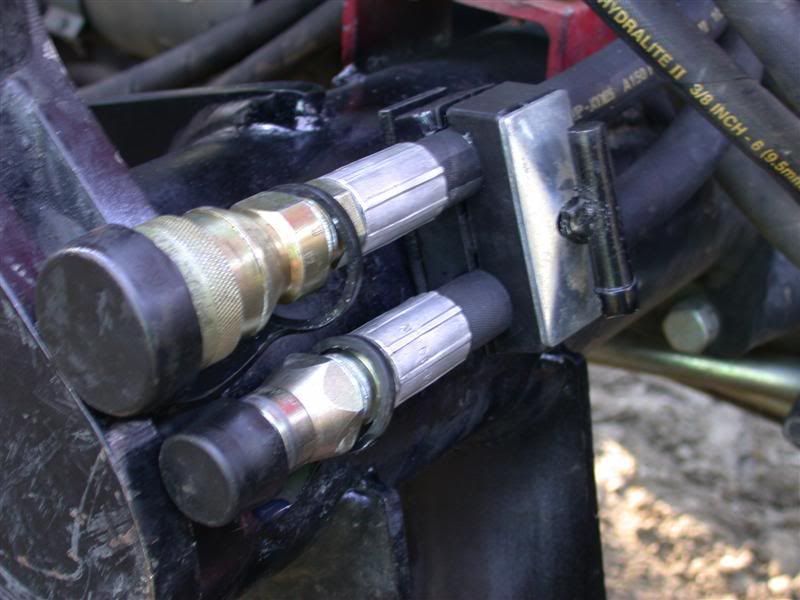

I mentioned we had done some preliminary work for the new grapple.
The valve will be located on the left FEL mounting tube. We made a bracket at camp to accept the DO3 subplate for it. You can see it in the bottom of the photo on the tube. We also got ORB fittings to screw into the subplate and got two short hoses made up which now have those quick connects on them.
Here is a picture of what we got done so far. (click to enlarge)
We also made a bulkhead bracket (painted yellow) mounted to the tractor's left FEL upright. Attached to it will be the other quick connects and hoses leading to the front bucket, but they are not installed yet. Those quick connect couplers on the short hoses will plug into the ones on the bulkhead. That way, if Loretta ever takes her FEL off, she can undo those fittings right there. The bulkhead bracket, quick connects and hoses leading to the front will all go with the loader, leaving only the short ones you see in that picture. We will secure them with something like this when disconnected.
Next visit up, we have to measure and make the hoses running to the FEL cross tube up front. Also those going to the hydraulic cylinder for the final grapple connection. We will use 3/8 hose for that. The hoses from the cylinder to the FEL cross tube up front will also have quick connects on them, since she has a quick attach bucket. So if she ever wants to take the bucket off the FEL, (not the entire FEL) she can do that to put on fork lifts or whatever.
