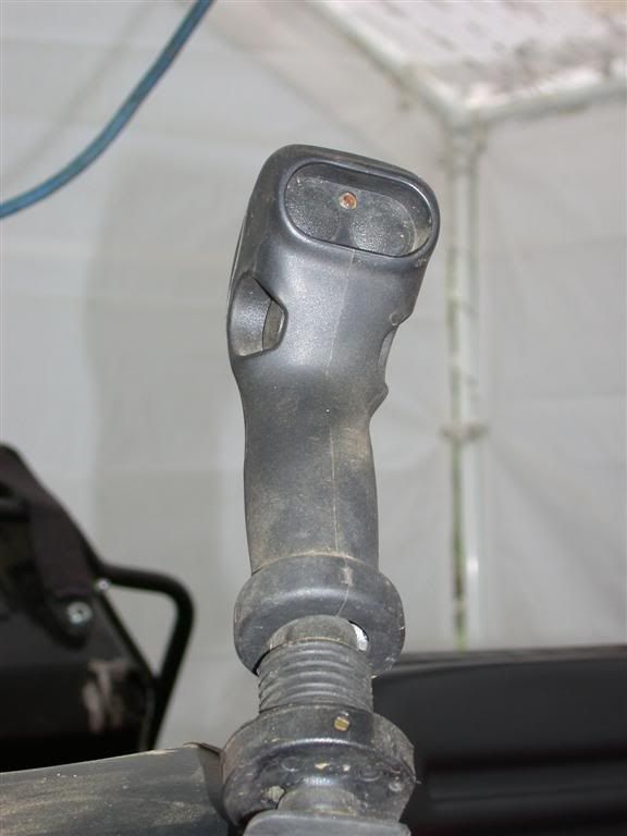

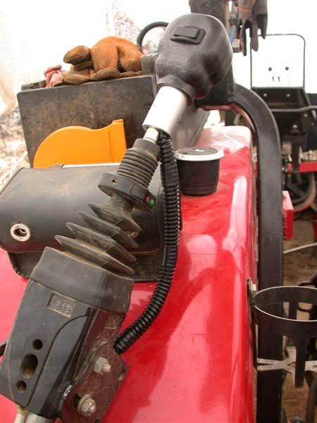

WR Long also has a valve like that, and that one is on my Kama. It came with a Hyvair valve, DO3 subplate, joystick handle with switch for about $350/$380 bucks. I had to order it through my local Kubota dealer since they don't sell to individuals. It is an excellent valve, but as a comparison, the stuff I got from Surplus Center was less expensive to do the same thing totaling $158.35 I did have to buy the joystick handle and switch separately, but it totaled $112. So altogether it cost $270 plus shipping. I made my own brackets for both, so that's a wash.
Here's a comparison of valves and joysticks with switches.
Loretta's Handle. She got a rocker switch instead of the buttons. And her Eaton Vickers Valve and subplate with Hirschmann connectors. The connectors sit on top of the blue valve.
Here's my valve all mounted and wired up sitting on top of the subplate. Also the my joystick handle with rocker switch in it.
Her Scorpion handle as you can see from photos above, is way nicer looking than the generic one I got from WR Long. The package was less money and will do the same as the WR Long valve. The valves and switches are all pretty waterproof. I've had no problems there. Now, if you can modify your own joystick handle to add a switch, you've be money ahead. My koyker handle was like that, but at the time I had no clue I could do that. You can see all the little pockets for possible switches and buttons. It looks like the Scorpion handle a little.
