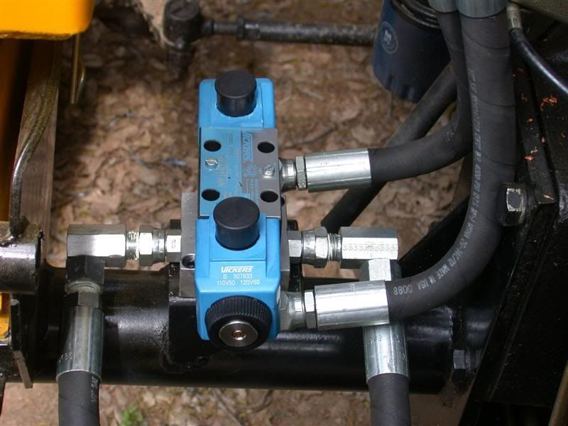

Still no luck with getting Loretta's solenoid valve to work.
I brought a volt meter up and checked out the Scorpion Rocker switch and the Hirshman connectors ... they are good and all the grounds are good. Also verified the hydraulic connections in the system and they are all correct. I unplugged the QC's at the solenoid valve and hooked up hoses to my Huge Kama. The grapple works great under Kama's power so I don't know WTF?
I even took a hot wire right from the (+) and another wire to ground right to the solenoid terminals while the tractor was running. That procedure took the switch and connectors out of play...still didn't work!

How do I go about checking if the solenoid valve is faulty or not (in detail) using a ohm or volt meter? I tried the direct circuit route already.
Any suggestions?

Unfortunately 3RRL your coil will not work with your system. If you look on the 3rd picture you posted the valve coil is marked 110V50 and 120V60. The coil is rated at 120VAC 60Hz. If you connect it to a power cord and plug it into the wall I'd bet you'll hear the valve switching.
Vickers valves can usually be converted over to 24VDC or 12VDC by just switching the coil.

When I went to the property this week I tried all those things I posted above, but also noticed then (not before) that it said 110v50 and 120v60 on the ends thinking that might be a problem...just in case. I copied down everything that was on the valve they sent to me. I ordered the 12v model and the shipper shows it's a 12v too. But I wasn't sure if the valve was marked like that or not?
I just called Surplus Center to let them know all I tried to get it to work. Then gave them the ID information to them and also about the 110/120v on the valve. When he read me what the ID SHOULD be, it was different than on my valve! So now he's researching that out. I think they sent me the wrong valve in the right box.:) Heck, I'm only 108v short.

Well, I just got off the phone with Surplus Center and they are going to make everything right. They are sending out the correct valve and also a prepaid return sticker for the wrong valve.
The number I posted is for the correct 12VDC valve.
Item #9-6136 with ID#DG4V-3-8C-VM-U-G7-61.
The wrong valve I got is indeed for 115v as verified by their tech.
Item #9-7236 with ID#DG4V-3-0C-M-U-B6-60.
Hmmm, although I've wasted a lot of time fiddling with that valve and the hydraulics, at least I know what the REAL problem is now. I asked them to send it out 2nd day air so I can go up this weekend to install it.
