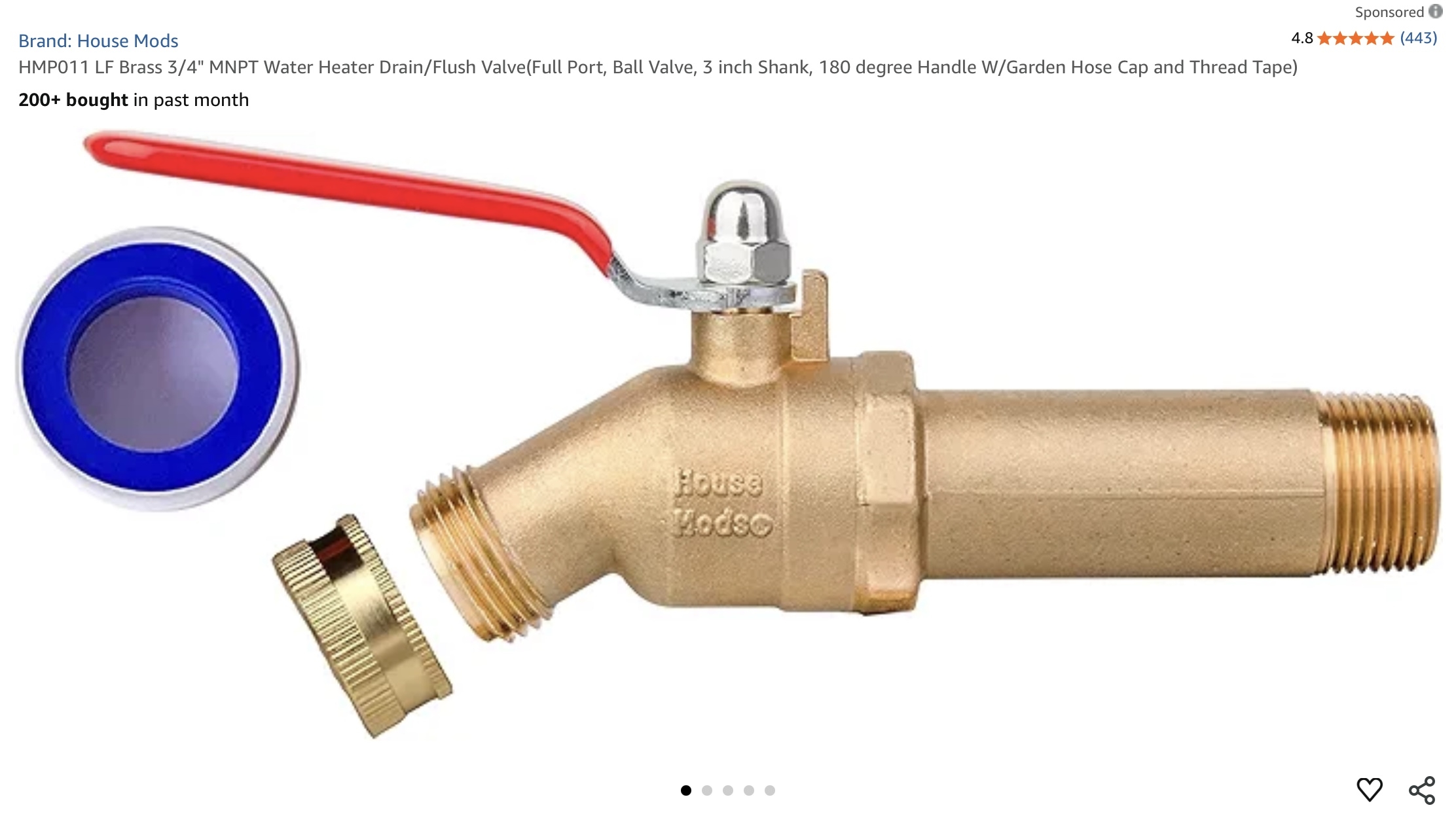

Just now while reading your post, is when I learned that draining the hot water tank is a thing you're supposed to do. I've never done it once in my life. I've never heard anyone else mention that it's something they do either. I did not receive any handbook for being an adult and I'm just making this stuff up as I go along :ROFLMAO:.
Thanks for pointing out the obvious (only obvious now that you mention it) reason for why my water heater is half full of minerals and likely beyond recovery. As soon as I get a new water heater, monthly draining will be on the calendar.
Not only are you supposed to drain a water heater regularly, they need the anode rods checked and replaced, unless you install an electronic anode. I replaced the crappy drain valves with a full port drain. This allows for full water pressure to evacuate all sludge build up in water heater. On my new waterheaters i added electronic anodes.
And fill port drains

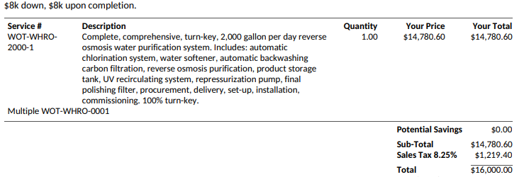

Ok I got the $250 water test and the results are attached. It seems the reason for everything eroding is Clorides and it seems the only way to eliminate those is with a whole-home Reverse Osmosis system. I have gotten a quote, $16k. Not sure why it's that high?
Does this make sense? Cost seems really high. googling "how much does a whole home reverse osmosis system cost" yields dozens of results all suspiciously citing the same exact maximum number: $4,800. I suspect this means they are all plagiarized from one common ancestor that might be 20 years out of date, so I wouldn't be surprised if the real cost is higher, but $16k does seem excessive to me.

It is good to see the attached water quality report. I think that data really helps decision making.
My takeaway from that report would be that in my opinion your well water has pretty high TDS (Total Dissolved Solids), with a fair amount of magnesium and calcium, in addition to a lot of salt in your water. Having calcium and magnesium means that an RO unit will absolutely require a softener pretreating the feed water.
So, you need a good whole house water filter.
Yes, using the well water as is will likely continue to generate corrosion in your pipes and hot water heater. A powered electrode in your water heater is likely a very helpful addition, even if you do whole house RO. Adding a water softener will reduce or eliminate the crud/precipitate in your water heater, but won't help corrosion. A water softener will help with crud in the water heater, but not with corrosion.
One possibility might be to use a whole house water softener, replacing pipes and fittings with PEX, a powered electrode in your water heater, and a small RO unit for drinking water. This would minimize the running costs.
I think that the whole house RO is a viable solution, but I would move to water efficient appliances (dishwasher and front loading washer), because there is a non-zero per gallon cost to RO, as sediment filters, charcoal filters, and RO membranes need periodic replacement, and you have to soften 4-5 times as much water. RO water can be hard on metal pipes as well because of the pH as it is usually a little acidic, and most whole house systems will do something like put the RO water in a concrete holding tank to neutralize the pH before it gets put in the house plumbing. I don't see a pH adjustment in your whole house quote. A whole house RO will use 4-5 times the amount of water that you are now using. That is because a 95% TDS reduction rate usually has around a 4 gallons to drain per gallon of product water, and that again adds to the cost per gallon of RO. And no, you can't take the reject water and run it through a second RO without lots of chemical monitoring.
I do think the the DOW Filmtec RO membranes have superior performance and durability.
I would want to see a more detailed breakout of the cost before commenting on it. Just for some perspective, a large whole house water softener (4-6cu.ft.) around here used to be used to be $2k-ish, plus installation, and a 1000gpd RO unit starts at about $900, but you need to add a prefilter and a pump. I've used this one in the past;
This is more of a complete unit;
1000 GPD PUMP DRIVEN COMMERCIAL RO $1,600
I've bought other items from them and their technical support has been excellent. The air water ice system above has the option of flush valves, and I would recommend getting them.
You would still need to add a RO storage tank to accommodate the high demand times of showers and washing, some float valves or water level monitor, and a booster pump to get the water from the RO tank up to normal 40psi water.
So, perhaps $4-5k in parts, plus labor, and then it is on you to service it. Personally, I enjoy that sort of thing, but I realize that it isn't for everyone.
If it were me, I'd buy a good large water softener, with a self flushing prefilter somewhere upstream, switch to all plastic PEX piping, add a powered anode for the hot water heater, and put in a 50gpd RO (from APEC or Air Water Ice, as I think that there are lots of less than great vendors out there) with a booster or permeate pump for drinking water, along with a 10 gallon RO storage tank, and call it good.
A large storage tank means that the RO can be run less frequently, increasing the delivered water quality; our system is under the sink, where I have an on/off valve to turn the feed water off after the RO has filled the tank, and on again when it runs out. Yes, a manual valve is more fiddling, but it gives us higher quality water.
At some point in a quote, I think that you have to allow for the cost of running a business having competent staff, and markups on stocking parts, etc, and being available to service your system. That all costs something. I would ask your vendor for recommendations that you could contact (especially commercial users), and then ask around at perhaps some of your local restaurants and chain restaurants what they use, and more importantly who they use.
