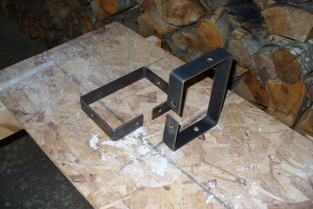

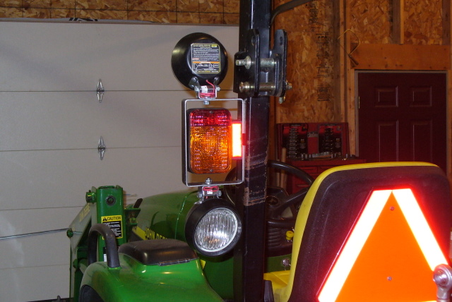

This afternoon, I made a pair of "brush guard" type light mounts for my John Deere 4600. I used 1.25 " x 1/8" steel, which I bent cold using a vise, hammer and anvil. These are a similar design to the John Deere Brush Guards, and mount the same way.
The photos show the trial fit, before painting and hooking up the wiring. There's also a shot of the mounts just before painting.
I painted the primer coat earlier this evening. I brought them into the Living Room after painting, so the paint would cure faster. I'm not sure I can get away with this, but I'd like to top coat them before I go to bed tonight, so I can install them, and hook up my wiring tomorrow.

The lights are Halogen Work Lights from Harbor Freight. If I remember correctly, I paid about 8 bucks apiece for them.

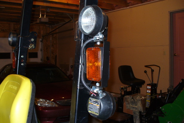

Pulling the wires did turn out to be less trouble than I anticipated. On somebody's post (either on TBN or on another forum) I saw them using a garage door cable to pull wires through the ROPS. While hunting through my storage boxes for some wire, I found an extra garage door cable. I folded the ROPS and fed the cable down from the top, plain end first. When I got to the bottom, I poked around a bit, and was able to get the cable out through the open area at the front of the bottom of the ROPS tube. (Due to the brackets for the ROPS and the backhoe, you can't look straight up into mine, and you can't get into it directly from the rear of the tractor.) I taped my wires to the cable and first pulled them all the way out the top of the lower ROPS section. Then, using needle-nosed pliers, I was able to pull each wire out through the hole in the side of the ROPS, between the taillight mounting bolt holes.

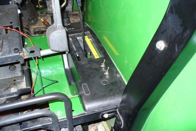

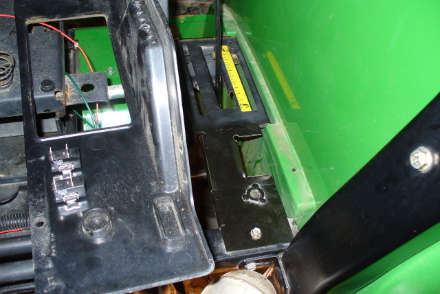

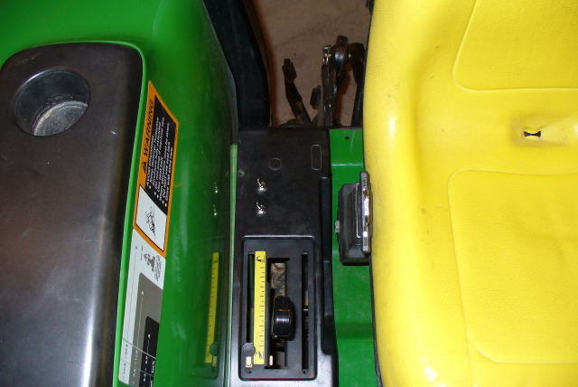

I had selected a spot on the plastic panel behind the 3PT hitch control to mount the switches. I measured carefully, installed my switches in the panel (which I had removed), then discovered that I hadn't done enough exploration. There is a steel plate under that plastic panel. It doesn't sit close enough to the plastic piece to mount the switches through both. In the first photo, you can see my solution to the problem. I drilled holes in the corners, made a couple of cuts, and folded a chunk of the panel to make a rectangular opening. This steel panel doesn't really carry any load, so I think it's still strong enough.
The third photo shows the location of the switches. These are heavy duty, supposedly waterproof, toggle switches that I ordered from Vetco. With shipping, 3 of them cost more than my lights did. I am pleased with the switch location. My hand drops easily to where they are and I can use them by feel.

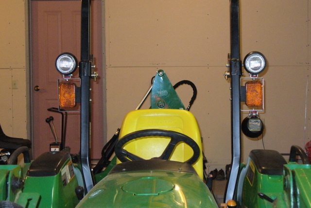

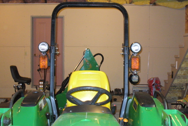

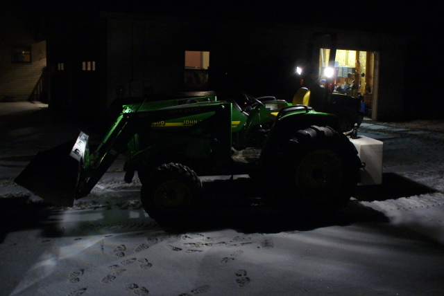

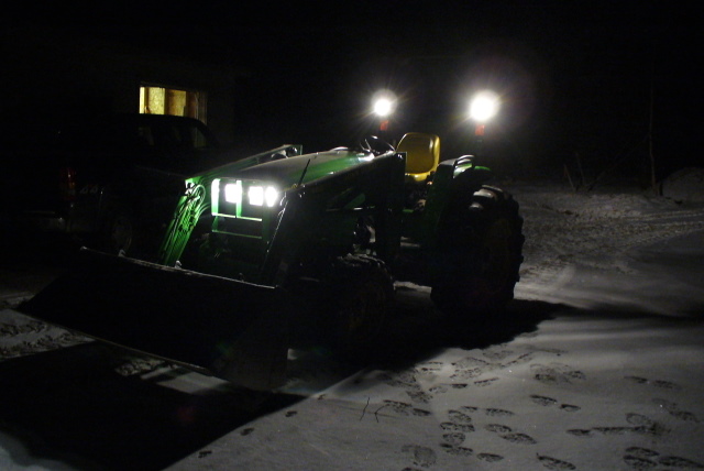

The 4th and 5th photos show the finished light installation. Note the flexible conduit to protect the wires. I need to get some Liquid Rubber, or something similar, to seal where the wire exits from the top side (as mounted) of the rear-facing lamp. While at it, I will seal all of them.

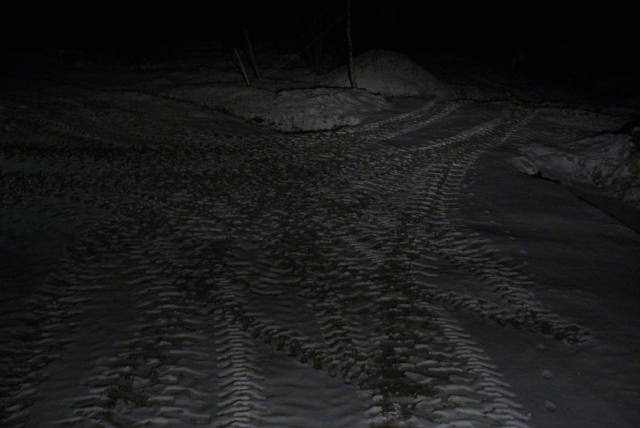

Photos 6, 7 and 8 were taken outdoors without using the flash on the camera. They don't really do justice to how much the added lights brighten up the sides and the rear. Also, the operator's station is well illuminated. I think they will make the tractor more visible to oncoming traffic when I am clearing the intersection of my driveway with the road.:)
The last photo is the view to the rear from the driver's seat. The photo looks a bit dark, but without the rear light, you would see nothing but blackness. Again, the camera did not do it justice. You really can see back there quite well.

The switches were claimed to be waterproof. They have what appears to be a nylon ball at the base of the toggle. I keep the tractor indoors, except when I am using it. I think I won't bother with rubbers for them.

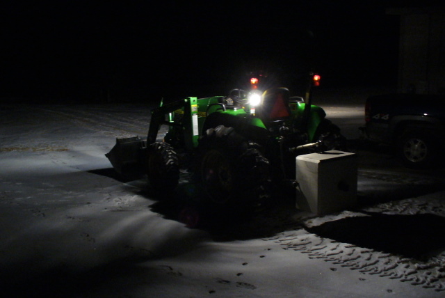

I gave my work lights a good test tonight. I did a quick job of snow plowing before dark, then my wife and I went to a party. After we got home, I finished the plowing with the lights. They worked great!:thumbsup: I can see to the sides, my operator station is lit up, I can see to the rear. I can see as much of the bucket and the bucket roll indicator as I can in daylight. I can see well where my front wheels are, which helps as I run them up to the edge of the ditch.
If you snowplow in the dark without worklights, you would really appreciate the difference after you add them.
