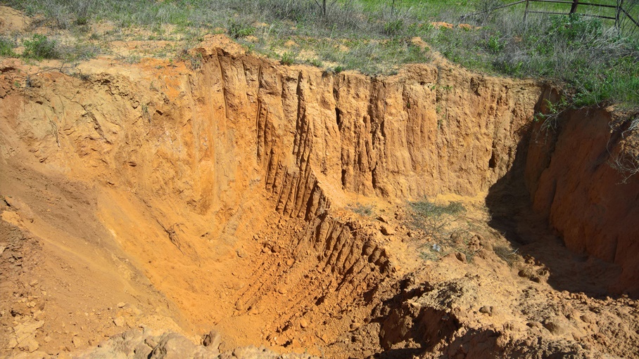

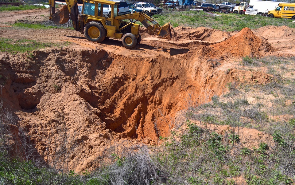

Yes there will be a 6 to 8 inch slab eventually but it may be a couple years in coming and may have to be poured in sections. There is no budget set aside for the $20K it will require for a slab at this time. I have money set aside for purchase of steel to build the doors and complete the walls once I get to that point, but have give serious thoughts to use a large part of that to rent a machine that would mine and move the fill faster than I can with my backhoe. However since I have the backhoe to do the job with spending money for a large loader like a 977 cat just so I can complete the fill faster seems like possibly money wasted

A scraper would work had I done this in strip mining fashion instead of pit.
tippers or site dumpers work well but would need to be self loading

Since I am having to mine the material then pile it up before loading it in the loader bucket a site dumper would only do much good if it were a large one like 3 yards or so then I could mine and fill it at the same time then go dump and return.
I could use a straight tandem dump truck but it is never good to have both the backhoe and a dump truck backed up close to a pit. If I had my Kubota KH191 excavator running this could be solved as I would have full rotational swing for mining the pit then swinging around 180° to dump the bucket directly in the dump truck.
If I were to get something like a tracked loader I would turn the pit into a strip mine or a mid sized rubber tire loader such as a John Deere 644 with a toothed 5 yard bucket I could make short work of the project. Probably be able to mine and transport a couple hundred cubic yards in a single day

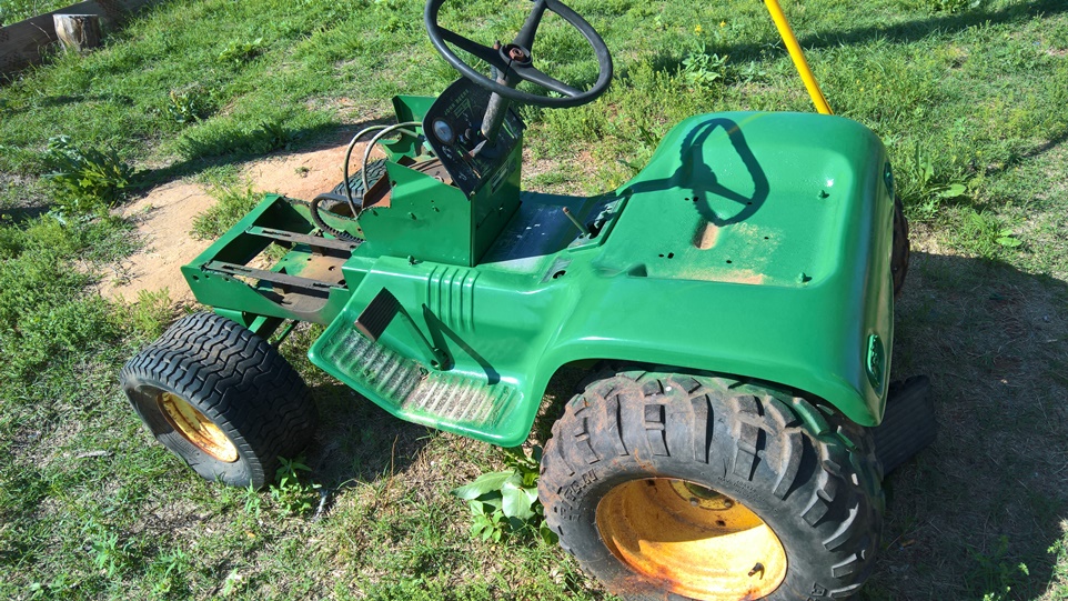

or maybe get this little guy running with its front mounted bale d and spend the next 10 years moving dirt

I also have a 23 hp diesel zero turn mower without a deck that I could get running and make a pair of tracks for it then turn it into a tracked skid steer by making a loader for it but that was a project that I have been putting off
The sand out here between where I have the pit and the building would mean any type of vehicle other than a tractor type vehicle would require me to pad the trail into a harder more stable surface just more mining is all that would mean
