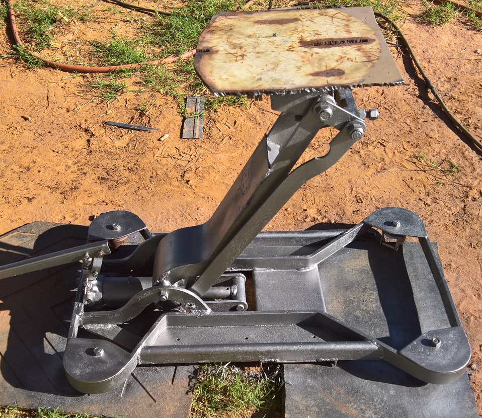

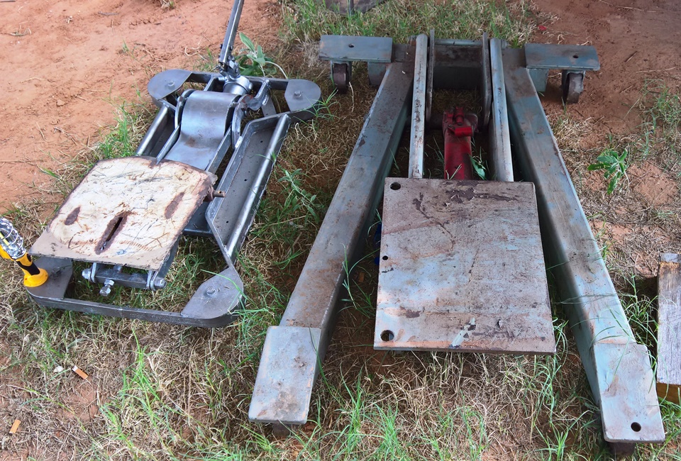

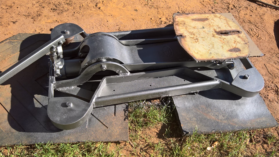

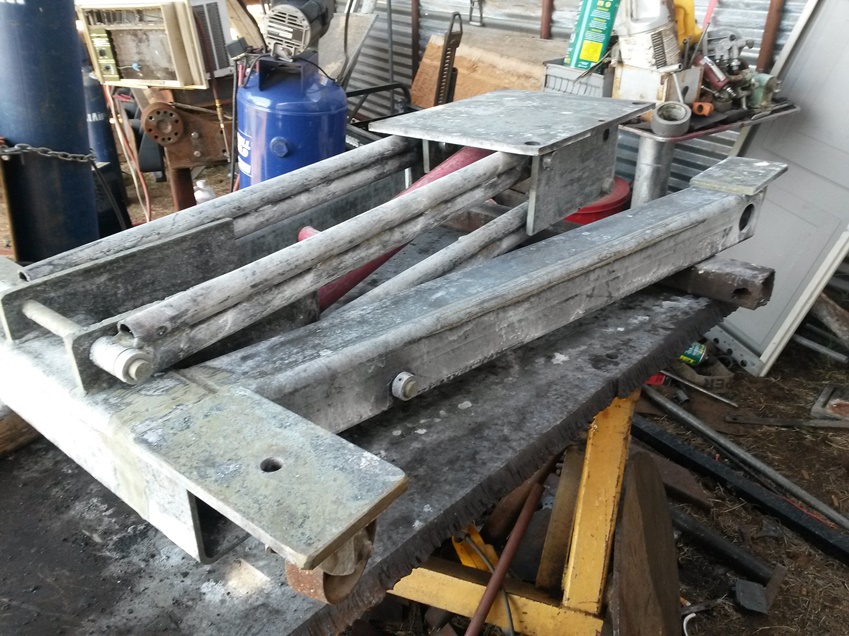

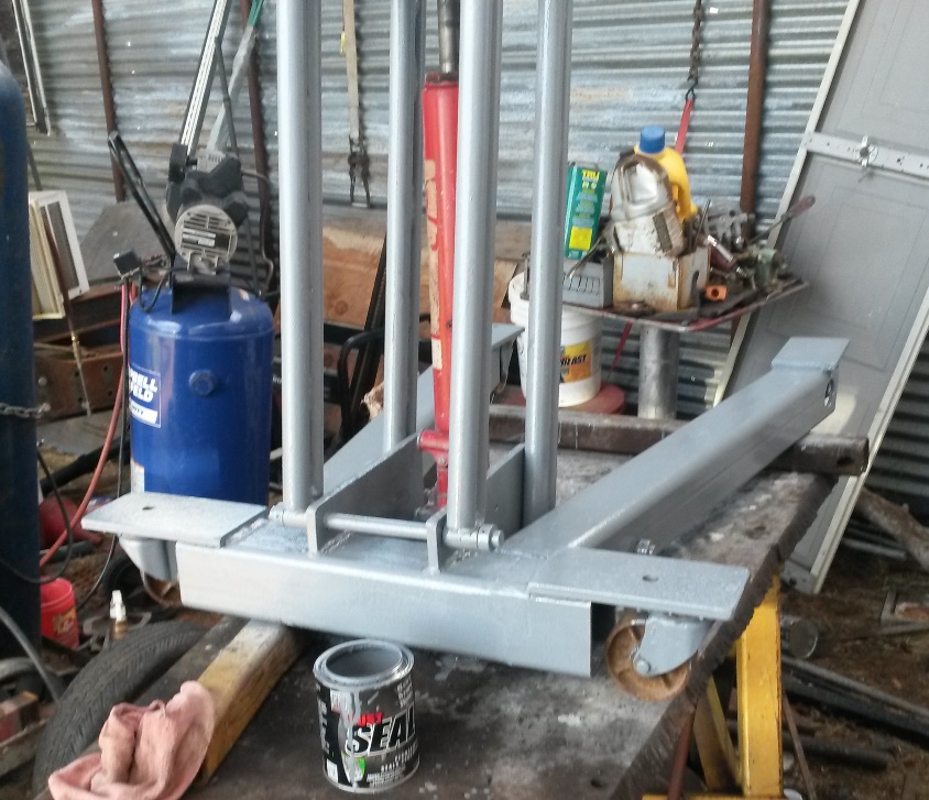

Thanks guys How about as couple of transmission jacks one is Identical and possibly may even be the one my dad bought new in 1965 that I changed my first transmission with in 68. I never knew what happened to all of his tools as I left home in 70 then joined the Army in 71 I found the Blackhawk transmission jack in a pawn shop near the town where I grew up and bought it sometime around 1986. Like I said it is identical to the one Pop had except someone had welded a plate on it.
I couple of weeks ago I rebuilt the bottle jack so I could use it to re install a Dodge pickup transmission I had overhauled.
I had removed the transmission with the jack I had made for pulling truck transmissions but it was way too large to manuver under a wimpy little 3/4 ton pickup
here is the one I made 3 years ago then the Blackhawk one will raise 4000lbs the other 750 lbs
Now the blackhawk
side by side

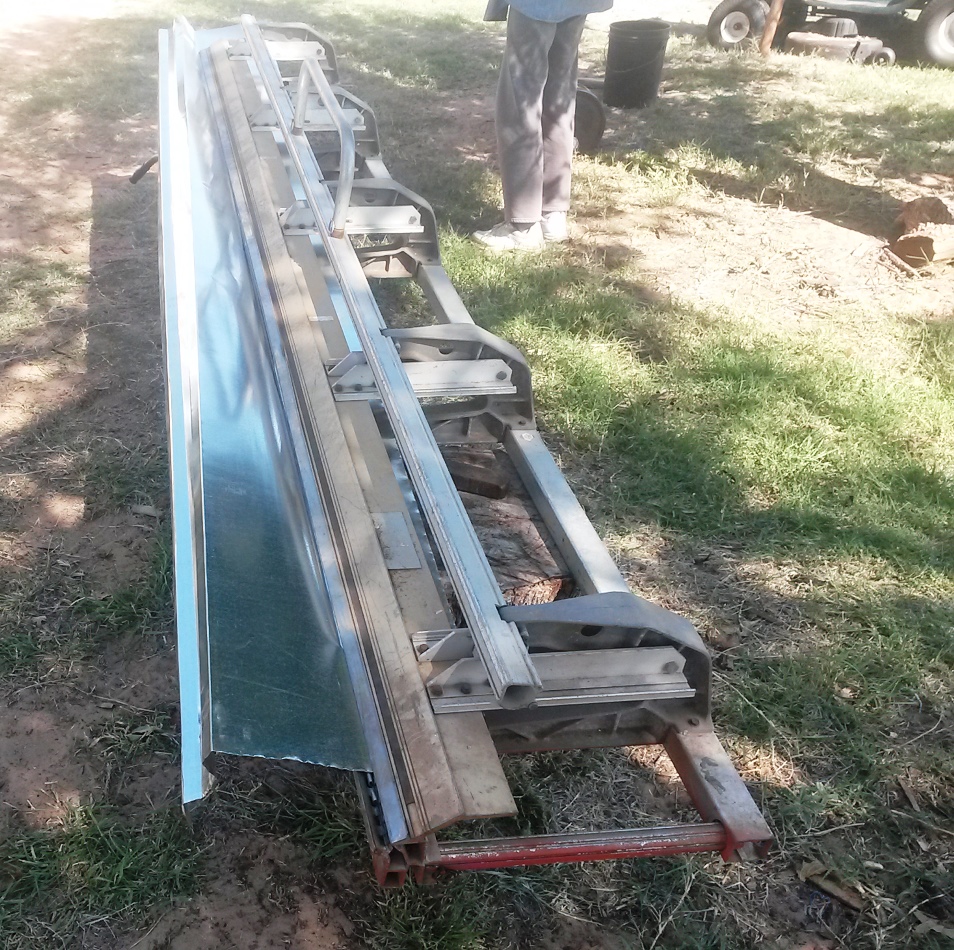

the folding break I made
Kind of but not quite patterened after my gutter and trim break

I didn't fully explain the usage of the KBS Rust blast the product contains the highest percentage of phosphoric acid allowed by law. plus a formulation of other components what this does is the rust blast eats the rust or in the case of steel or iron, the iron oxide there is also a low content of zinc in the solution as the rust blast dissolves the rust it leaves the bare metal alone. yeah it sounds like wizardry I know there are other products on the market that use phosphoric acid in combination with other chemicals to convert the rust into a hard scale like surface such as OSPHO.
However none function quite the same as the rust blast, which is primarily used as a treatment to prepare things for painting the zinc becomes a very thin layer of zinc oxide and will is left on the parts aid in preventing them from rusting again for a very long time. You can leave this layer on or buff it off before painting. If you look at the pictures of the transmission jack I made the first one looks like there is a chalky substance on the steel this is the left over result of the rust blast then I painted it with KBS rust seal paint a direct to metal coating that has an 85% UV stabilization if my jack was going to be left out in the sunshine for months or years I would apply 2 coats of KBS top coat over it.

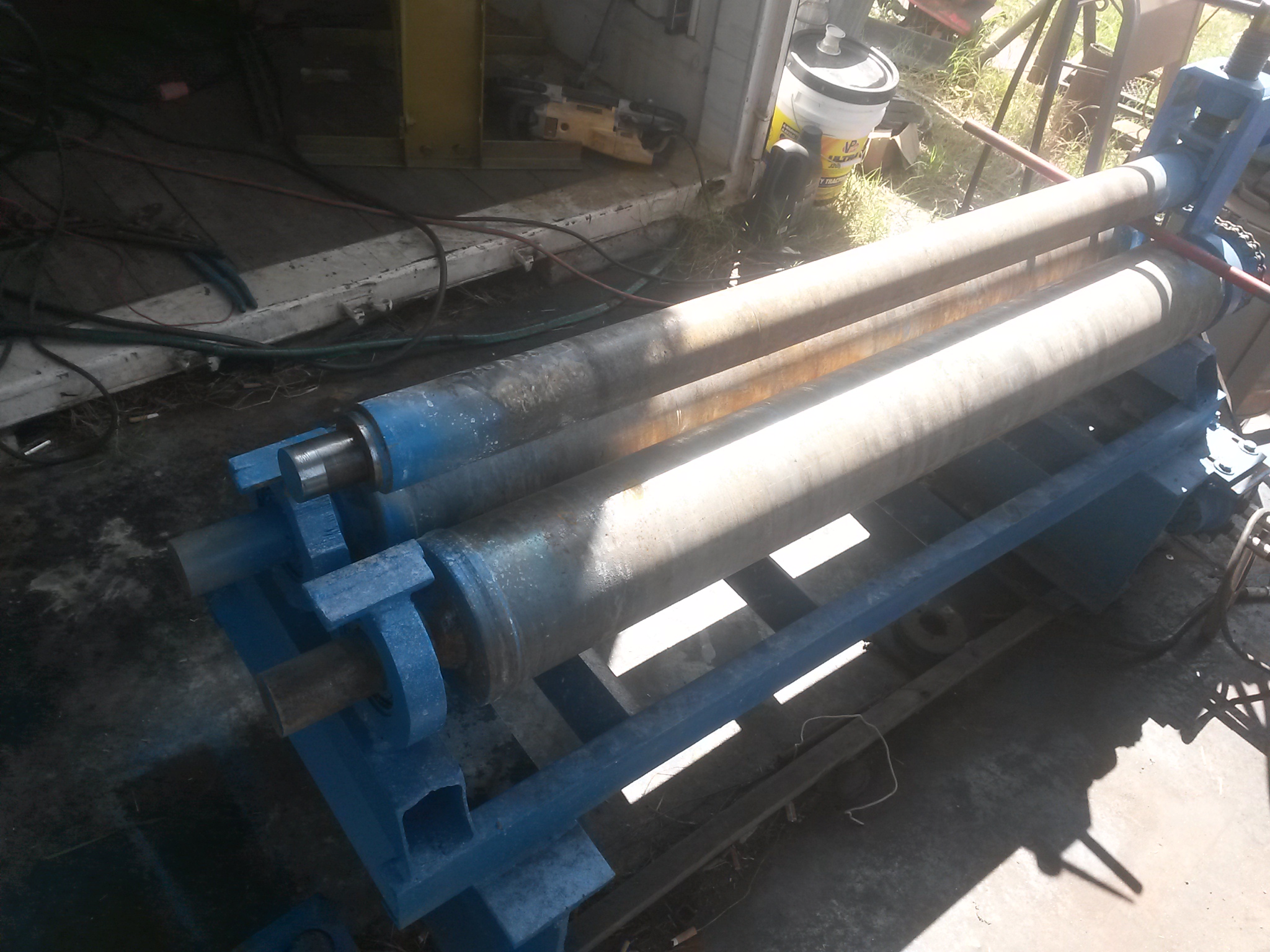

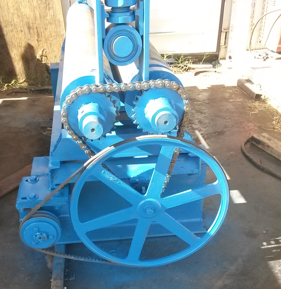

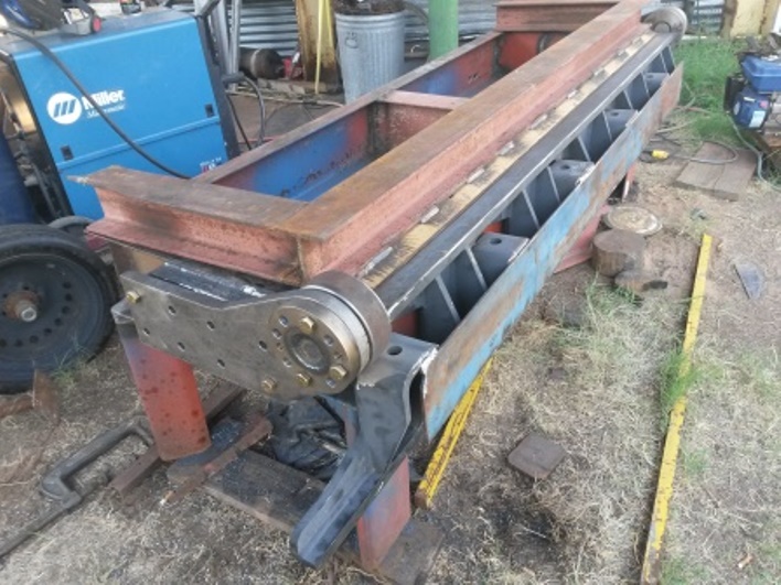

How wide will your slip roller roll?
hugs, Brandi

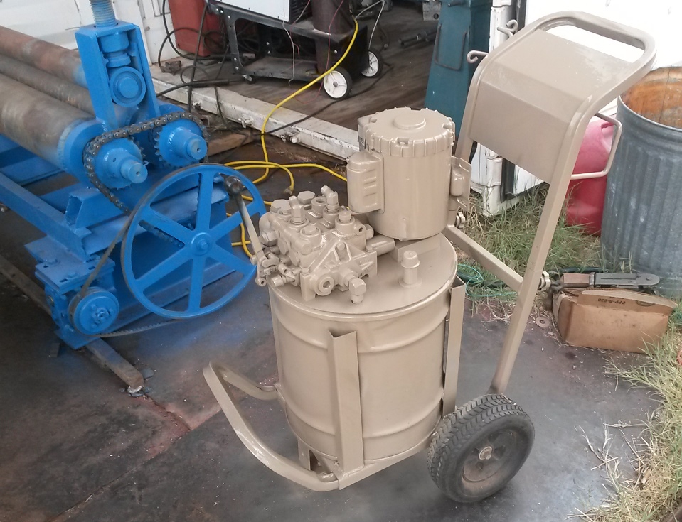

I can roll 53 inches wide down as small as 5 inches in diameter up to 3/16" thick of mild steel but I need to add more reduction gearing to the hydraulic motor because without over pressuring the adjustment on the relief valve to 4500 PSI the motor stalls out on the thicker material at full width. I rolled 3 40" long air tanks out of 10 ga to 8" with no problems but it runs a little fast when trying to work it by myself
This is the power unit I made for it
   / My work shop build in progress #180
Does the roller start and stop with a foot switch? Dang Frank, powered and geared, that thing must be a beast. Our work manual roller would only do 1/8th inch. I never tried to max out the power roller.
hugs, Brandi
