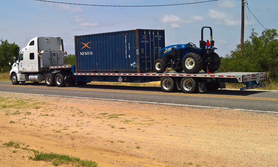

I have a 20 ft container inbound which will arrive either Sunday or Monday. which was requested to be loaded on the rear of the trailer but managed to be loaded in front of another load So not I have to figure out how I am going to off load the thing without a forklift large enough to pick it up. and off load it from the side.

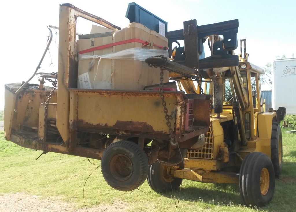

Oh I have forks
I made the carriage for the forks several years ago

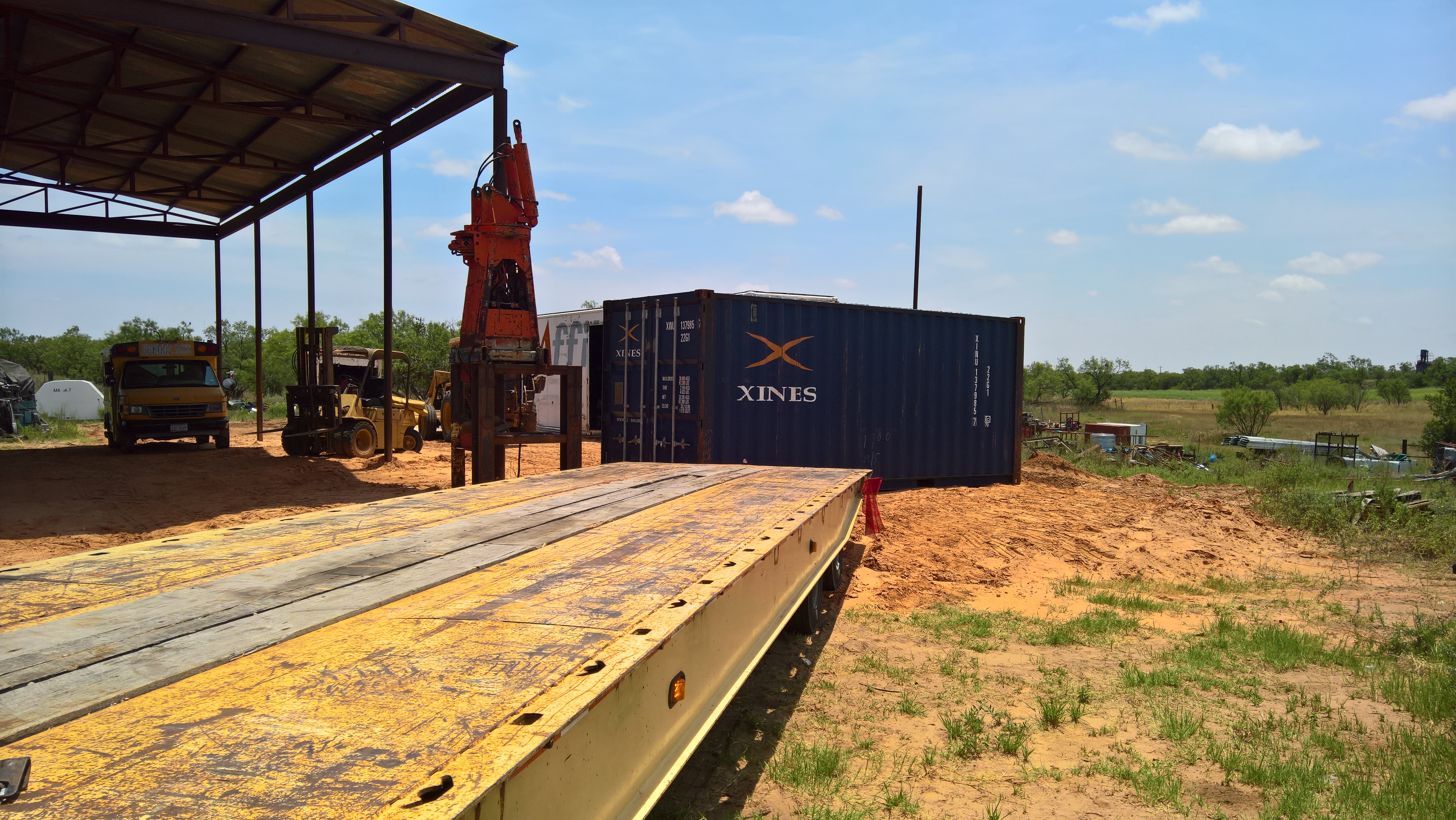

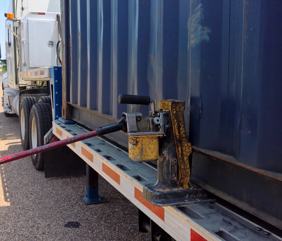

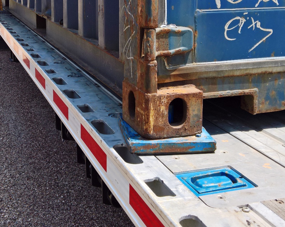

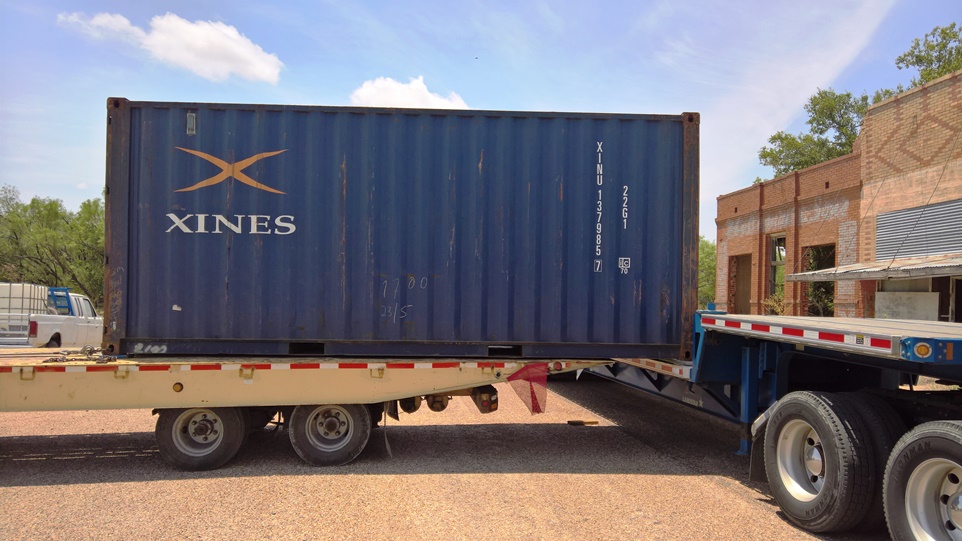

My guy arrived around 9:30 the driver hauling the container got here at z10:00 by 10.30 the driver was on his way He had to wait about 10 minutes after we got the container off his trailer to complete his 30 minute break. by 10:45 the container was on the ground in place with in a couple of inches of where I had planned on putting it.
The driver never touched a thing My guy moved the tractor back out of the way while I used my toe jack to lift the container and place our sliding shoes under it Then Bob backed his trailer up to the side of th driver's trailer we winched the container off sideways onto Bob's trailer while I had the driver back up as the container turned.
The driver asked Bob how many hundreds or thousands of times had we done this before, he said it takes the companies with the big forklifts or cranes longer to unload then we took. the new uploader reversed the order of the pictures
