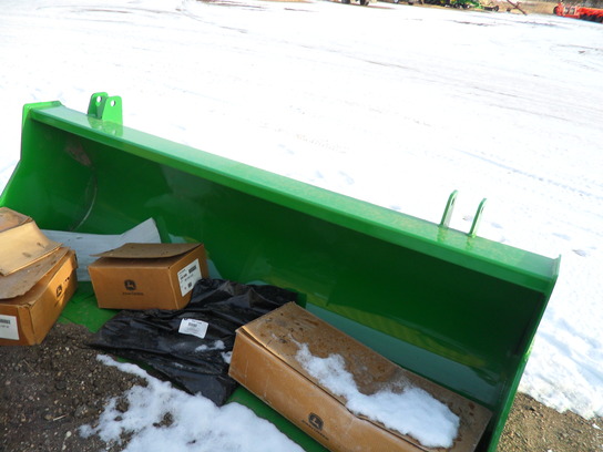

The only HD 85" bucket I see that can be ordered with the H260 loader is the one that comes with the grapple attachment brackets. I don't want that since I got a separate grapple. Would like to see a picture of one to determine what those brackets look like.

Brackets for grapple are four tabs (per side) with one hole for a cross bolt in each tab. Two tabs top, two tabs bottom per side. Look in JD parts and they show a back view of the bucket. Picture is front view and only shows top tabs.

Btw, thanks for the pic of the 85" bucket. Will discuss with dealer.
